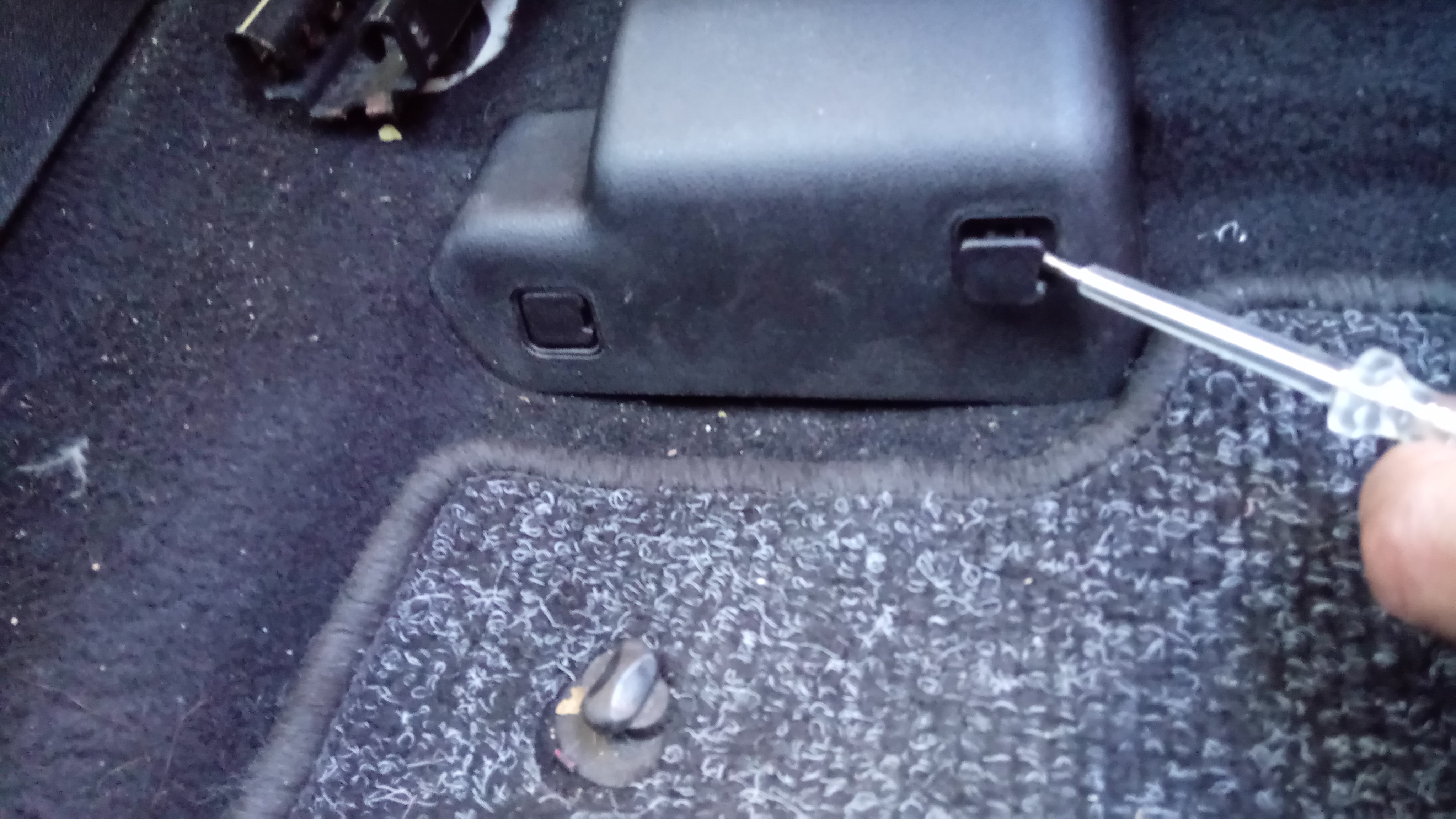

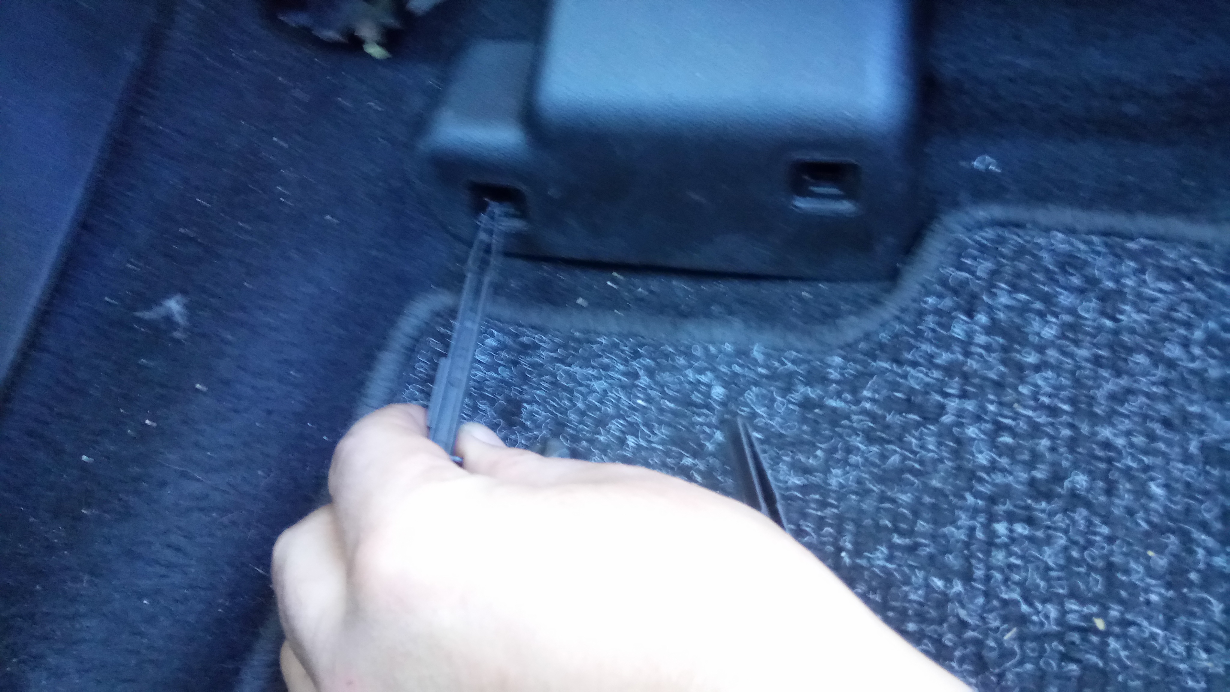

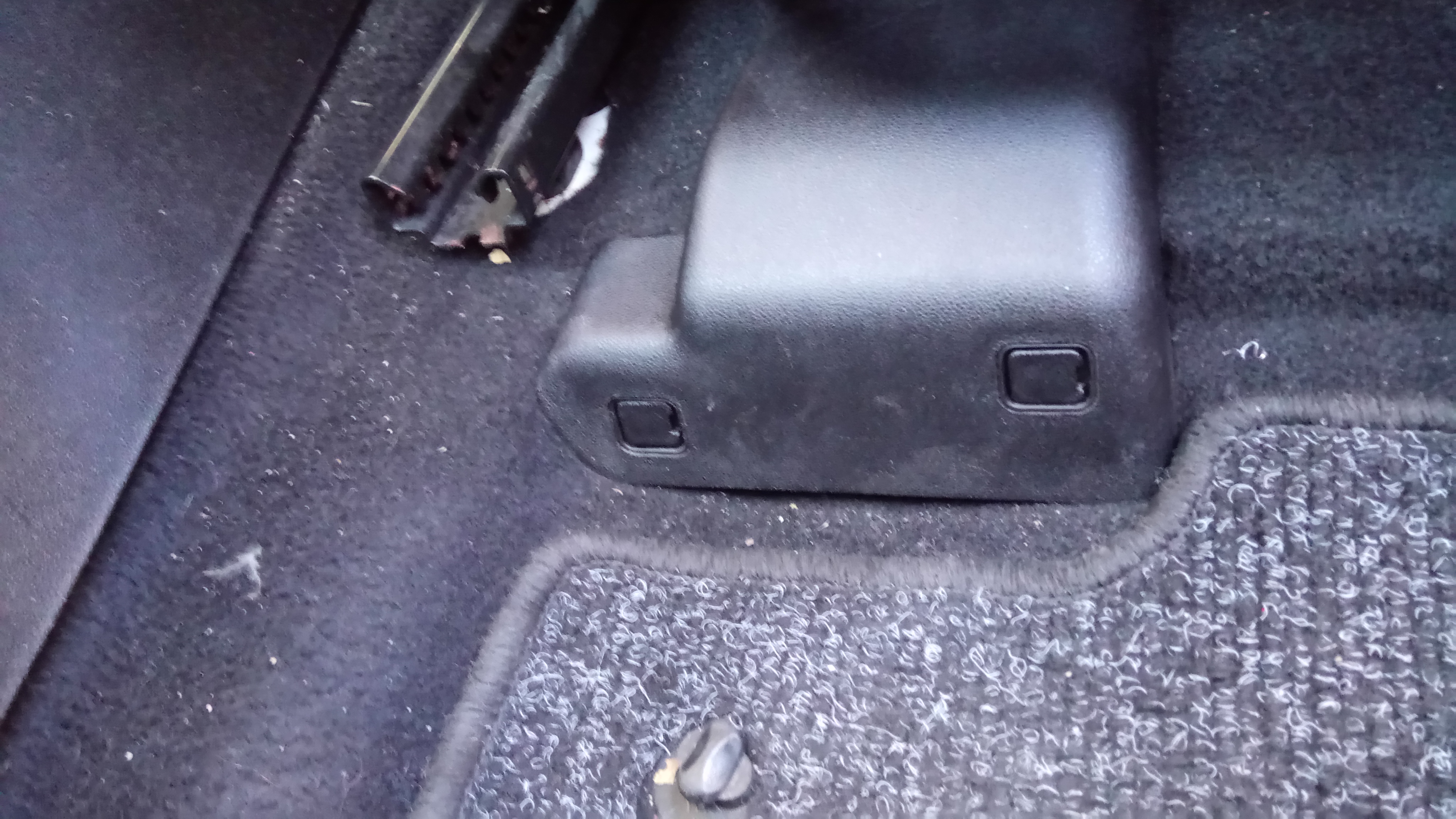

First locate the plug-connector cover under front side to the seat.
use a small flat screwdriver to remove the 2 plug

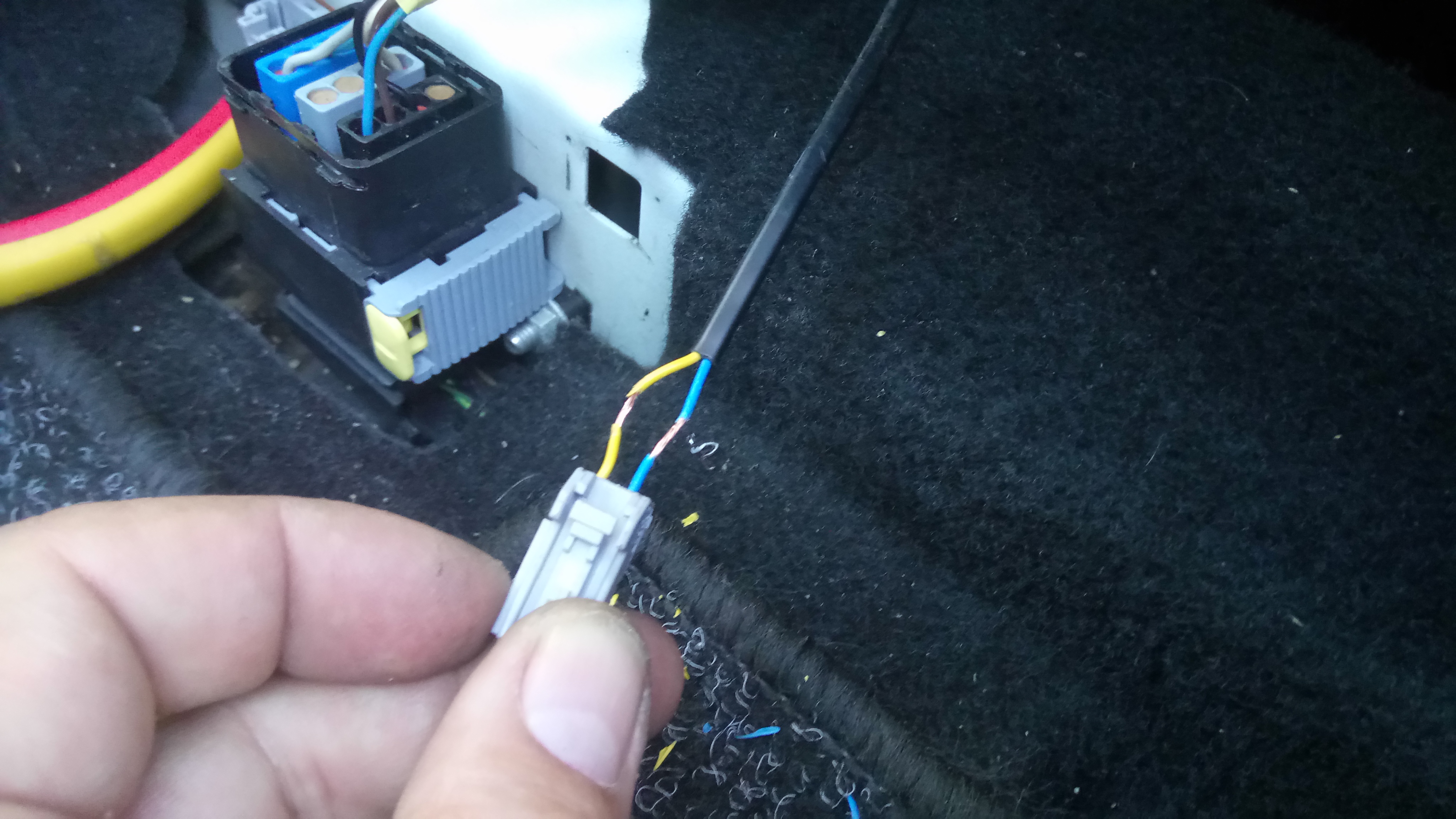

now as you see in photo there is a 2 pin connector,

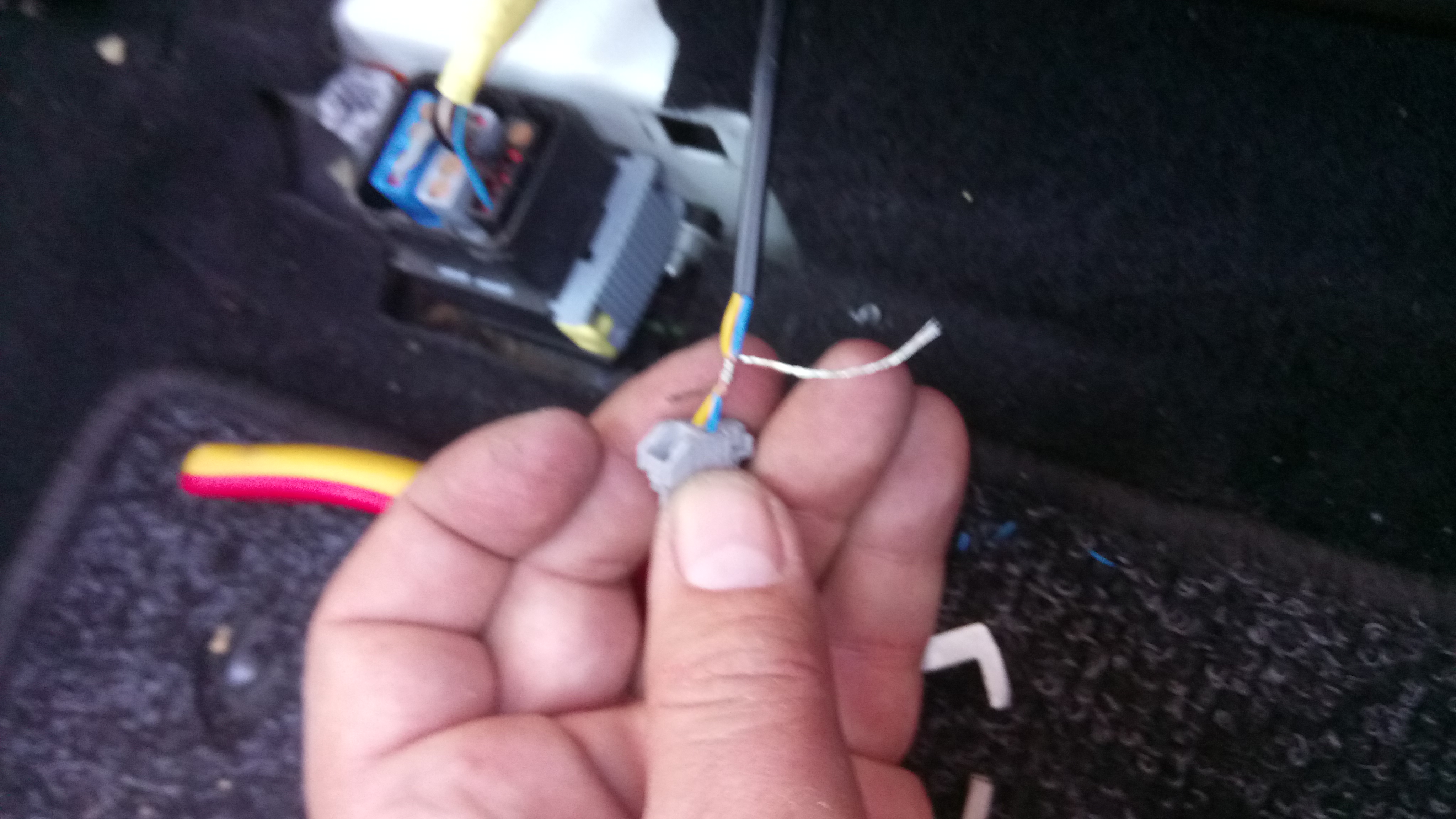

remove the insulation from the cables without cutting them.
Remove the insulation from another cable and wrap it around the two cables.
This will close the circuit and the car recognizes that the seat belt is in its position.
Insulate the 2 cables with tape and plug the connector back.
