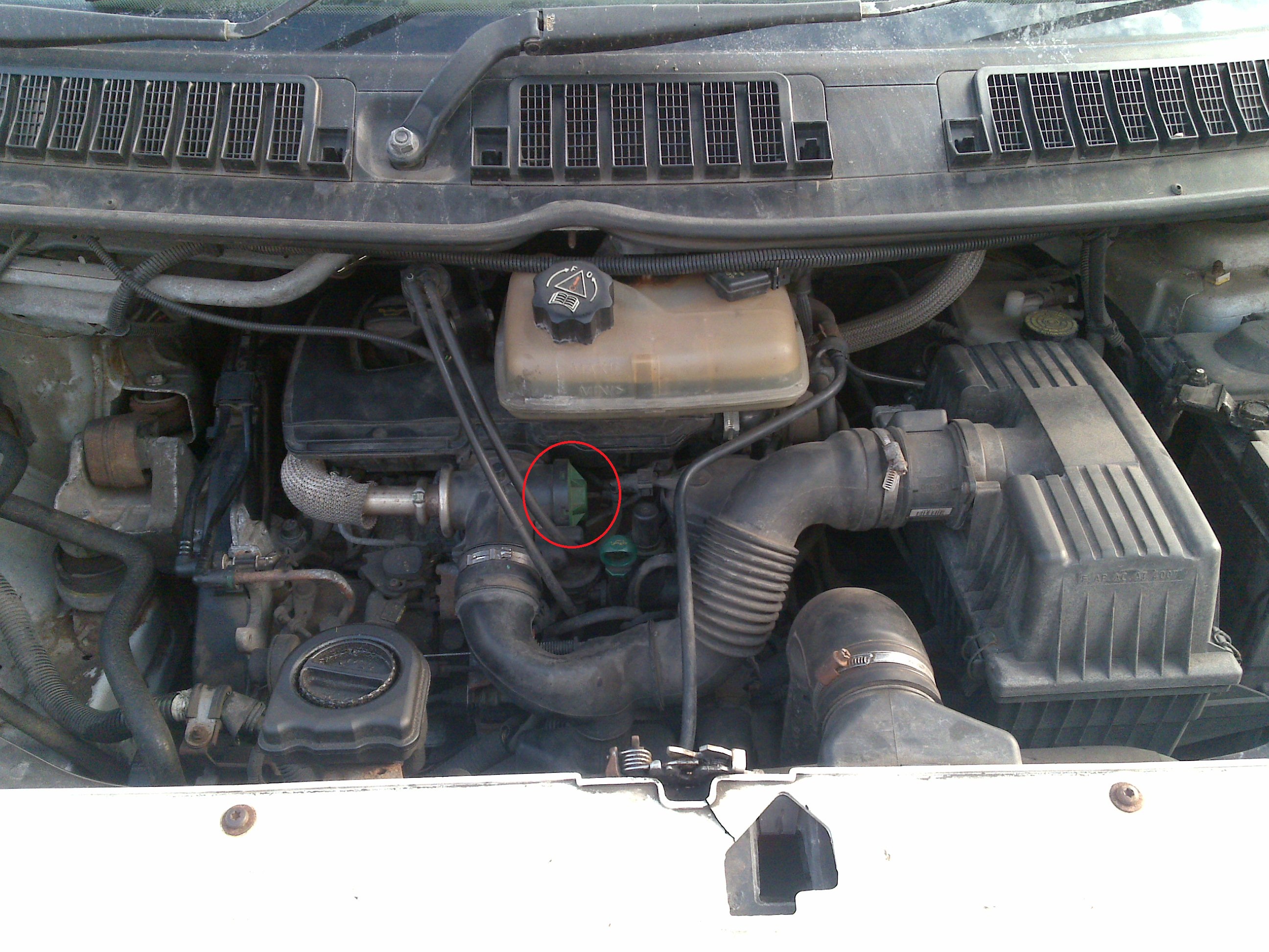

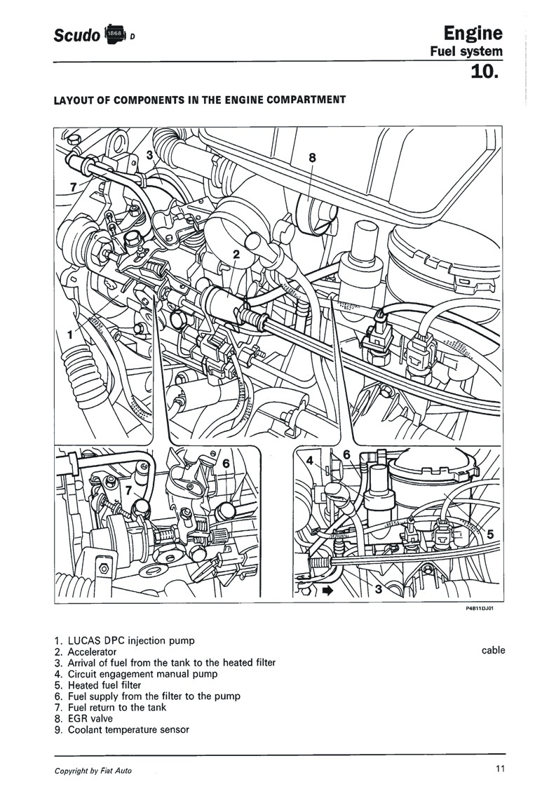

On the Scudo, the EGR valve is at the front with the pipe running from the rear inlet manifold
in here : -
depends on build date, picture is old shaped scudo while 'Bossman74' describes new style. Its bit awkward to get to at back but there are 3 types, one is worse than other 2.
had a look mine looks like one at back cheers
Hi T14086.
Yes, my Scudo is a 52 plate 1.9D non turbo.
The picture is from my Scudo and my description is from my Scudo i.e. old shape: -
I'm not sure if the 2.0JTD and my 1.9D are similar or not, just thought I'd post a pic of mine to see if they were similar.
