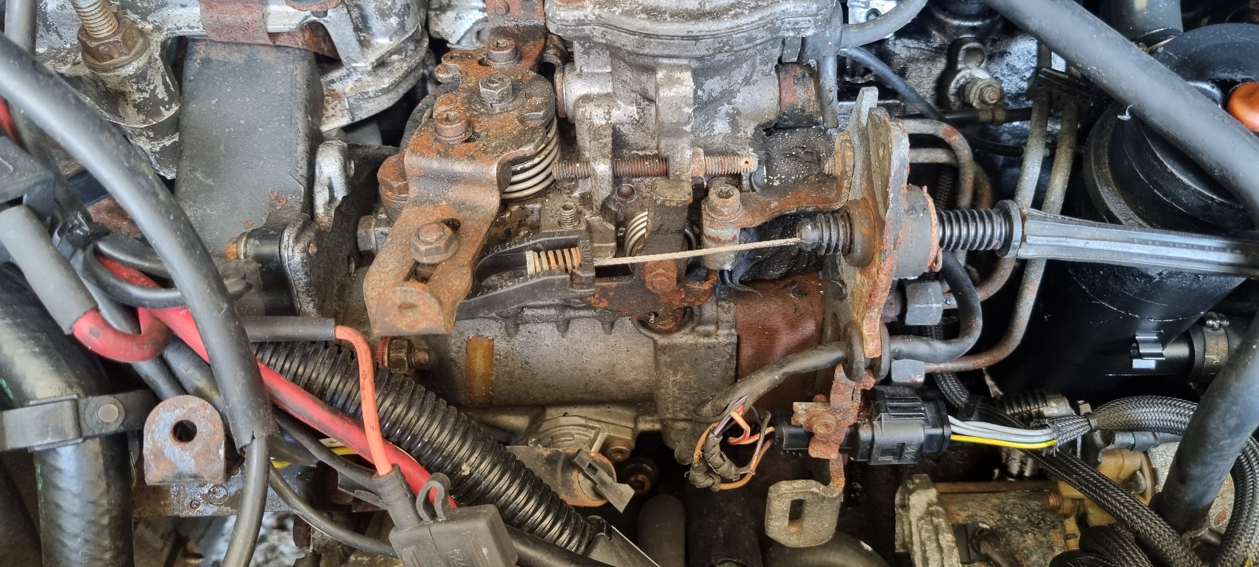

Im sorry I am not aware of where to find my engine number, but my engine looks similar to the one on the picture.
Battery has since it died in Swizerland, been disconnected.
Second image is the fuelpump on my 1.9TD engine.
There is 12.4 volt on the purple wire.
I have tried loosening the nuts on the injectors, and no fuel comes to show, even while cranking.
The keypad is unplugged, and the car has been running without it since I got it.

Sorry I cannot see a number I recognise on the chassis/vin plate re engine series.
I think it is a Peugeot engine possible of the XUD series possibly 1905cc maybe used in Peugeot 405 cars?
Re the injector pump, in your photo behind the accelerator wire is what looks like black sealant with several wires coming out to the junction plug and look like they have been rejoined by someone.
I suspect behind that black sealant is a solenoid with a single wire going to it.
If that is the case then normally if working and you apply 12 volts to it , then it should activate the fuel cut off solenoid on the Bosch injector pump allowing fuel to go into pump to start the engine after bleeding air out of course if required.
In the older versions they just had the single wire going to that solenoid, then to "anti theft" the vehicle they fitted a security shield over that end of the pump and had several wires going to it from an early form of "immobiliser", later vehicles with computers were much more sophisticated.
If you look at various photos on the internet of that type of pump you may see what I mean about the solenoid valve that stops the fuel, it is roughly just above the four fuel injector pipes coming from the injector pump.
If that is your injector pump in the second photo , then I think the dip stick to me points to it being a Peugeot engine.

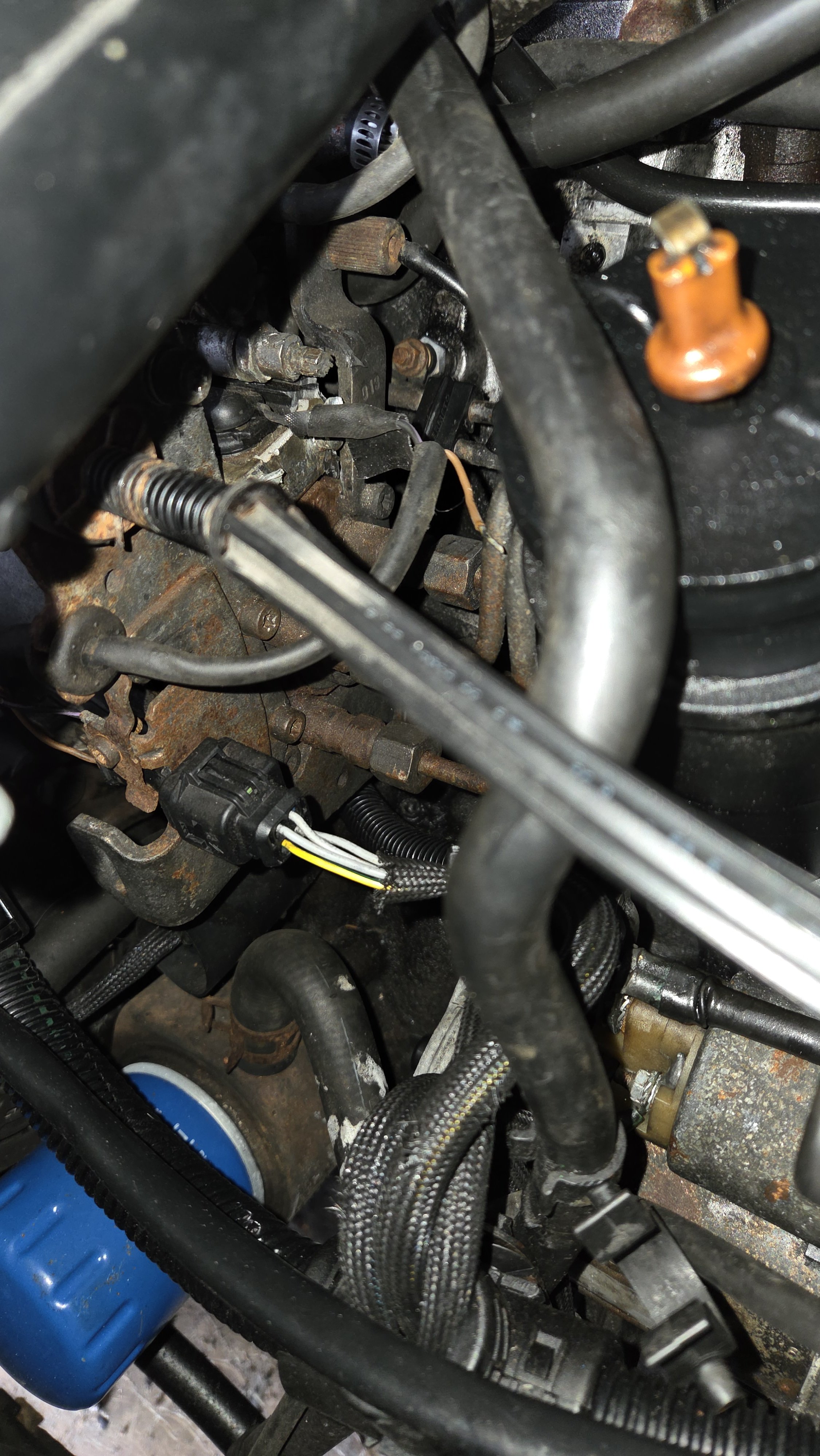

I have been tampering with those wires, in order to measure voltage.
No its not nicely done 🫣🫣🫣
There once were a sticker on the pump, ofc it fell off when I washed down the engine some 2 years ago, after I did replace the timingbelt.
It has been driving for more than 3000km (1900miles) after I replaced the timingbelt.
Ive read somewhere about this tamperproof pump, and its solenoid, on a peugeot forum- and no its totally gone in my memory where, or even how I found it.
But yes this engine is in several peugeots - from that time.
I have tried to find the engine number without any Luck, as it should be just behind the pump- visible from the front.
I have found a workshop manual, containing the wiring harness, but it doesnt say whats in the black box behind the pump, containing the stop solenoid.
Ill have another go tomorrow, and even see if I can find the page describing that pump.

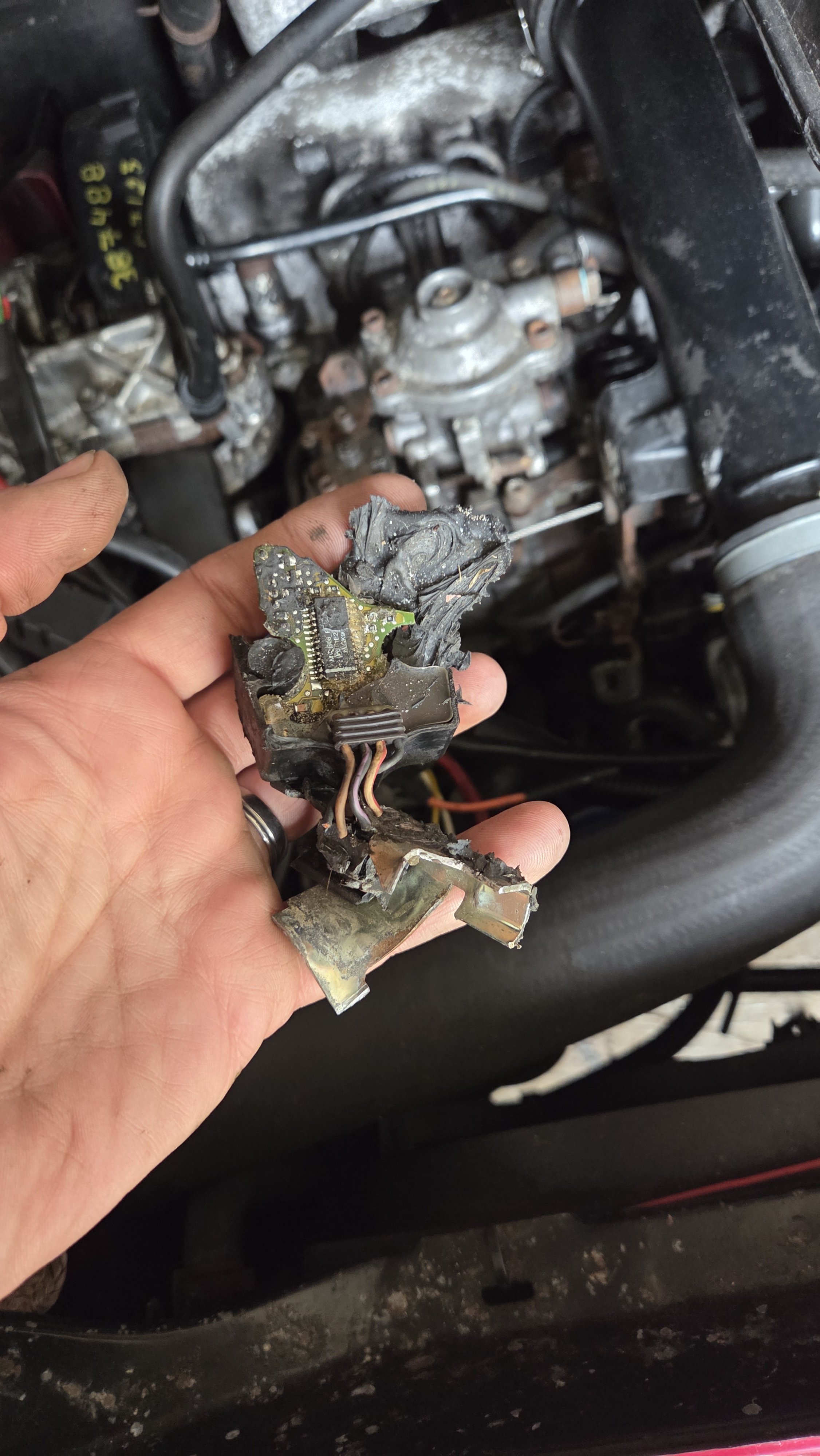

Hello again.
Been quite busy, with all kinds of stuff, including manking a MBT ready for display/ live firing in end june but...
I was there, in my engine bay, the unit was making me gray haired, so in the end, i decided- either I can fix it with a hammer and a chisel- or not.
about 20 minutes later- the electronic anti-theft device were seperated from the fuel pump - and I had acces to that solenoid.
Was it a neat job? no
Was it done nicely? Not yet- but its a process...
engine is now running- and thank you very much for your support. <3

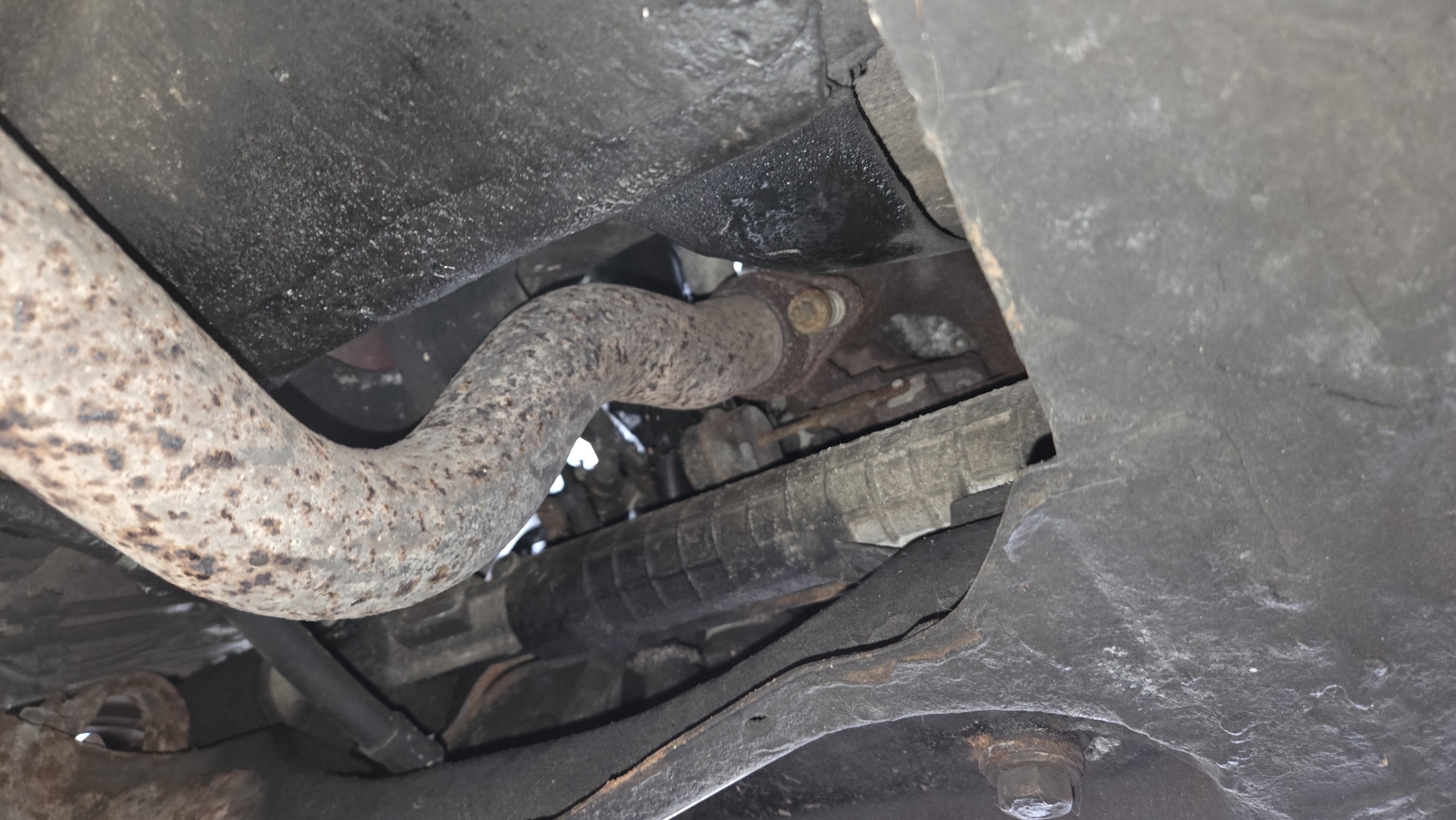

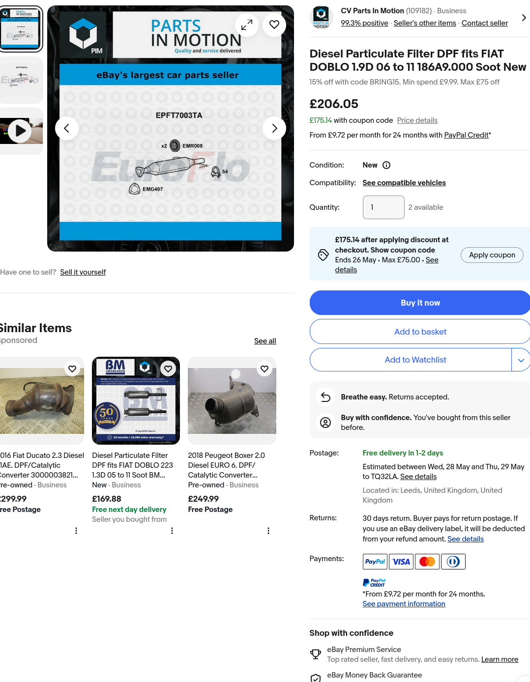

I have btw tried to find a DPF from the 05 Doblo 1.9JTD, and apparently its like it newer existed, or my search criteria is ****ed, can you somehow provide me with an OEM nuber, that might help me track down a run-through filter for my outdated engine ;)
As I see it, there is only 2 holes on the flange at the exhaust manifold- making me wonder- if the filter has to be mounted on that vertical stretch before the front silencer?

The 05 1.9 Fiat Doblo I had , had a "particle filter" which looked a bit like a catalyst in the down pipe but no DPF and no pipes or wiring connected to it. A bit like below in photo apparently to Euro 4 standards at the time. Mine was the Fiat 1.9 engine but yours looks more Peugeot based.
So injector pump now de immobilised and power straight to the solenoid to start engine, saves problems at a later date, but is a fiddle removing the security rubbish.
