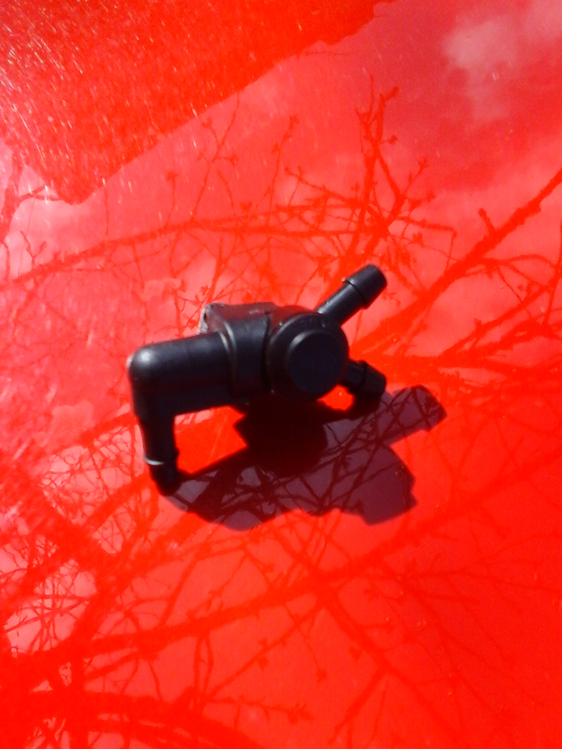

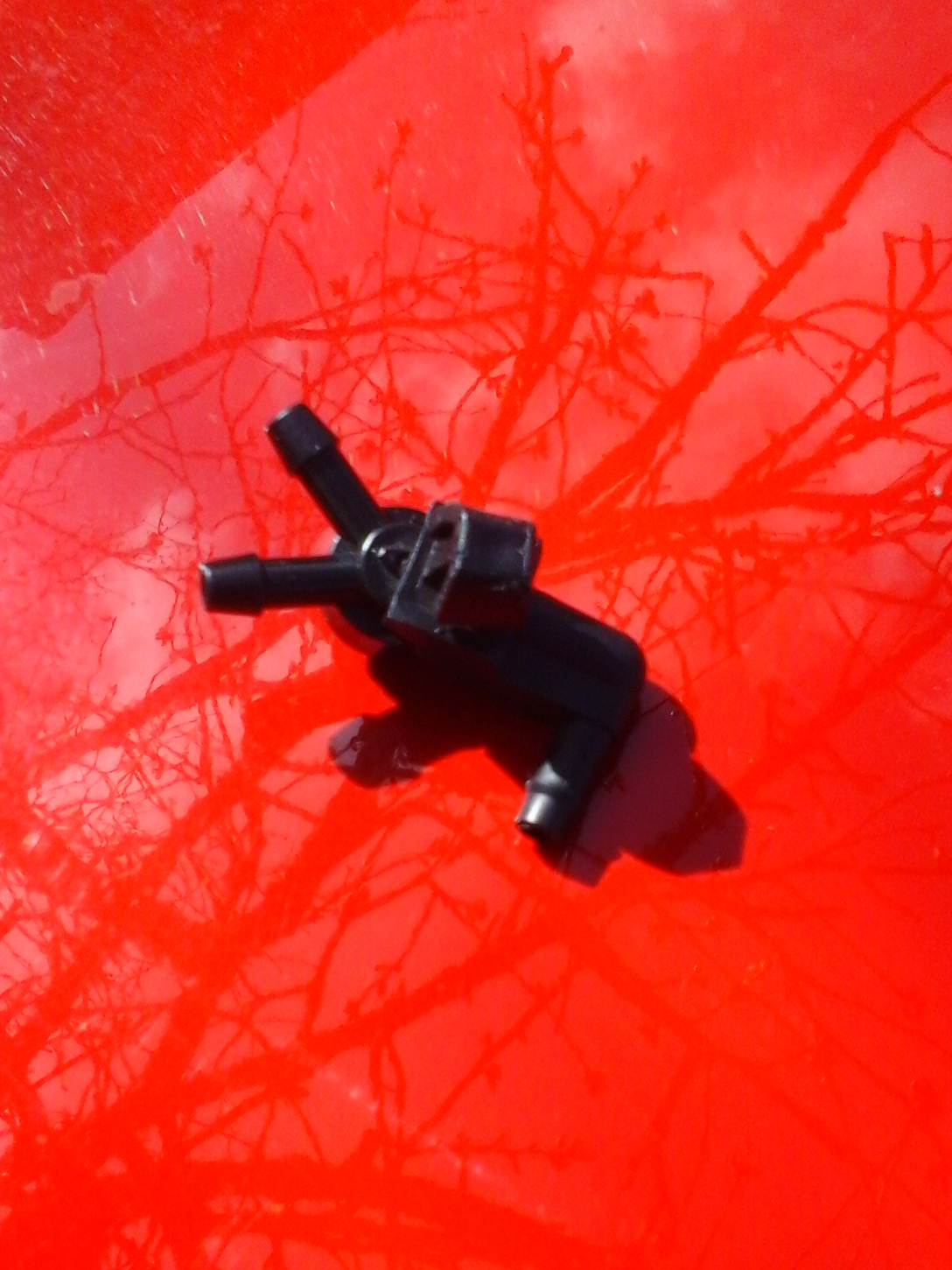

I got the hoses off and the main hose from the washer bottle gushes water like a good 'un, and the hoses to the jets have no blockages so the problem seems to be the Y shaped connector between them. I tried washing it out in warm water and there's a slight improvement in flow now (at least the water reaches the bottom of the screen) but probably not good enough for MOT.
Does anybody know the part number for the Y shaped connector? I can't find any numbers on it, just says "Sweden" on the bottom.

What we see there is actually two pieces. The elbow part is listed as a connection, 71732948, and the divider is listed as 'valve' 7667888.
With the pipe off, what you may see is plenty of flow, but not pressure. Might still be a failing pump.
To confirm which, can you by-pass the splitter, and connect the pump to either or both jets, and see if pressure is adequate.
Whilst the rear washer works, it has one hole, I think, so puts less restriction on the flow, and only has to allow water to dribble down the back, so working ok may mask a failing pump.
