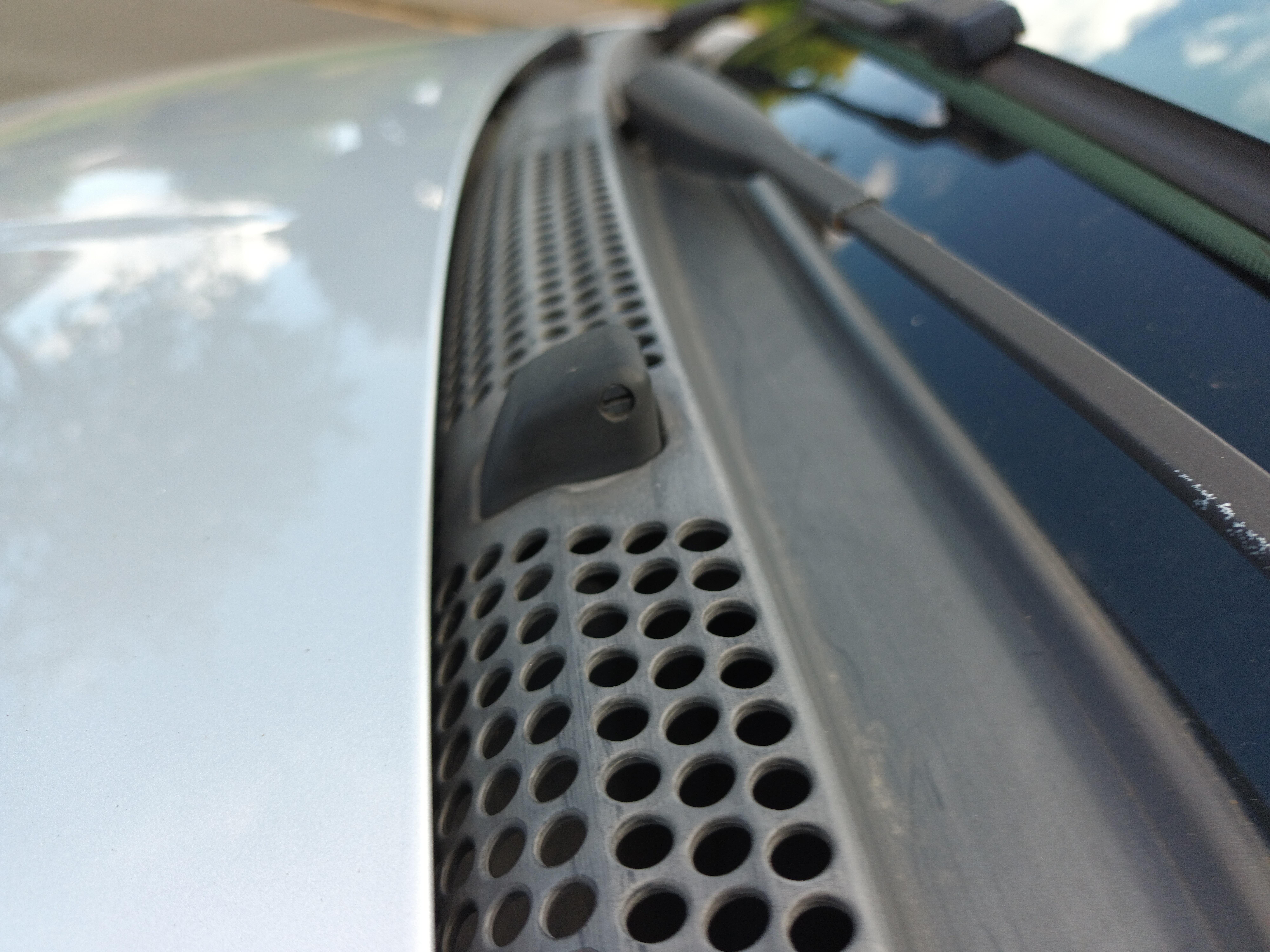

johncharles Member Parked in the garage Joined Aug 24, 2024 Messages 30 Points 88 Location Oundle Aug 24, 2024 #1 2014 500 Washer jets - How to adjust as they seem to be stuck - ideas? Model 500 Lounge Year 2014 Mileage 137000
John202020 Never straight forward? Parked in the garage Written a guide Joined Feb 5, 2016 Messages 7,089 Points 1,702 Location Tynemouth Aug 24, 2024 #2 You've tried a screwdriver in the slot on the side? Attachments 20240824_133437.jpg 10.4 MB · Views: 152 Upvote 0 Downvote
OP OP johncharles Member Parked in the garage Joined Aug 24, 2024 Messages 30 Points 88 Location Oundle Aug 24, 2024 #3 I didn't see that - I'll have a look thanks Upvote 0 Downvote
OP OP johncharles Member Parked in the garage Joined Aug 24, 2024 Messages 30 Points 88 Location Oundle Aug 24, 2024 #4 OMG, Thankyou so much - I've been using the usual way with a sewing needle. You are a STAR! Upvote 0 Downvote
