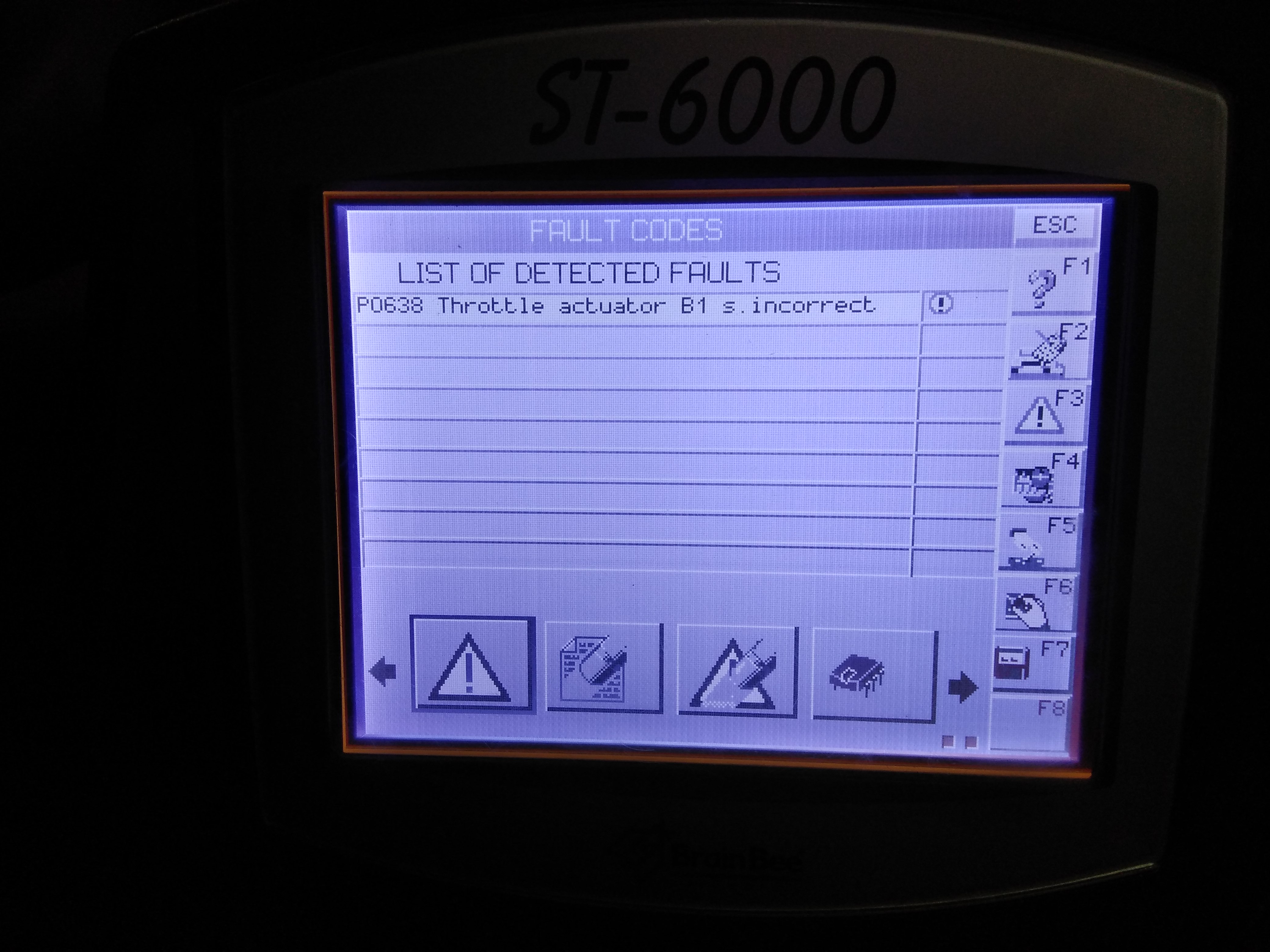

Hello everyone...This is pravin Mumbai India...I am in big trouble.. Today morning I took my Fiat punto 1.2 petrol car to garaj to change rear brake liner. But in the evening..Garaj boy told me that during trial engine check light displayed on dashbord. He check with scanner...And message was .. Throttle body not correct..plz help me out..Is there any wire ,or sensor to check for this..I have planned my travel on 24th..Plz help me...Garaj boy is completely blank..And planning to change Throttle body..But part is not available..
OK...But..One more I would like to mention hear.ther is no power...No pick up ..car can start..But can not move.
Guys this is error coad P0638 "TROTTAL ACTUATOR B1 S.INCORRECTE

What car and engine do you have? I've used the search function on here for P0638 and it seems the likely culprit is the throttle pedal position sensor, but whether you have one of those will depend on what car you have.

If its an active - that will be the 8v engine, based on UK spec, itll be throttle cable operated, so the only sensor will be on the throttle body only

Not the pedal position, It is the throttle actuator position. Unplug and clean the connectors from it and all others as far as you can follow the wires.
Oh, and my experience is that it is ok to drive if it has power as normal. The light will clear itself after a few driving periods if the fault does not happen. If it happens while driving you will notice a loss of power. Pretty sure you could drive it and see how bad it is it will get you home.
