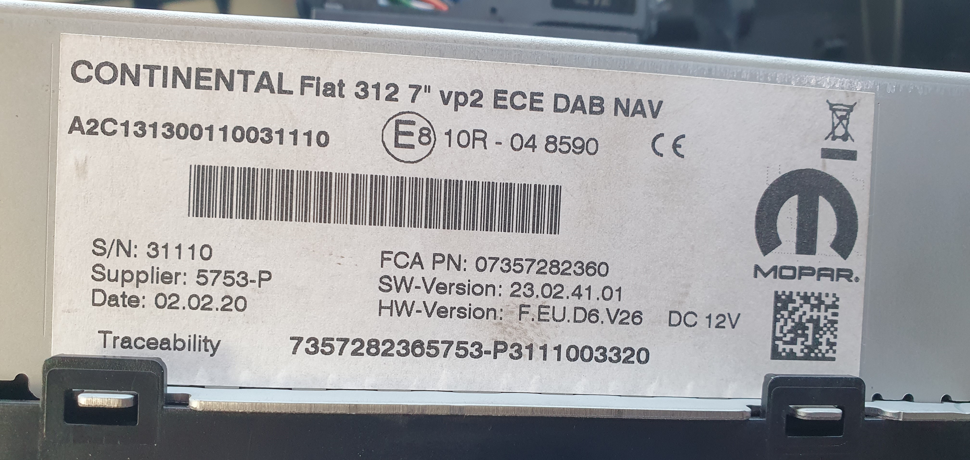

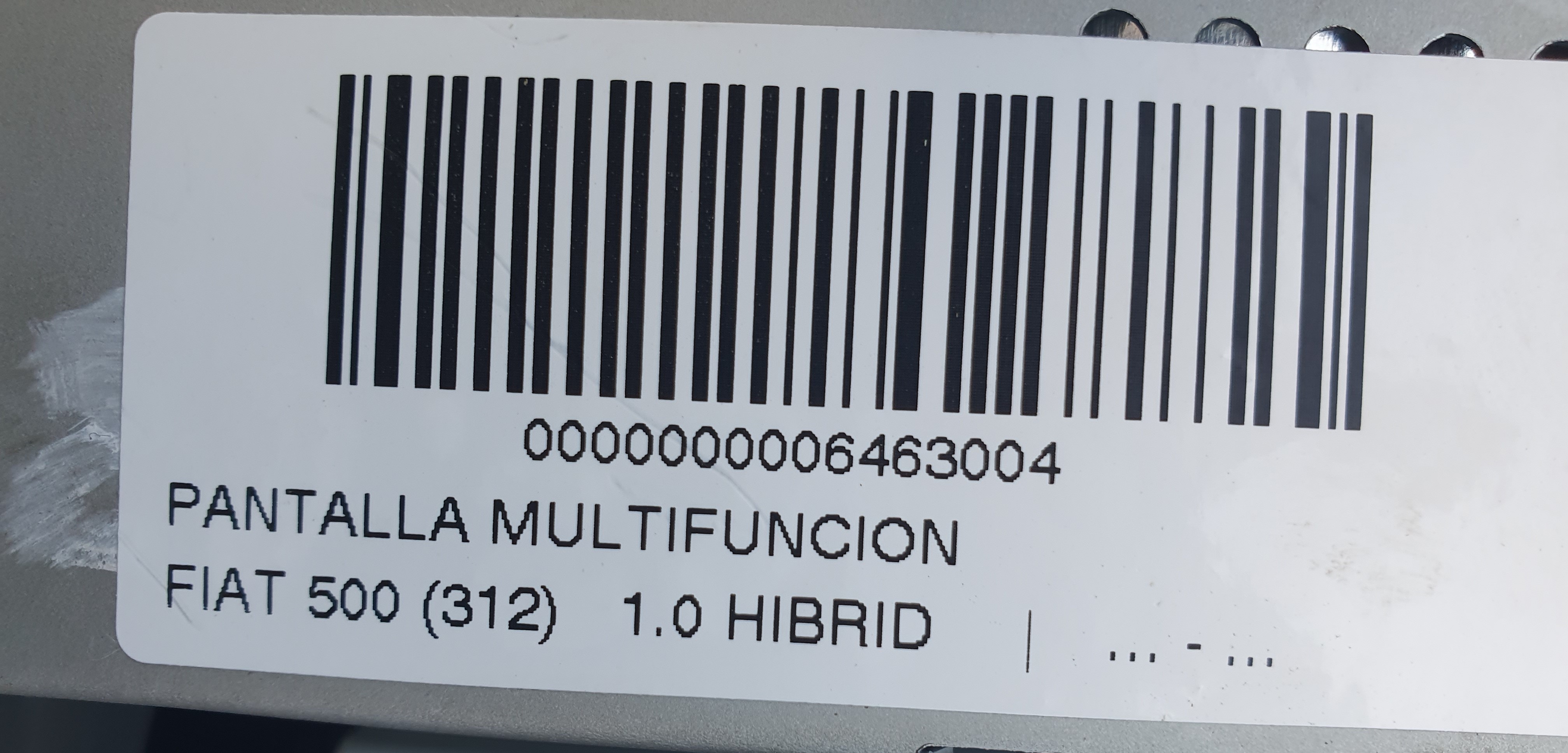

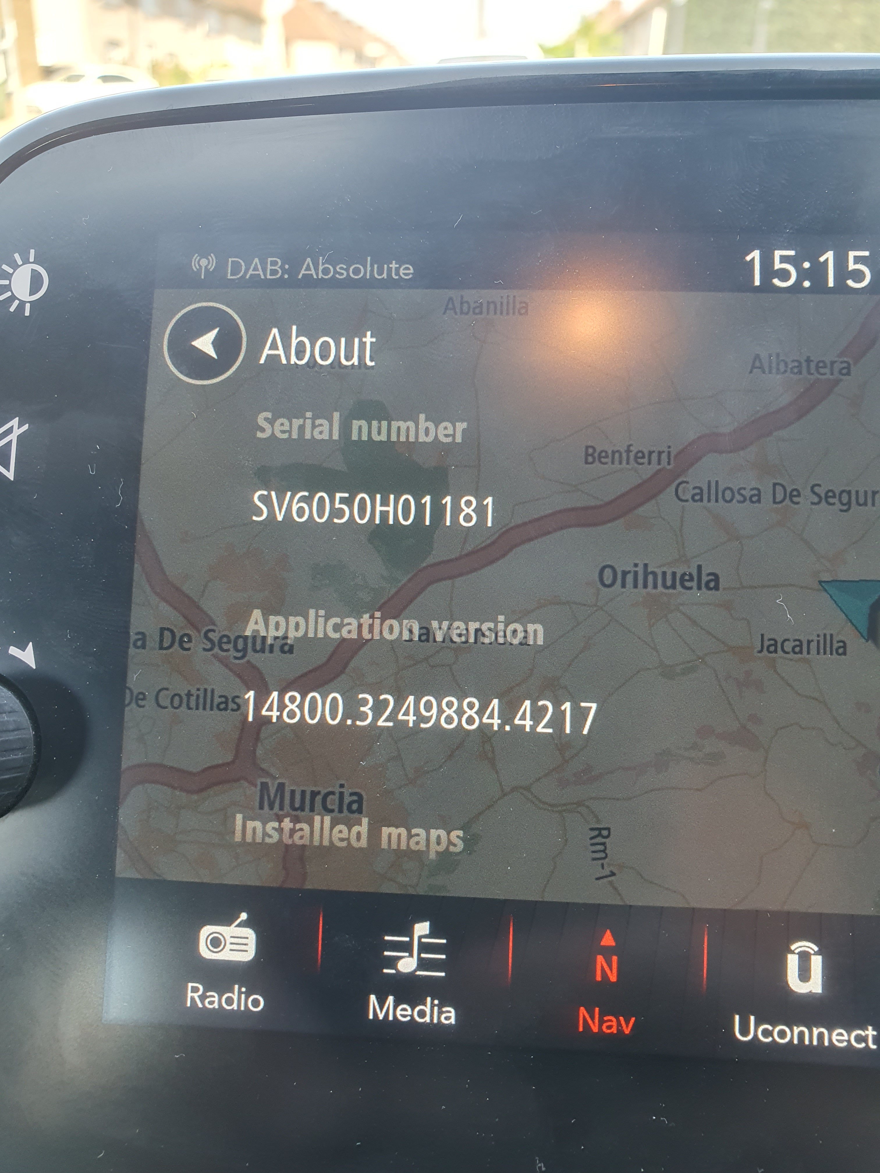

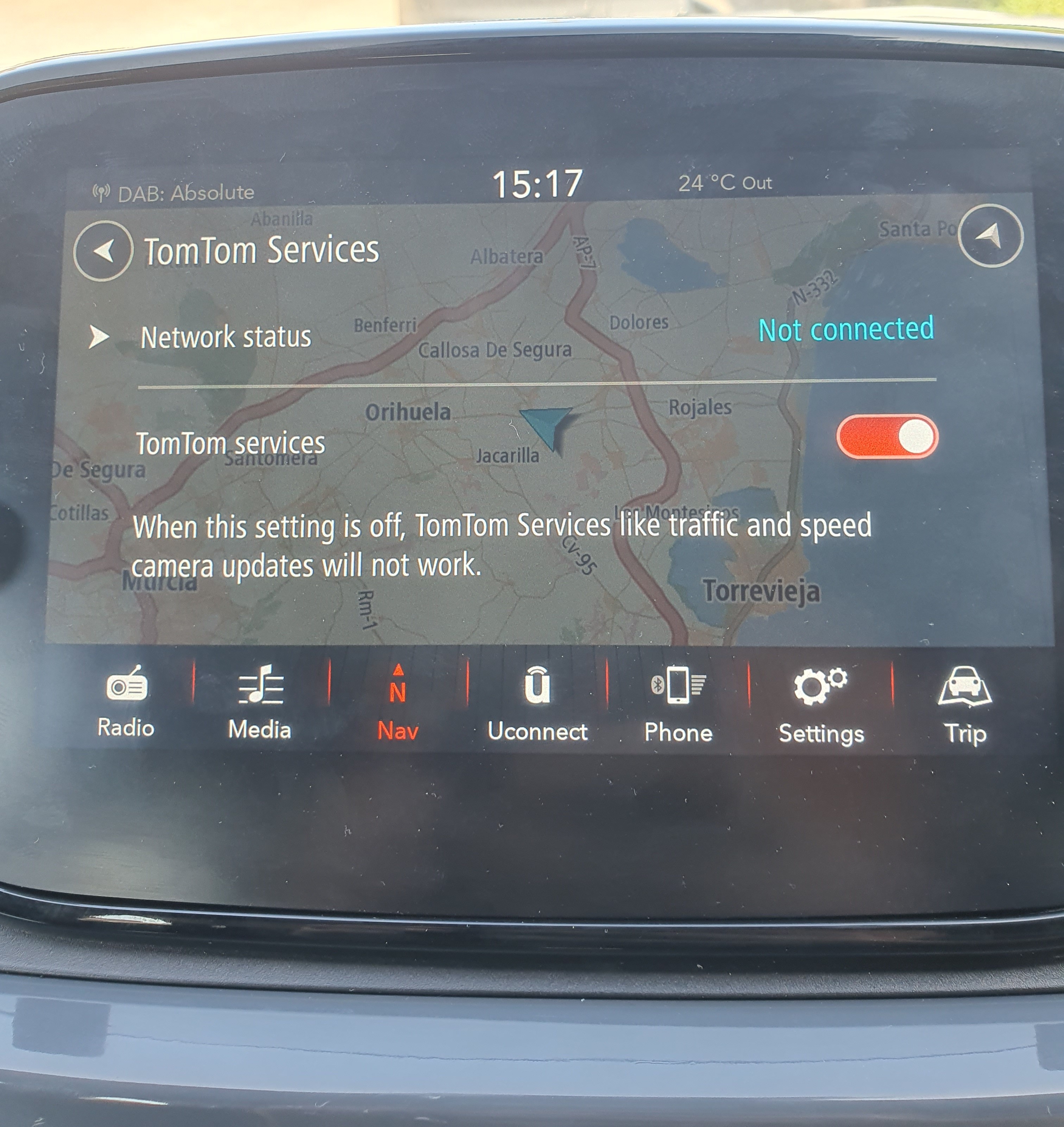

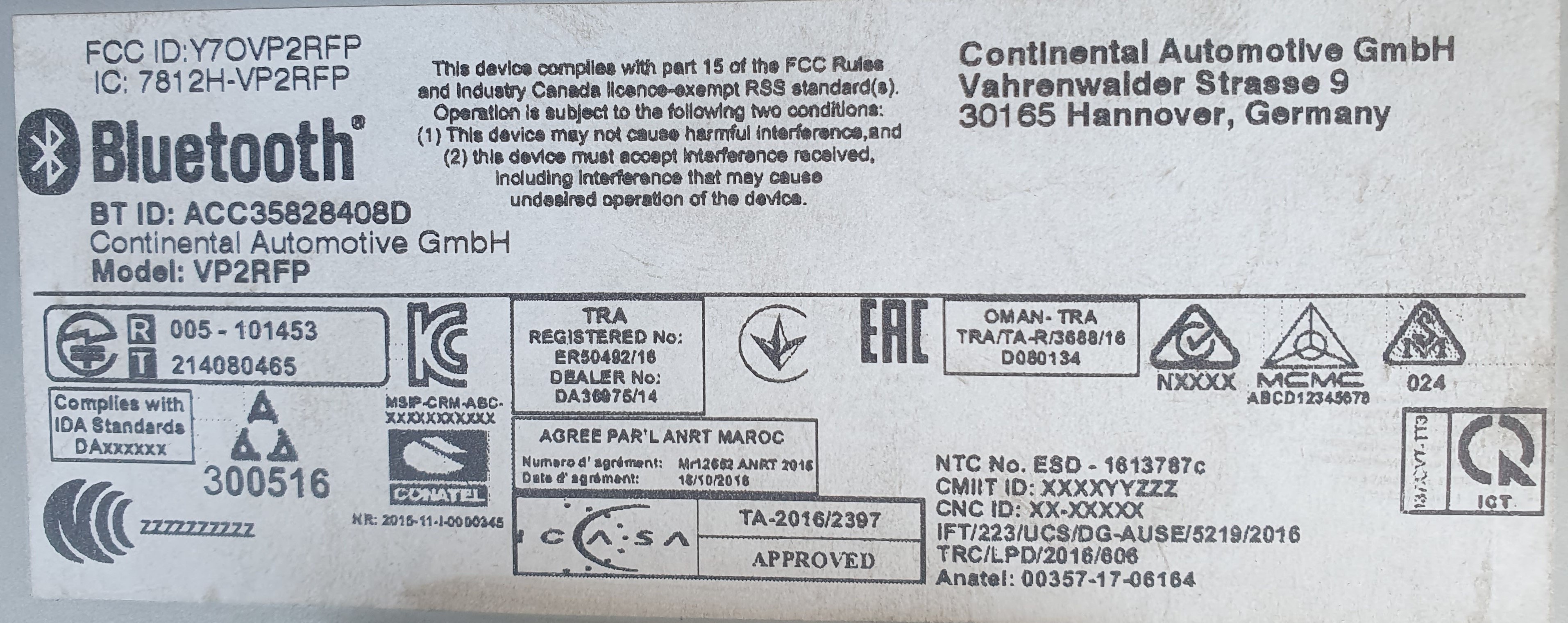

Hi, my daughter bought a 2020 500 pop with a non-working standard DAB radio (no satnav). She got a replacement head unit with sat nav from ebay which I have fitted and everything works apart from the sat nav which is showing the mapping for Spain. Unknown to my daughter the head unit was from a Spanish seller. I have looked at every setting and can't find a way to change to the UK map. All the search and routing functions work fine with UK addresses but it always routes from the same location in Spain. I have reset everything I can find on the head unit and on the TomTom app but the car still thinks it's in Spain.
I have attached photos of the stickers on the radio for info and screenshots of the TomTom info.
I am stumped on what to try next, I have searched for info on how to reset / update the maps but drew a blank on that so any help / info / guidance would be greatly appreciated.
