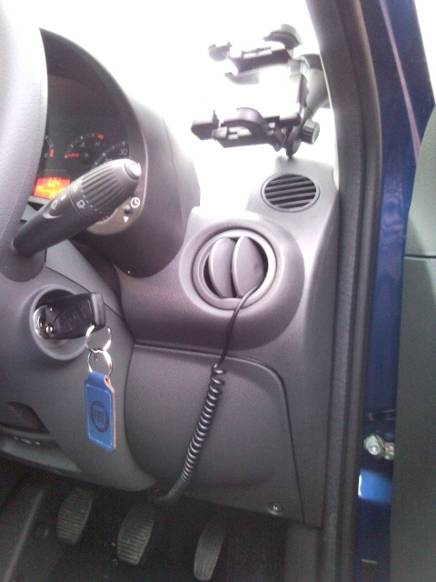

Attach the whole assembly inside the fuse box with some wire/duck tape (plenty of space inside). Only the charging wire goes out, additionally fix it by screwing the fuse box lid over it.
Finished setup looks like this (when unused, I put end of charging cable inside ventilation duct, handy way to prevent it from jiggling around):

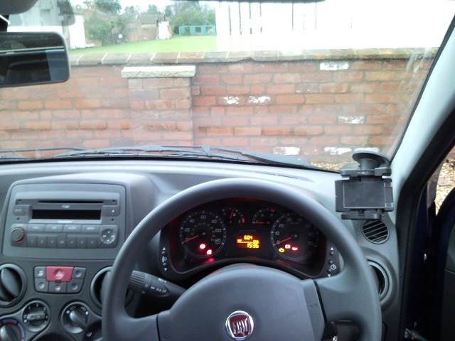

Universal pda&phone holder. Short, thick and rigid leg with screw fixings - to prevent vibration. Big and robust suction cup:
http://computers.shop.ebay.co.uk/i....=p3286.m270.l1313&_odkw=pda+car&_osacat=38329
The whole setup from driver position looks like that:
Almost like factory setup
And for the fraction of the cost of the full GPS - but no less functional (even more in fact, since smartphone allows a lot more customization). Also easy to take it with you to prevent theft.
