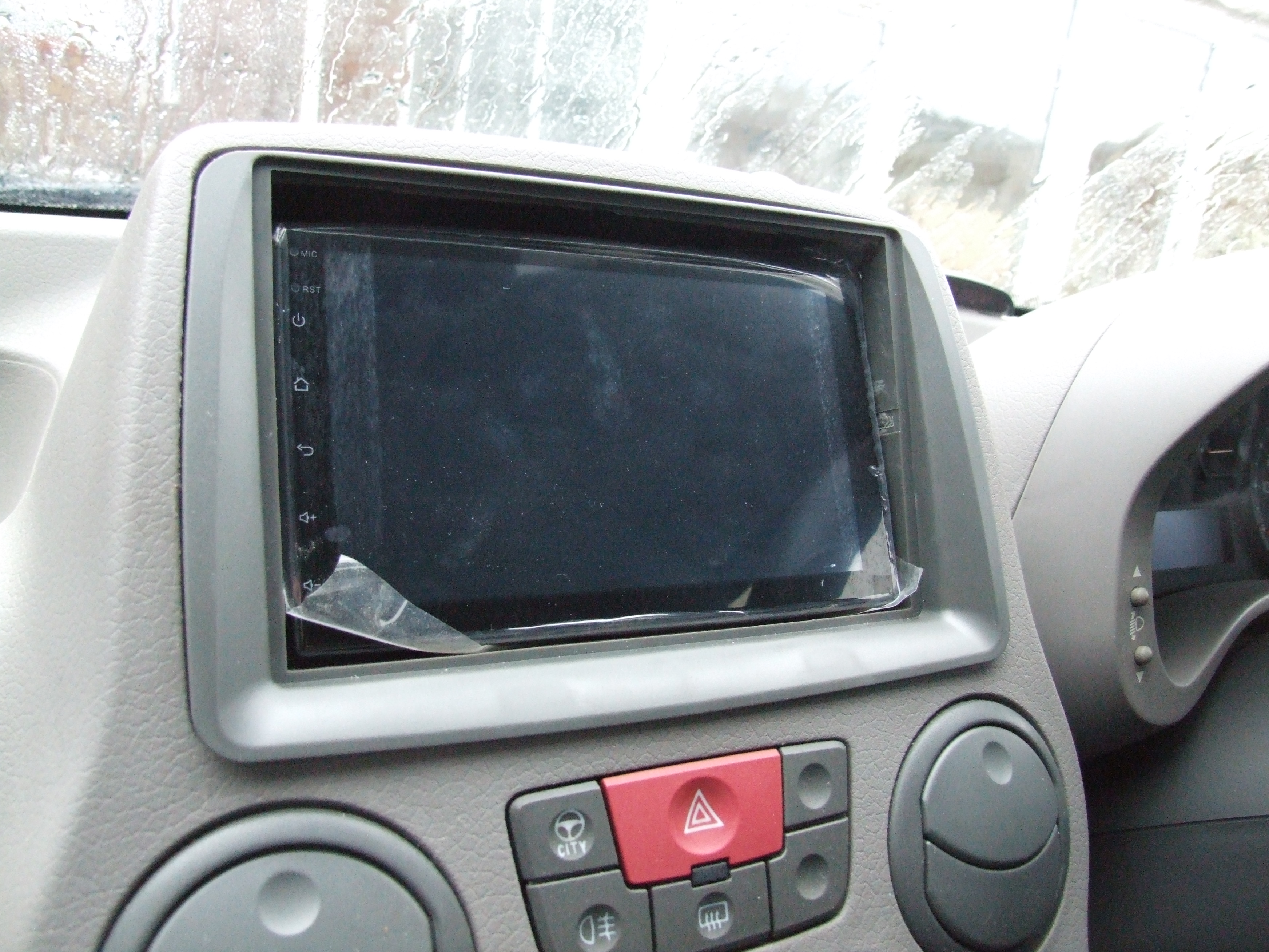

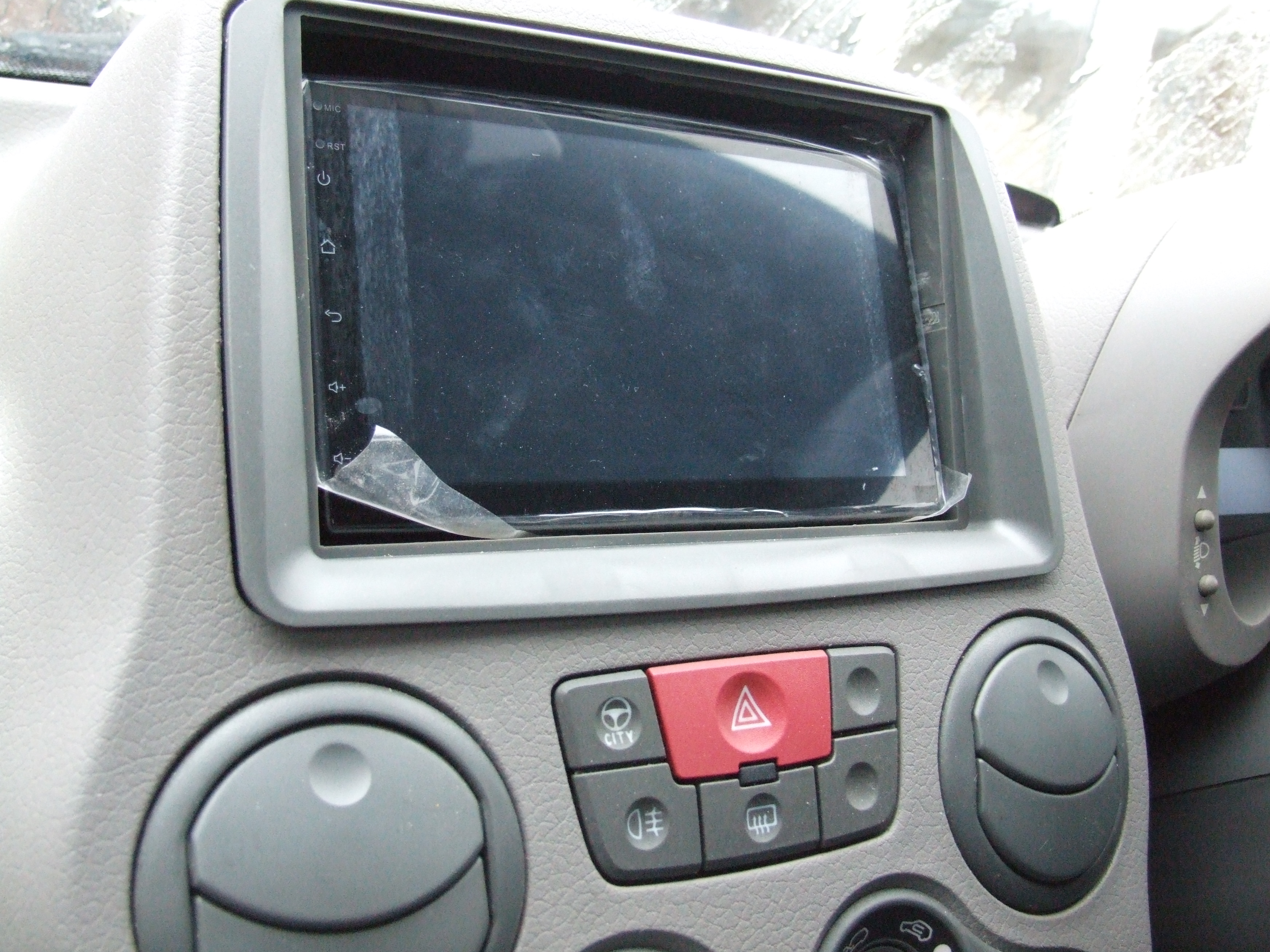

Work in progress update.

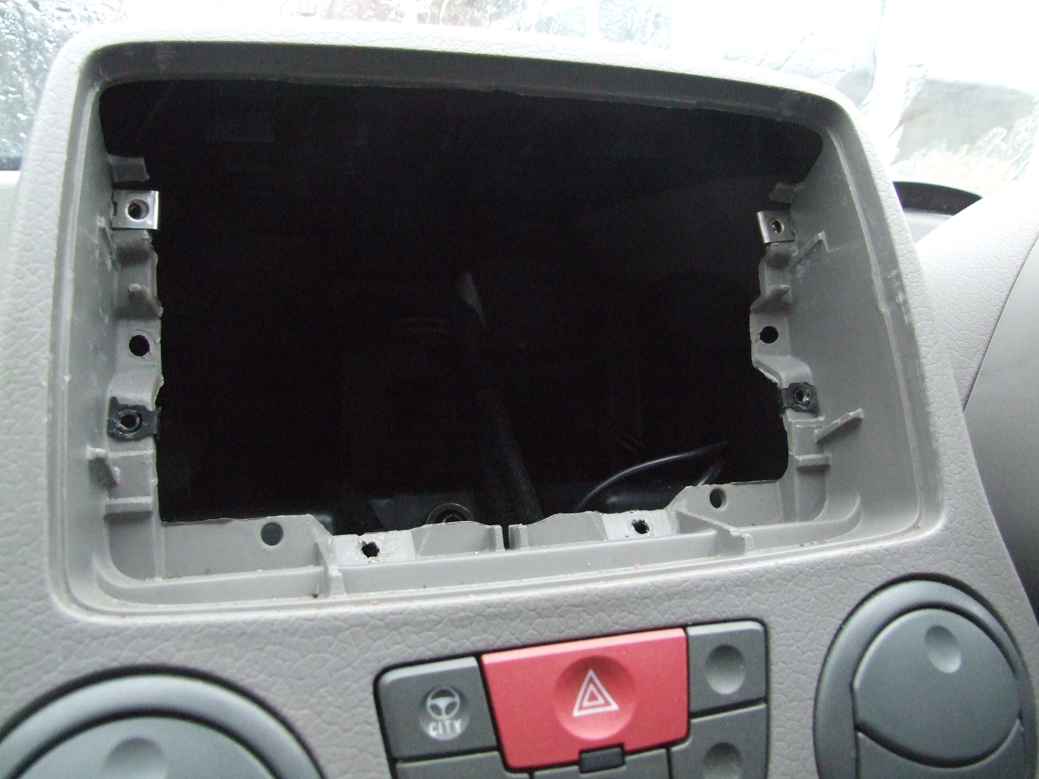

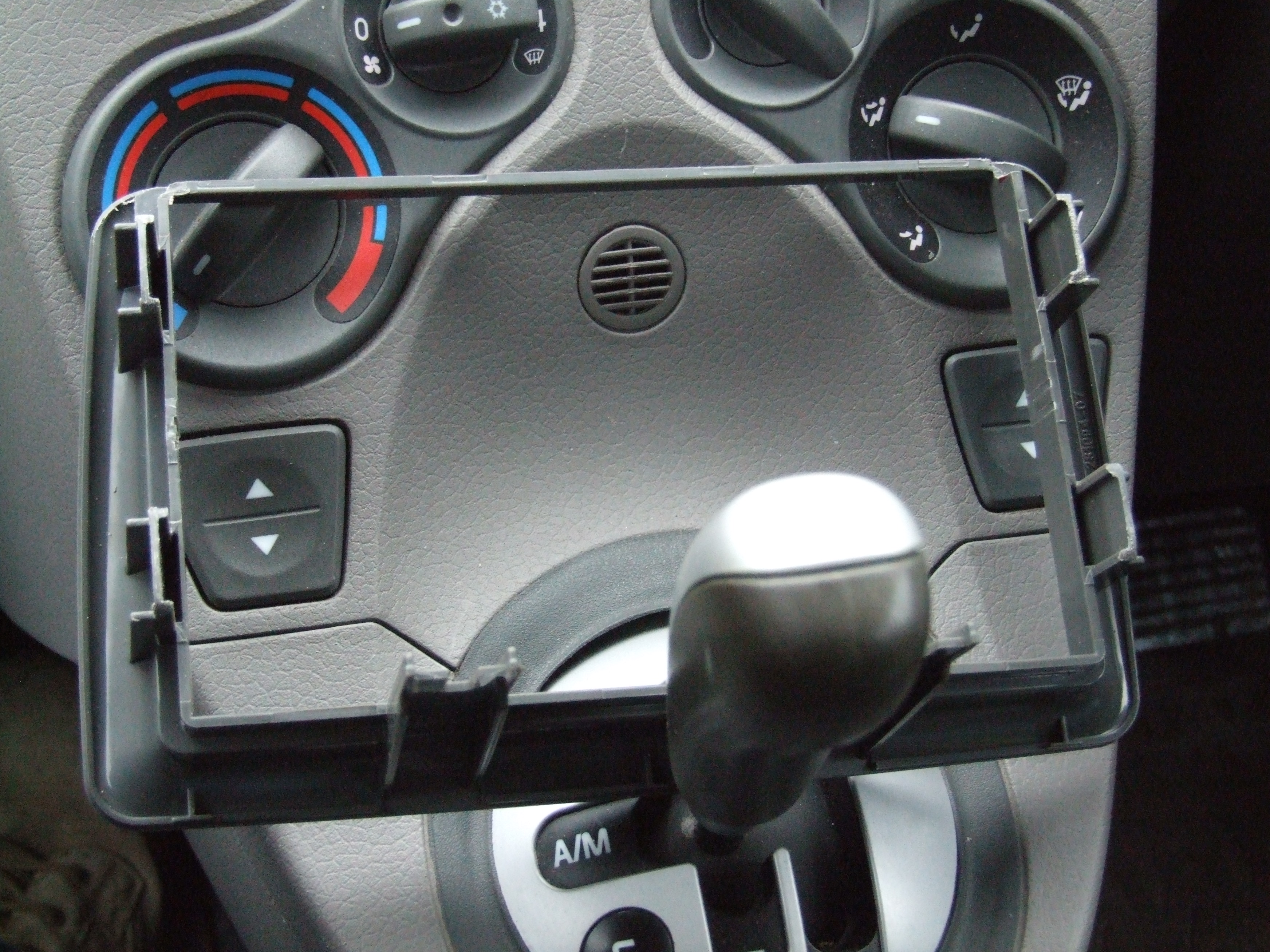

One reason for doing this job is because a previous owner had installed a radio apparently using a kitchen knife. I removed the butchered surround which had a small in-tray at its top. The main reason is to get a sat nav display - the radio is never on and so not needed.
I wish I had put a cloth in there to catch the little bits that insisted on falling behind into oblivion.

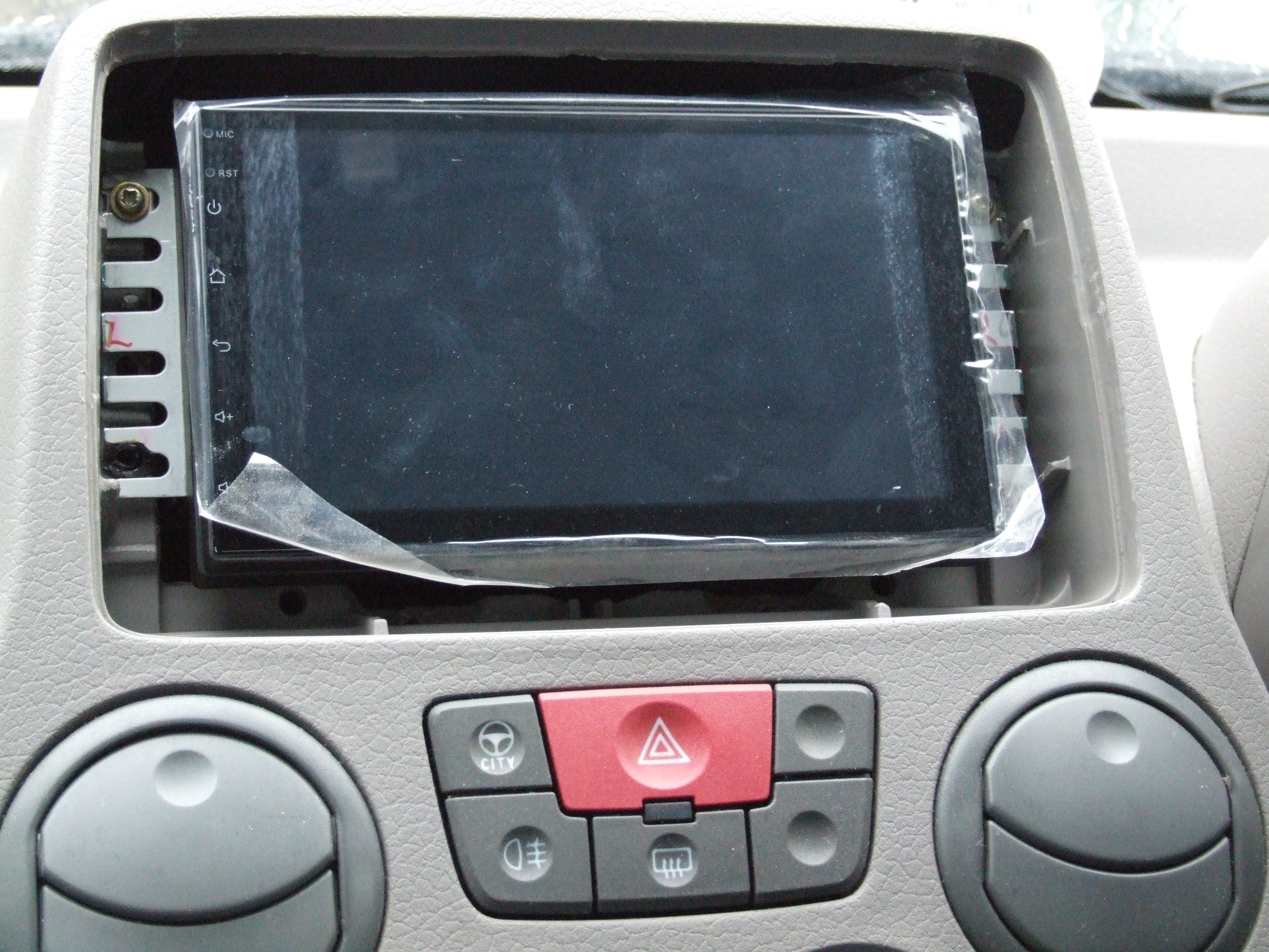

I used the existing U clip speed fasteners for the four retaining screws for the new unit but lost two in the process of removing them to place in the new positions.:( They area bit different from my usual type and sprung off flying right into the void
I had to fettle the new plastic surround a lot by trimming it on the edge as well as the mounts in order even to get it to fit. I had specified the year of the Panda but it looks like the wrong type had been sent.
The Android came with "universal" mounts which had to be trimmed by removing ¼" of each edge and realigning one slot hole on each side.
Now that the unit is physically in place I will be able to connect it once a 16 pin Android to ISO lead arrives.
Once at that stage I will continue the update
