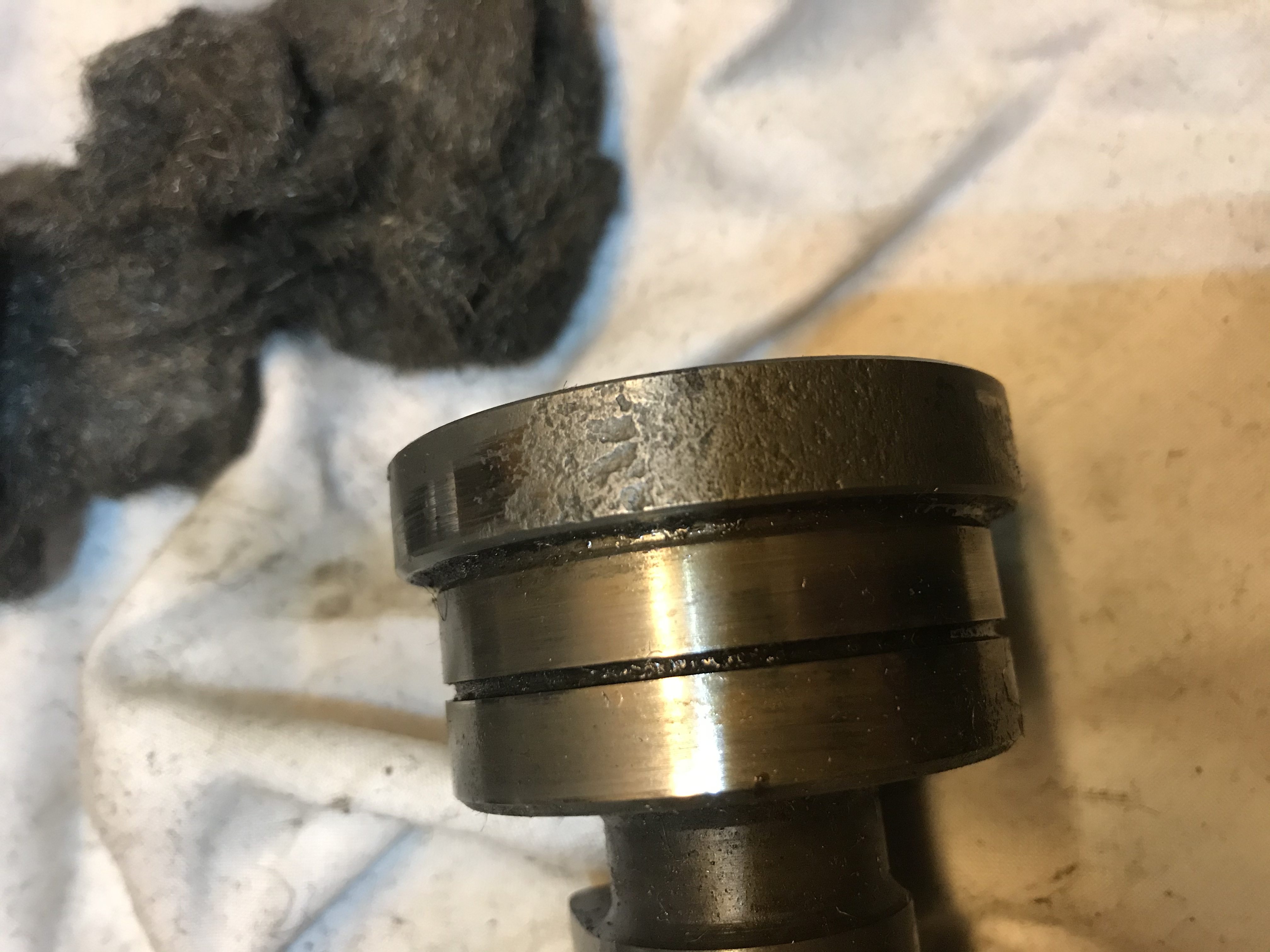

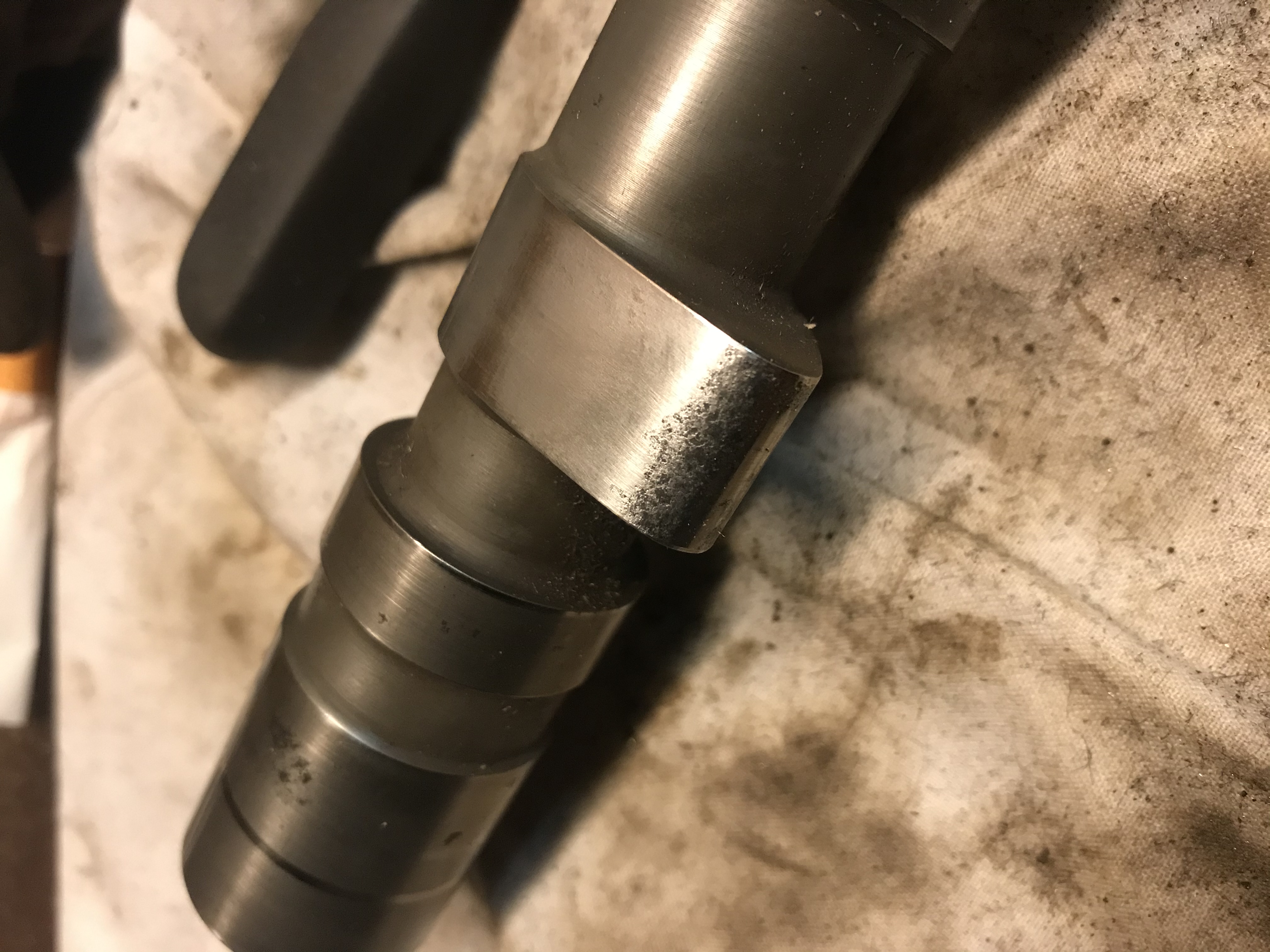

Hello i have gotten a camshaft for free for my fiat ritmo 1.3 70cl
But the camshaft is quite rusty. Can this be saved somehow or is it for the trash can?
