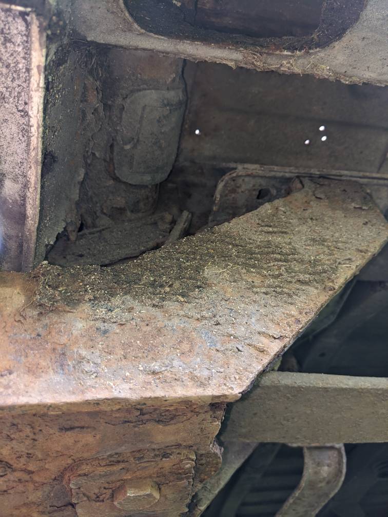

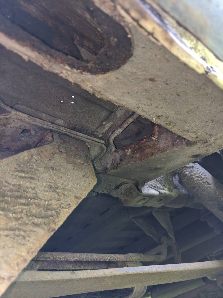

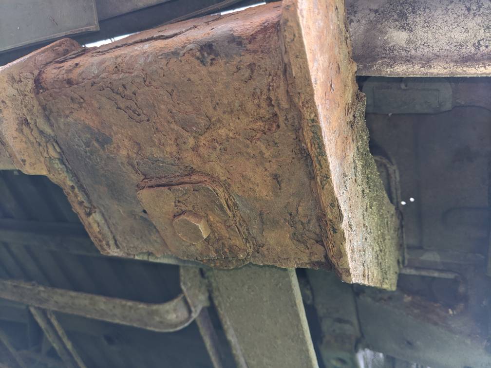

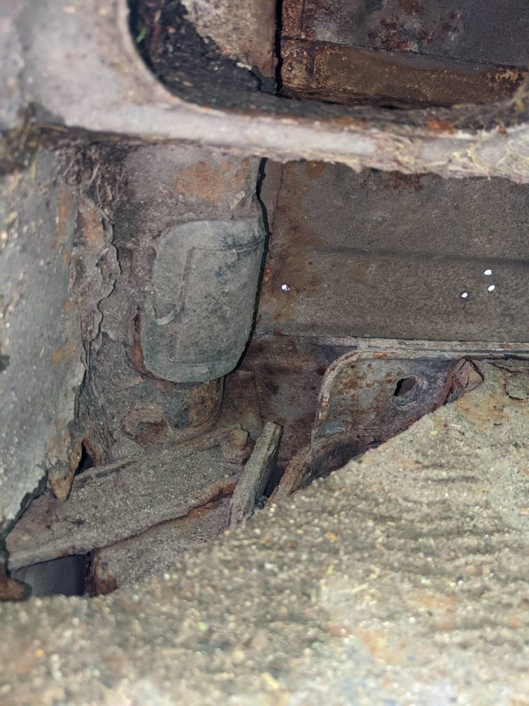

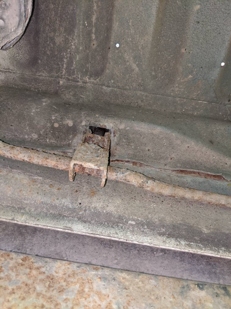

Been stripping the van out this weekend. The rear of the chassis appears to be reasonably crusty. Can someone suggest the best course of action for this? IMG_20200628_115237.jpegIMG_20200628_115226.jpegIMG_20200628_115221.jpegIMG_20200628_115212.jpegIMG_20200628_115205.jpegIMG_20200628_115201.jpeg
I've got a disc cutter with me currently. Going to try one of the flap wheels on it and see what sort of finish I get. It is all solid (so far) just crusty edges
Well, based on 50 years ecxperence of rusting vehicles and 'magic' rust treatments, I'd just brush it with gear oil. It will get into places nothing else will. Places where rust grows.
You won't get into the most important little plasces with your power sander , but can soon grind through thin metal elsewhere.
And the dust and flying debris is not too bad in a workshop, but I wouldn't want it whilst laying under a van.
I value my health more than that.

Definitely can't reach it all with the disc cutter.
Will gear oil stop/greatly slow the rust? I don't know how far off that is being bad.
