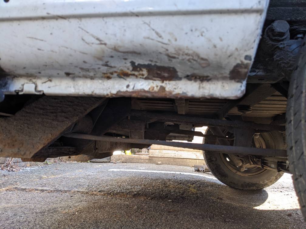

There is a bit of a rusty patch where there was a slight scrape at the sill on the driver side. What is the best way to deal with that? IMG_20200625_073934.jpeg
Hi
A few thoughts from one who has dealt with rusty cars for decades. Rust is an electrical process, where current flows between steel and another metal (or between good steel and rusty steel) through an electrolyte, i.e. water with impurities. The good steel is eaten away. That's why salty water is worst as it's very electrically conductive. So keeping the metal completely dry is your aim, and all the treatments are intended to achieve that. Flaking treatments are worse than none at all, they just trap the water.
Stuff like Kurust will convert the last scraps of rust in the pits, that you can't get off by wire brushing. However, you end up with a porous film, so you must put something else over it.
I'd recommend a brushed automotive chassis primer and then a brushed topcoat. Real zinc primer and red oxide primer were fine, but the stuff the public buys nowadays has no metallic zinc or lead oxide in it any more, it's just a name.
Waxoxl over well dried paint gives me good results. The thin clear (ish) stuff brushed on sheltered areas and sprayed inside hollow sections. The black thicker stuff for anywhere more exposed. It does a good job of excluding water long term.
I don't like Hammerite. It never was much good, and has also been re-formulated for Elf n Safety so is even less good. You also have to throw away the brush, or spend lots on thinner. Long term it tends to go flaky. However, any paint is better than none, so if someone gives you a big tin you might as well use it.
The best way to get rid of rust, is cut it out and replace with new metal, 100% no arguments. However, if it is surface rust, or has not holed the metal, and the metal below can stand up to an agressive prodding from a screwdriver etc., the next best thing is to sand or grit blast it off, to sound bare metal, then use good quality primers, paint, and rustproofer/wax etc. Failing that, sound metal with surface rust can be cleared of any loose rust, be brutally honest to yourself that it is gone, any remaining surface rust may then be treated with a rust converter- I have had surprisingly good results with Fertan- and then when properly cured and treated, quaulity pprimer, undercoat, top coat, stonechip if underneath, then wax spray like Waxoil, Dynax, Dinitrol or similar; no such thing as too much!
And before I forget- loose or cracked/flaking underseal is worse than anything imaginable for making water traps that will, for sure, allow rust to get hold and and out of hand very quickly indeed. Take no prisoners getting it off, even if you have to go back to a bare panel, to avoid doubt at all costs. You will sleep easier in your bed knowing 100% that it is properly done. #
((That way you won't be woken by strange noises in the night that take weeks to pin down- the sound of your van rusting!! LoL)
Thanks for that. Definitely need a lot of unseal scraping off.
Take your time, set target areas so you don't become downharted with it.
If underseal dried out and cracking get rid of it , if it's still sound it can wait

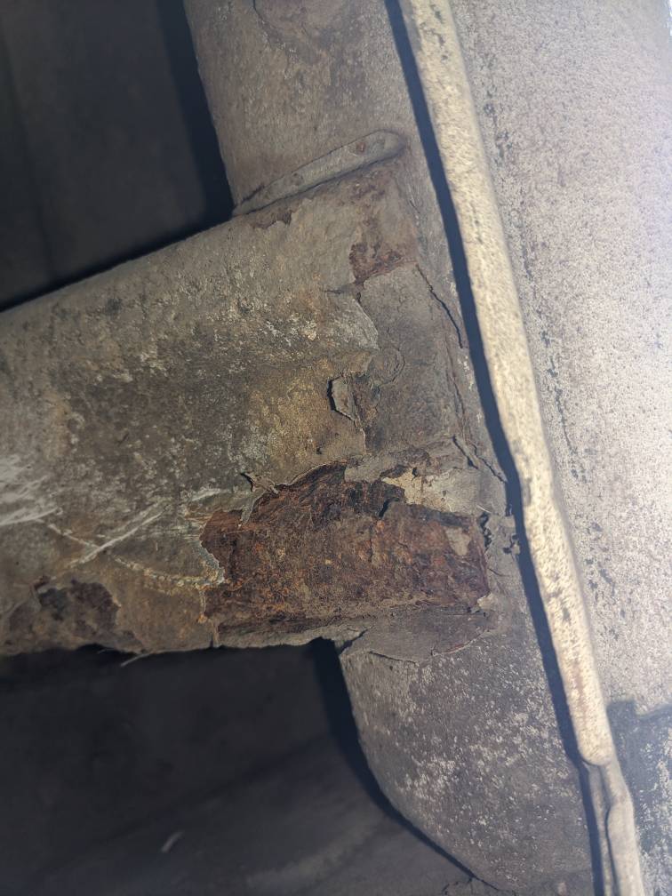

Been underneath with a screwdriver. This was on of the rough areas at the rear... Managed to poke the screwdriver through and make a hole, as can be seen here. Is still a big issue? It's a part that joints to the sill.IMG_20200625_155945.jpeg
Never had actual rust holes before, so I am a bit concerned...
Not sure how best to help you. Frankly it takes courage to deal with this sort of thing, you have had some excellent advice so far. Don't get disheartened, it is probably better you deal with specific areas per session as you build up confidence. Certainly don't be afraid to dig, you won't do any more damage than the rust has already (within reason) and you are better off rid of loose materials. Bring back to shine as much as your patience allows then blitz with a rust converter. Make very sure that it has dried then paint, brush will get under seams and behind areas, spray will deal with larger areas within the spray cone better, either way imagine how water can move around and make sure your final wax of choice can get there too.
Go for it, it really is worth getting past these early steps, you have little to lose.
Things like that hole above, is that something that'll just get worse, or cause me issues?
I don't know a lot about rust.

Don't worry with luck your friendly garage who did you panda thread insert will weld a plate over it for you.
Do not paint or worse wax within 30cms of the hole until it is welded.
You may find it easier to strip that underseal/foam whatever it is with a wire brush on an angle grunder-
use eye protection and ear protection, seriously use protection
