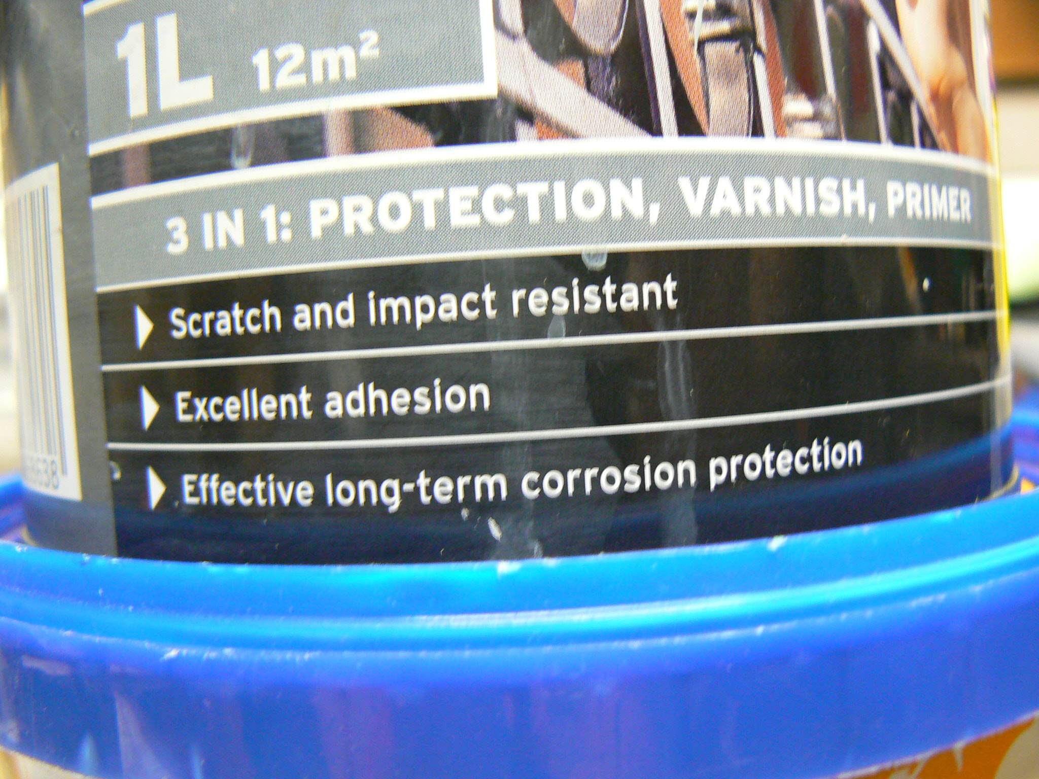

Unless I learn something unexpected about the Fertan I think I'm set on using it. My preparation plan is to wire brush and chip as much loose rust off as I can and then power wash it before starting in with the treatment. Fertan seems to fit in with this particularly well as they actually encourage cleaning down with a pressure washer, applying the product and then, after an hour or so, dampening down with water again to maximize penetration. See the instructions about half way down this page https://www.frost.co.uk/fertan-rust-converter-5l/ I really like the sound of that, it sounds very achievable. Then I'm going to give it 2 coats of this wonderful stuff:
Which I found quite by mistake at Lidl/Aldi (can't remember which) It doesn't dry to a brittle finish and seems to last well on car undercarriage components. I painted the Panda's top spring pans when I did her struts a couple of years ago and it's showing no signs of flaking or degrading at all.
I'll certainly post the outcome and any conclusions when I'm done.
