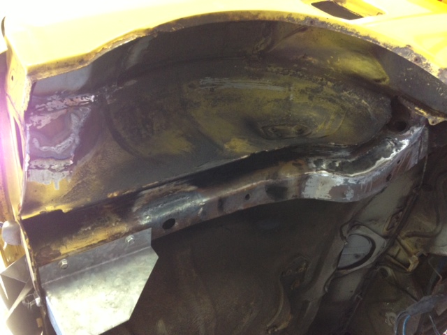

Hi
I finally feel like i'm getting somwhere now. The welding should be all complete over the next few days then its a small amount of grinding/filling and lots of painting inside and out.
This pic shows the amount of work one side needed and the other was not much better. After the painting I have the task of reconnecting the fuel tank, suspension, brake lines etc and hoping the car starts! Its been out of use for 18months now.
Still got to find a fuel filler neck though, anyone know where a good place to start is? ebay has none.
Thanks
nath
