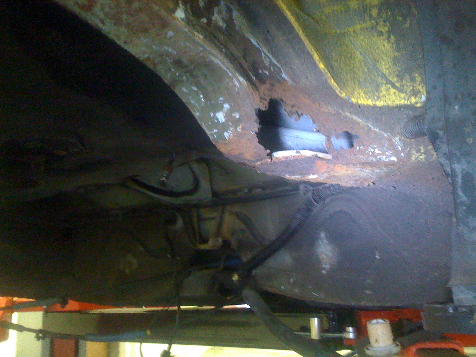

My well used cinq recently failed its MOT on some welding and a few other things. I really can't bring myself to scrap it. After a few hours in the workshop i uncovered some big holes, are these common places?
Behind both lights, boot floor and near rear suspension mount (failed on this).
Also a pic of car in workshop looking sorry for itself!
All going well it will be welded up soon, just not sure if to do a slight resto or a full one including respray? Any advice?

The welding isn't so much the issue as the fabrication of the part. Still it's do-able. Rest of the car looks nice, so I'd be inclined to. Points to the importance of cavity wax, doesn't it?

Of course, the other source of panels is ye scrappy. The rear arches are in two sections -- the inner section is identical, I think, to the Sei one, while the outer is different, but a Sei one would probably be a significant head start. The panels are worth bugger all to the scrappy -- they're light, but they'll charge you for getting them off with the gas axe.
