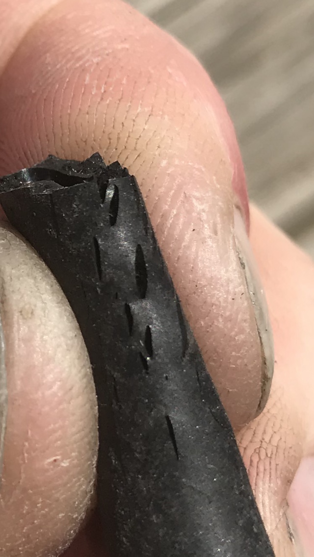

I also found my fuel issue when I restarted it. Leaking hose at the carb.
Turns out braided fuel hose is crap.
Literally it has broken down.
When I came to pull both sections off the pipe they broke in my hands.
Lucky I found it when I did as there was fuel everywhere.
Will have to replace the front to back hose now to be sure that doesn’t fail.IMG_9399.JPGIMG_9400.JPGIMG_9402.JPG
I bought stainless braided hose for mine from ebay. Within a a year I was shocked to find petrol seeping out of the braiding and the rubber core had also fallen apart so the hose was just not suitable for modern fuels. :mad:
There are fuel lines available which ARE compatible with modern fuels---it will have it written on the side of the fuel line. They may not look very 'flash', but will do the job. If it doesn't have it written on the piping, do NOT buy it!

I have the braided hose on my car and it’s been on there for about 5-6 years without any problem. Personally I would bin the inline filter, apart from the fact it’s not needed, I think it makes the hose too rigid which would lead to the what you are seeing. I get all my fuel hose from here. https://www.advancedfluidsolutions.co.uk/petrol--diesel-fuel-hoses-89-c.asp

Interesting points about the fuel hose.
I have ordered hose which is said to be suitable for unleaded and it’s on the hose. So fingers crossed.
I will be taking the filter off as to be honest I have never seen anything in there apart from fuel.
