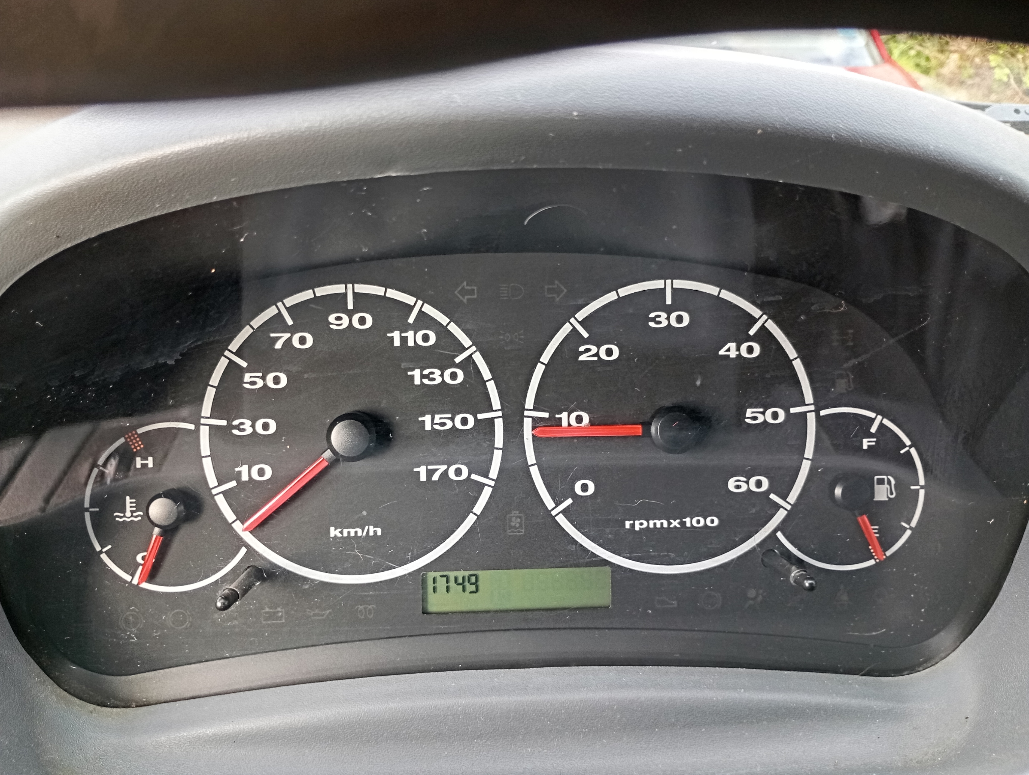

Hi, I've got suddenly an issue in my RPM engine counter.
It marks at least a thousand more than the real RPM.
When you start, without accelerating, it marks 2000 rpm.
Accelerarting it marks 3000 rpm when we are at 2000 rpm really.
The engine goes well.It sounds ok...
Does anybody know what could be the problem

You have not mentioned the model of your vehicle, but fron the 2002 introduction of the x244 model, the rpm indication has been via an electronically driven stepper moter, with the signal source being the crankshaft position sensor. As engine runs OK the sensor must be OK. Most probable cause is a failure of the instrument electronics.

Here's the problem. It marks 900 rpm with he engine off, even without the contact key...
You written decription was clear. If pulling the fuse does not work, see this this new post by @Anthony489 . While the post applies to sticking needles on the X250 model, access on the X244 is similar. Anthony describes pulling the needles off their spindles for accesss to the stepping motors. I would not try to force the needle back to the correct zero position, but pulling just the rpm needle, and replacing it at the correct position may be a cheap fix, and rather akin to aligning the hands of a clock. However if there is a fault in the electronics, the problem may reoccur.

See my guide uploaded today about sticking instrument needles - it is in the guides section of this website
Your problem is likely to be due to the stepper motor mechanism sticking
For this simple repair it is not necessary to remove the needle and reposition it. The repair involves gently moving the needle up and down a few times, then setting it to zero.
Needle removal is only necessary if you want to replace the stepper motor.
