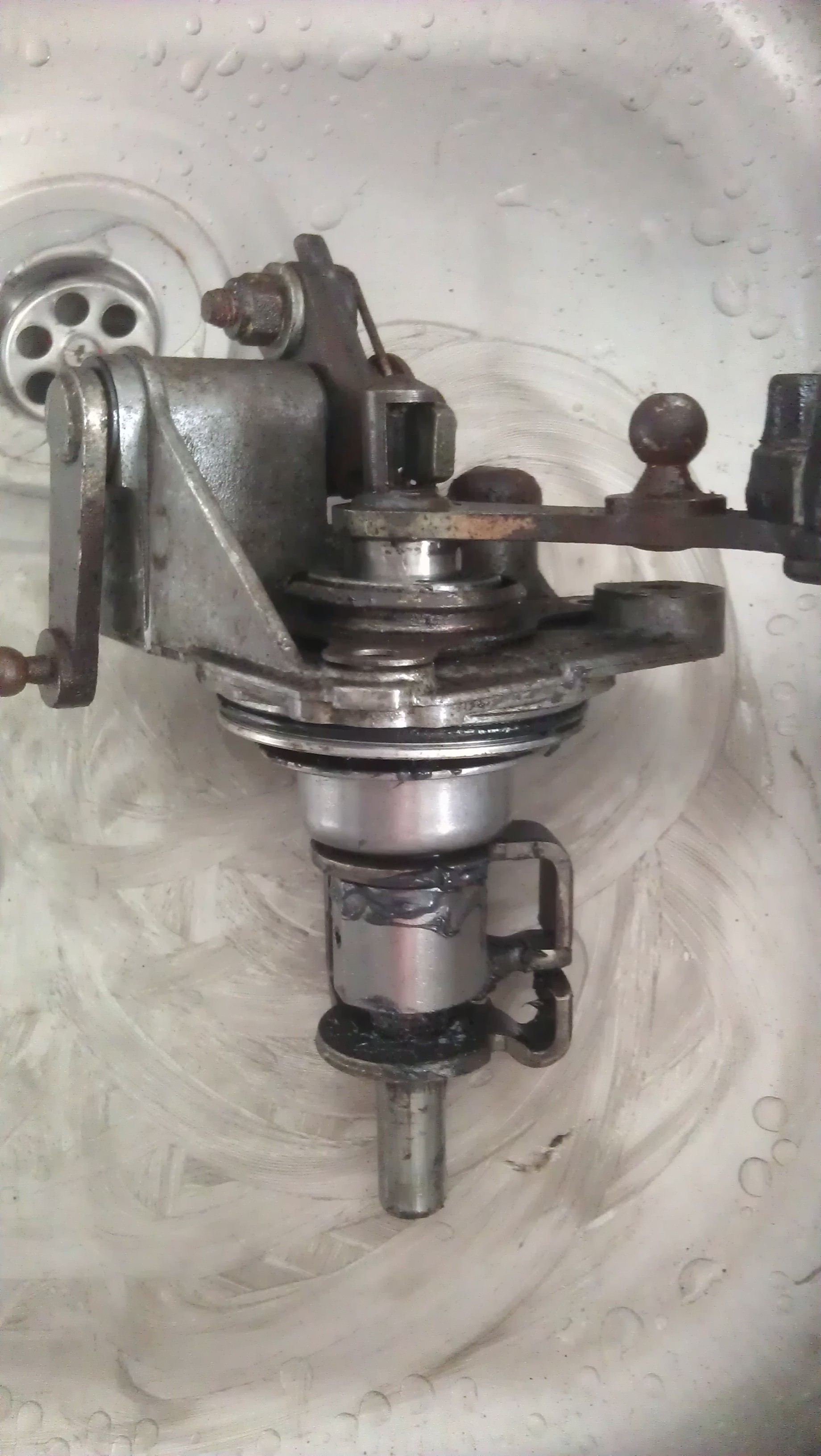

The gear selector was seized, meaning side to side throw was non existent. Complete strip down of the gear selector was required. Cleaned, sanded, and polished.

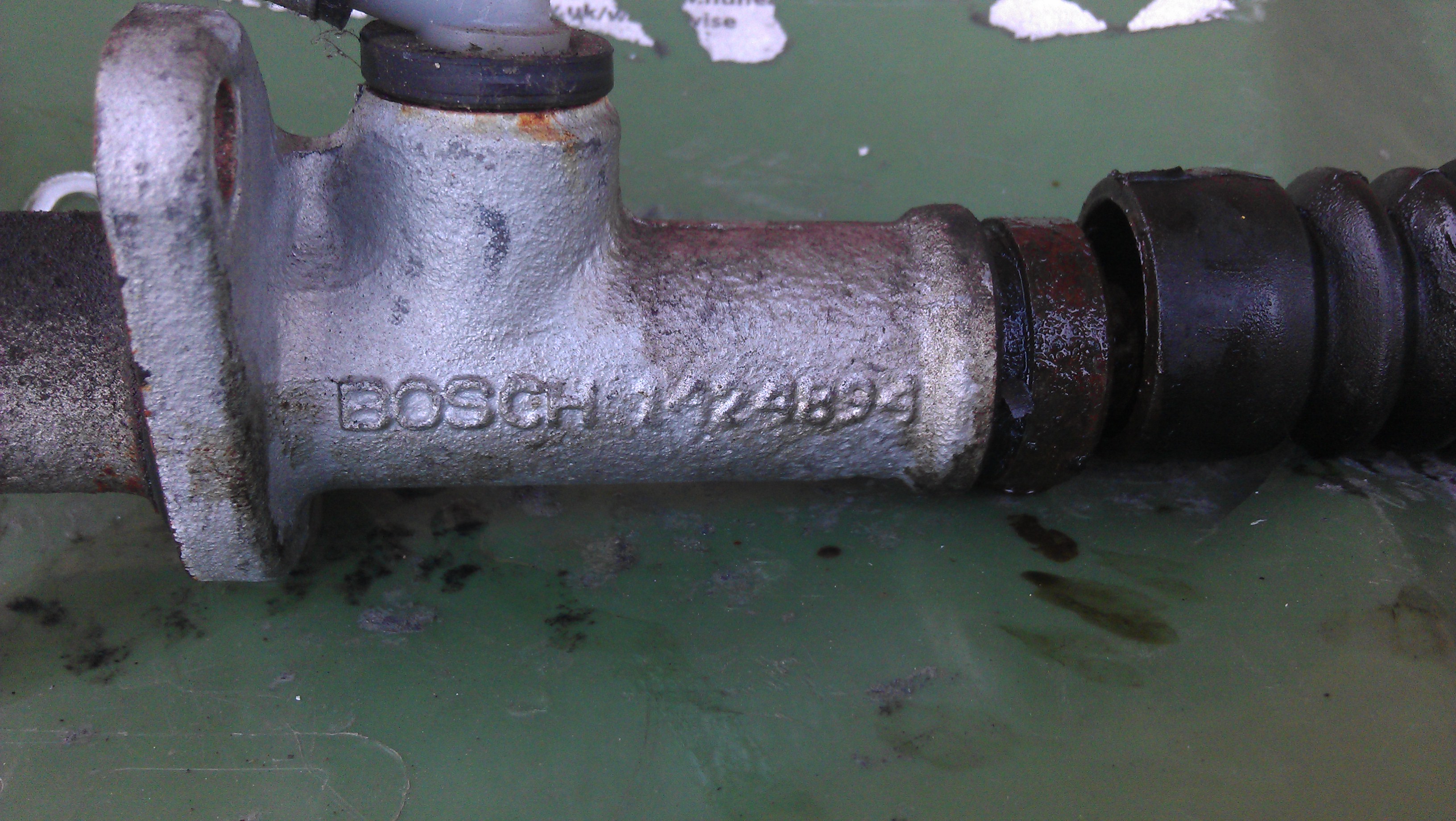

The clutch hydraulics were leaking everywhere so both cylinder have had to be replaced.

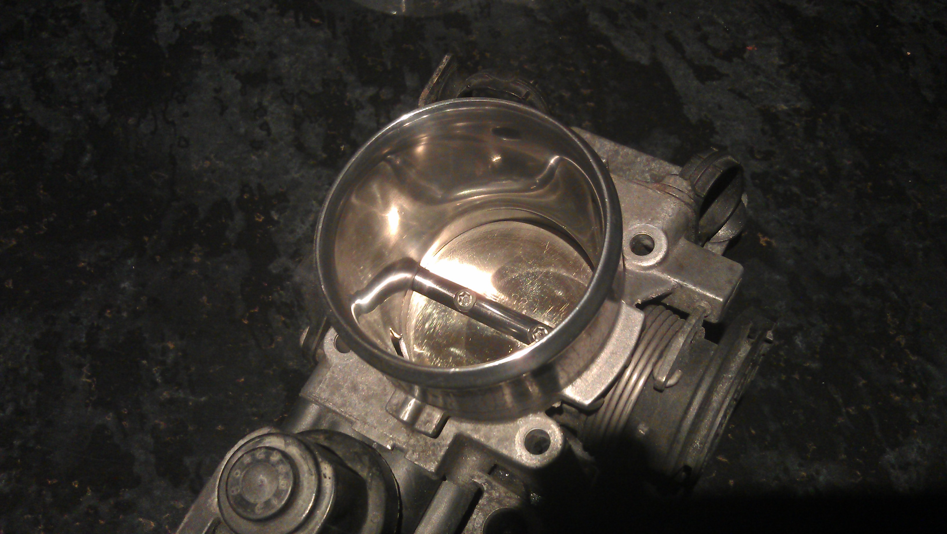

Ported and polished throttlebody with 50% of the throttle restriction removed (I didn't want to remove all of it as I wanted to be able to drive the car).

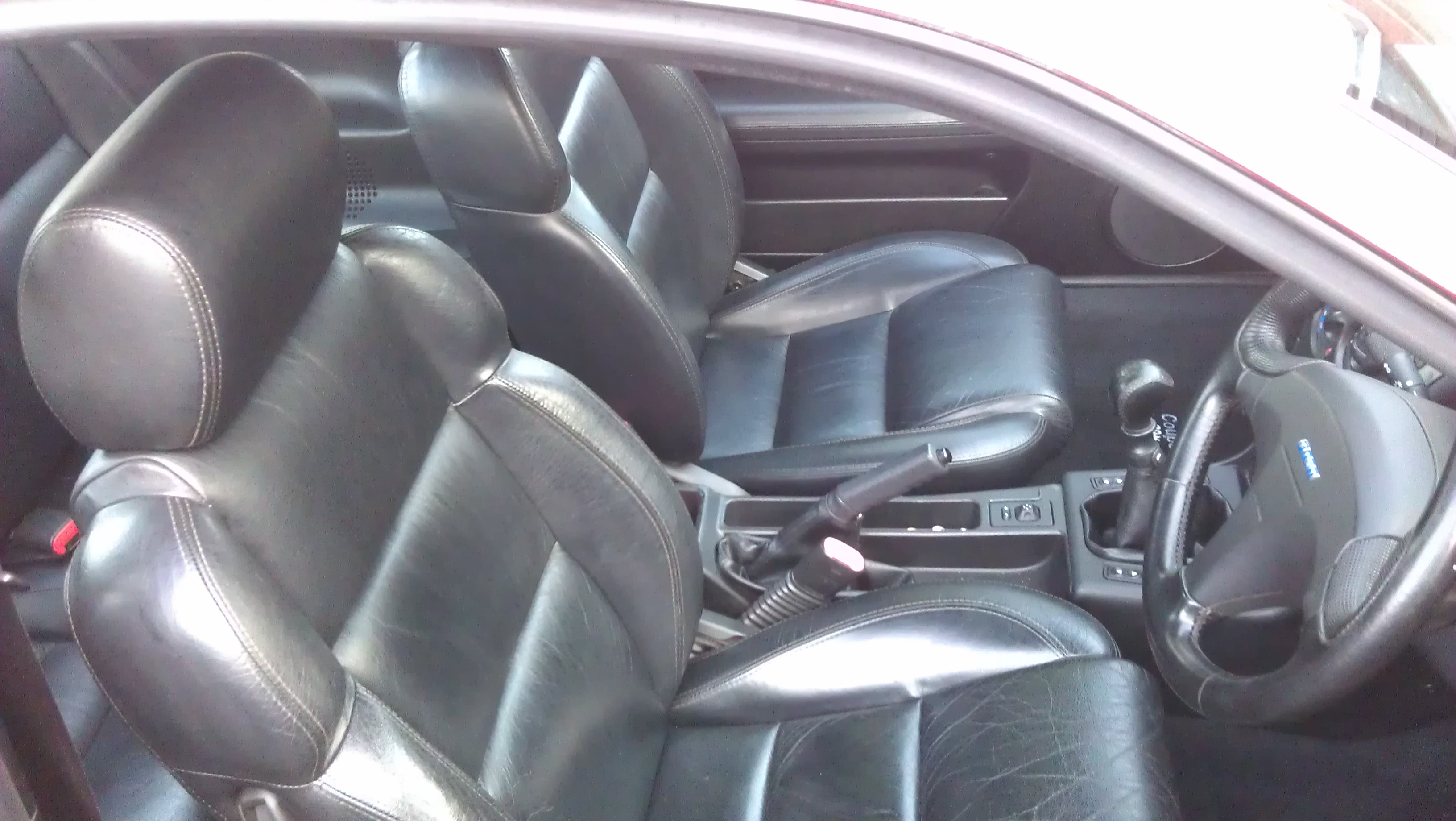

Leather interior has been repaired and is kept freshly cleaned and moisturized.
Gear selector ready to be bolted back in.
Slightly buggered clutch master cylinder.

Top lip has been V'd in, literally taken out 5mm of material all around. Throttle restriction mostly removed but kept some for drive ability. Hand sanded smooth with all cast imperfections removed. Hand buffed and polished to mirror finish. (Willing to do these but at a slightly increased cost over the normal ones PM for info).
