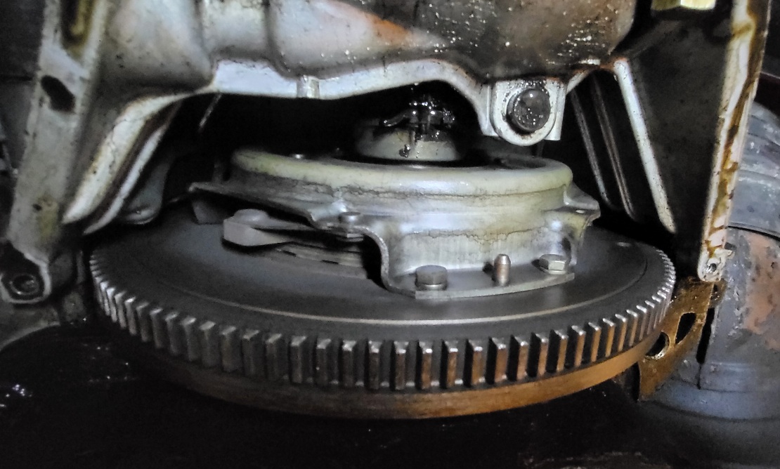

Removing the lower flywheel cover, I’d then take a look at any sign of damage, or play/movement in the clutch pressure plate or flywheel. I’d also give the front pulley a good firm pull / push checking for any movement.
