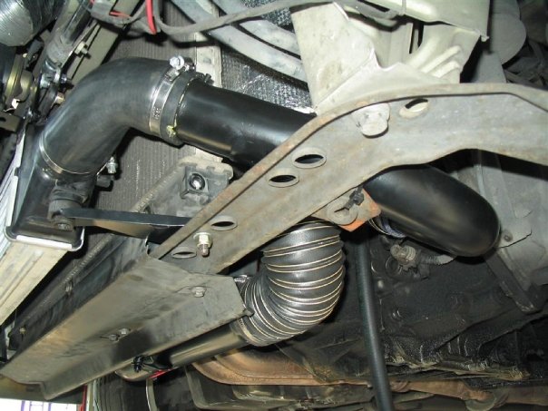

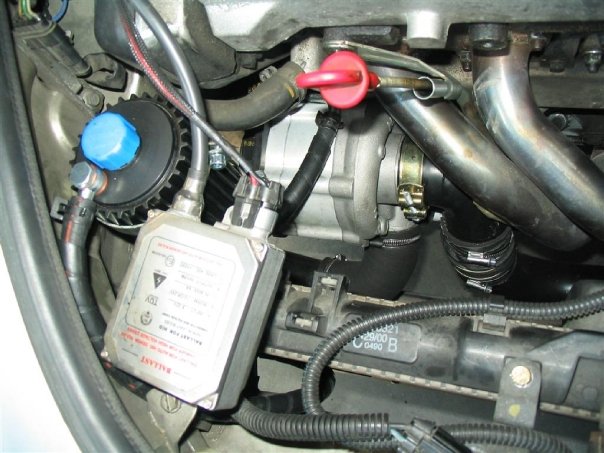

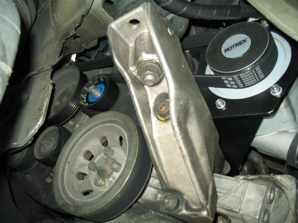

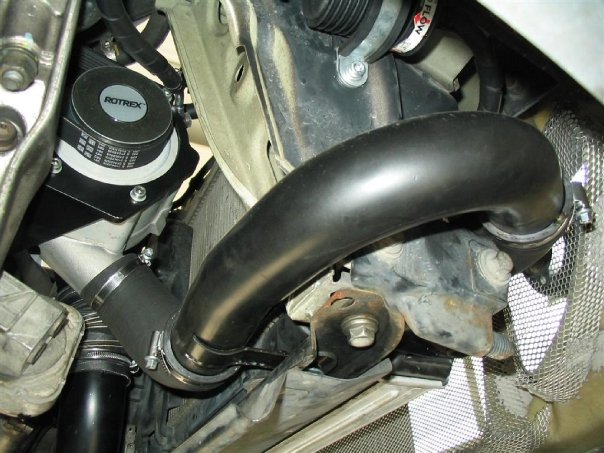

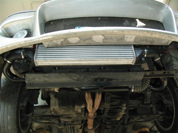

Here are some pictures of barchetta from Italy. I have contact of that guy, so probalby will know more...

I am going to sound like a :tosser: but that is a Supercharger.
The difference is the supercharger is driven from the crankshaft pulley as opposed to utilising exhaust gases to spool a turbine.
you are right... that's compressor, now i see belt... my bad.
Lol, don't worry. Have you managed to dig up any new information on that B?
I would really like to know what Supercharger it's using and if it needed any cylinder head work such as decompression etc?
Thanks F4ust.
(y)
Note; Quite interesting that the mounting bracket for the Rotrex compressor is where the air conditioning pump would be. I would imagine that would allow you to use a stock ancillary belt...

if i understod (Italian) right... whole modification cost about 5000€...
exhaust "branch" 260€, pistons 600€, Centrifugal Compressor with Control Unit 3500-3900 euro... i will know more later, i send him message.
correction: he spend about 4000€
Rotrex compressos, intecooler circuit to cool the oil and the remap of the Ecu, inox supersprint collectors, CDS, metallic catalizator and exhaust by CTSS... torque is 240Ns and over 200HP!!!
he did not change pistons (compressing rate is different than turbo), did not change gear box or clutch.
i think that's :worship::worship: but 4000€... hm.hm...
That kit looks like the Italtecnica kit, If it is i've got some graphs they sent me showing the power with the 2 diffrent pulleys available.
You don't need to modify the exhaust for it to work so you could get away with; pipework, intercooler, the compressor and a remap.
Hi Guys!!!
That is my car!:D So I spent about 4.000 Euro and they change on my car only the fuel iniectors with 4 more powerful. Then they installed the Rotrex compressor,the intercooler and the mapped the ECU.
Now the car has 240Nm of torque and about 200Hp...next week I'll tune the car more....
