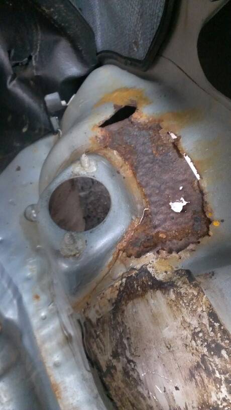

I have some nasty rot on the passenger rear inner wheel arch on an Uno I am in the process of trying to restoring. I am starting to wish I had never started this as initially the panels seemed to be available but when I went to order nearly everything is discontinued. The rot is just under the wheel arch lip. I am sure this is a common problem on these cars. The quarter panel lip above the wheel is savable with some welding of the rust holes. I would like to replace part of the inner wheel arch that is spot welded to the
quarter panel lip. It will not be easy to remove the piece but I think it is do-able. Looks too hard and awkward to weld in a plate as the whole thing is curved.
I was wondering does anyone know if a repair piece is available anywhere or any idea how I could repair this, maybe with a piece from a Punto or other vehicle. I am sure this is a common rot area on the Uno so someone must have come up with a fix.
Any help appreciated.

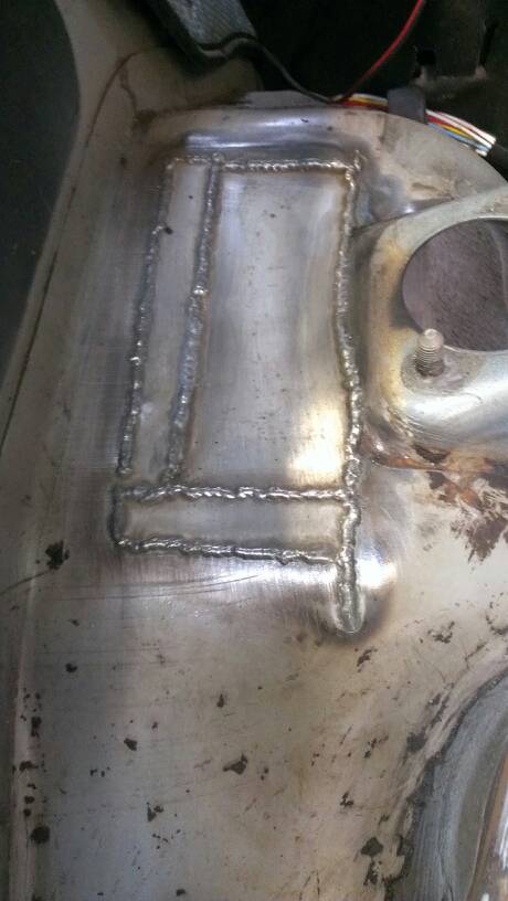

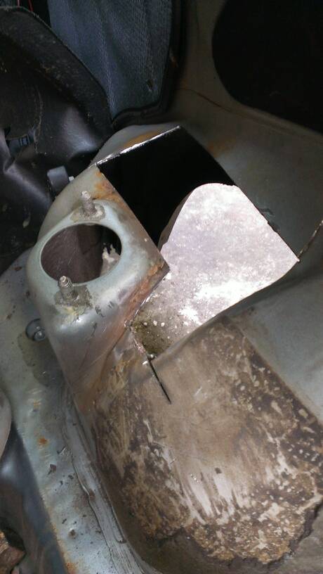

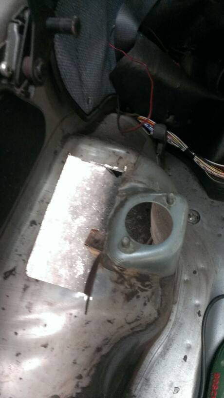

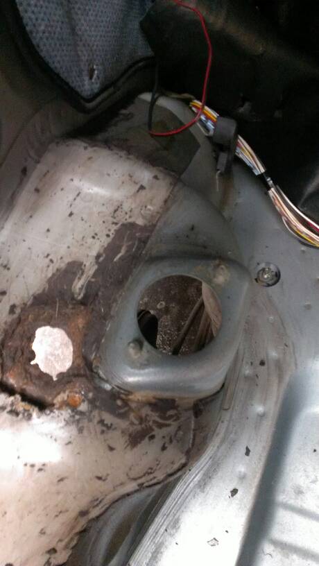

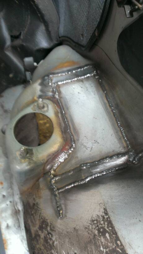

Get some good steel, and keep cutting until every little piece of rust is gone. You can weld the inner and outer sill together, but be sure to use 2mm thick steel to preserve structural integrity. If it is a lot of rust, or the suspension turret is gone, get a replacement sill. Be sure to seal everything properly afterwards
Here are some pictures to the repairs my Uno had, just for inspiration. Good luck!
