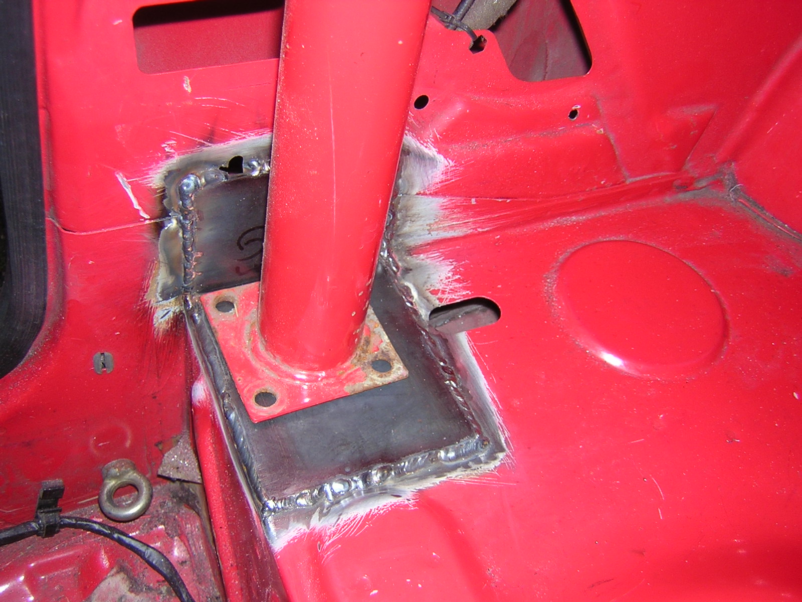

Yes my cage is an 8point Sparco cage, You need to weld re-enforcing plates inder the feet and steps under the front legs.....my cage instalation is 'in progress:p)
This is what ive done so far:

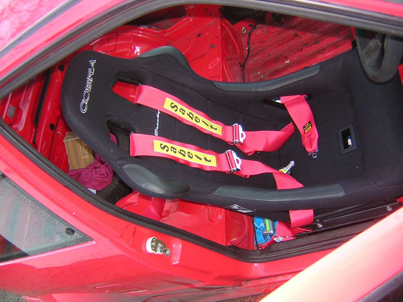

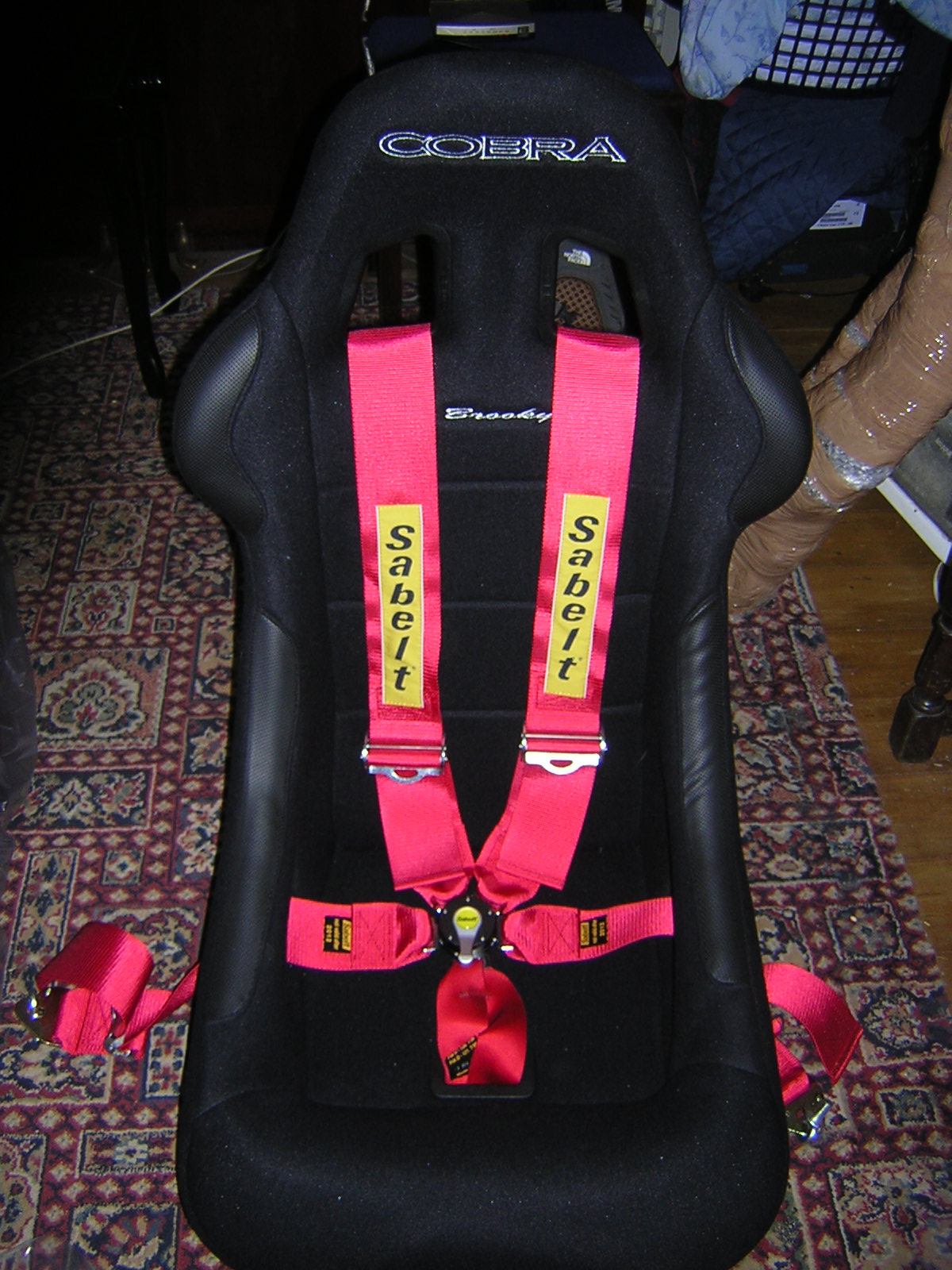

Theses are from the previous car:
Yes a full harness should be worn.....and tightened....the lad who i got the cage from had a bump and he nutted the bar that runs along the top of the windscreen....required a few stiches
