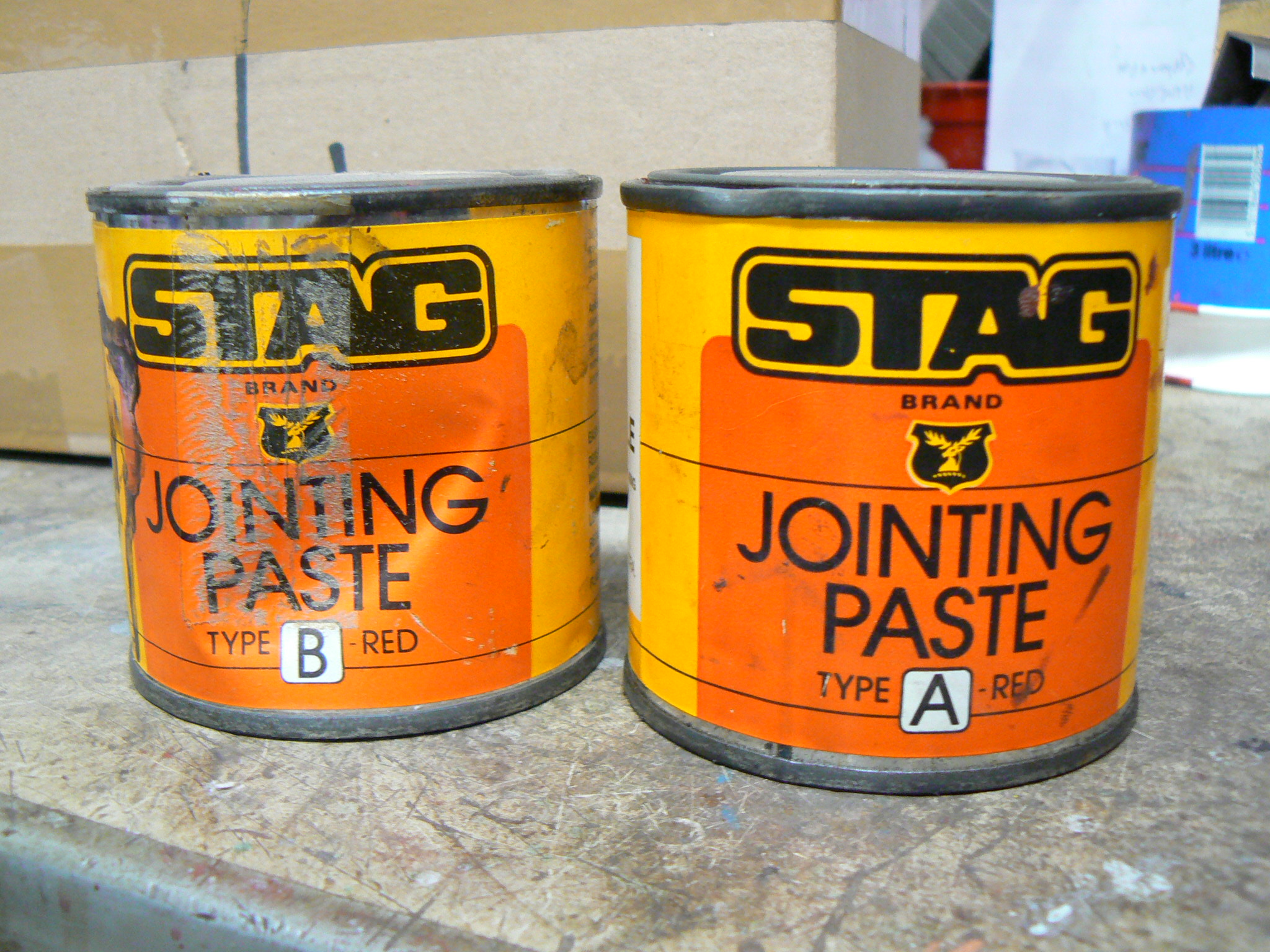

Just looked this up as it, very quietly, rang a bell in my mind: https://www.opieoils.co.uk/p-206875-stag-wellseal-jointing-compound.aspx
Then I saw the "STAG" and I suddenly remembered where the "bell ringing" was coming from:
Bought around 40 years ago I'd guess and has moved house twice with me. No idea what I used it on but back in those days I was always messing about with old British motor bikes. Certainly not had the tops off since we moved here - which was around 35 years ago - so probably solid in the tins. I'm going to take the tops off later just for a look see, but right now I'm off for a daily walk with Mrs J.
