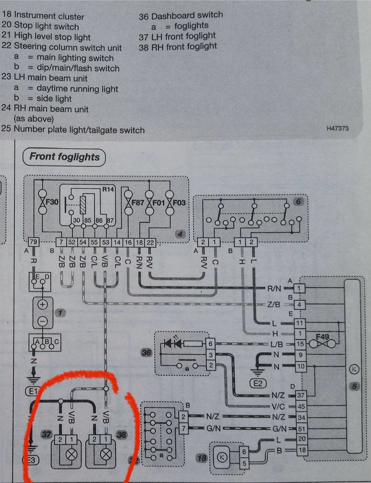

Hi, when i check the Haynes manual it looks like there’s only one cable running from the fusebox and going to both fog lights?

Hello, the wire is not really that thick, i could simply splice into it and run the wire to the right side but i do not know if this can create electrical problems into the future.
i checked the connector, indeed no voltage! can i trace back along the cable without taking off the front bumper?
If I remember right the s a joint on the cable along the bumper where the cables runs so it's quite possible you will need to take the bumper off

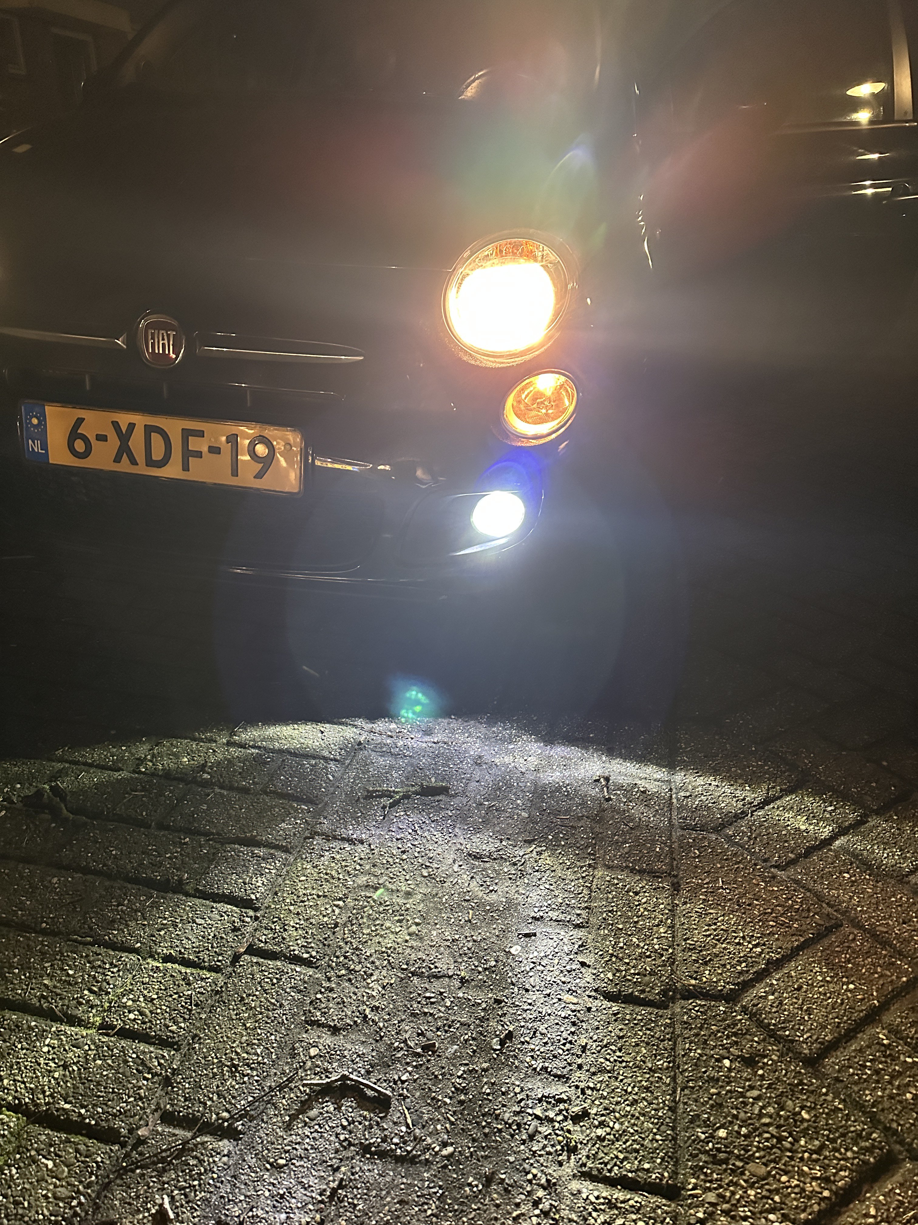

Today i taken off my inner fender lining to replace my foglights for newer style LED, on the left side there is indeed a joint on the cable thats running to the right side, could there be a problem in the joint that leads to the failure of the right fog light?
