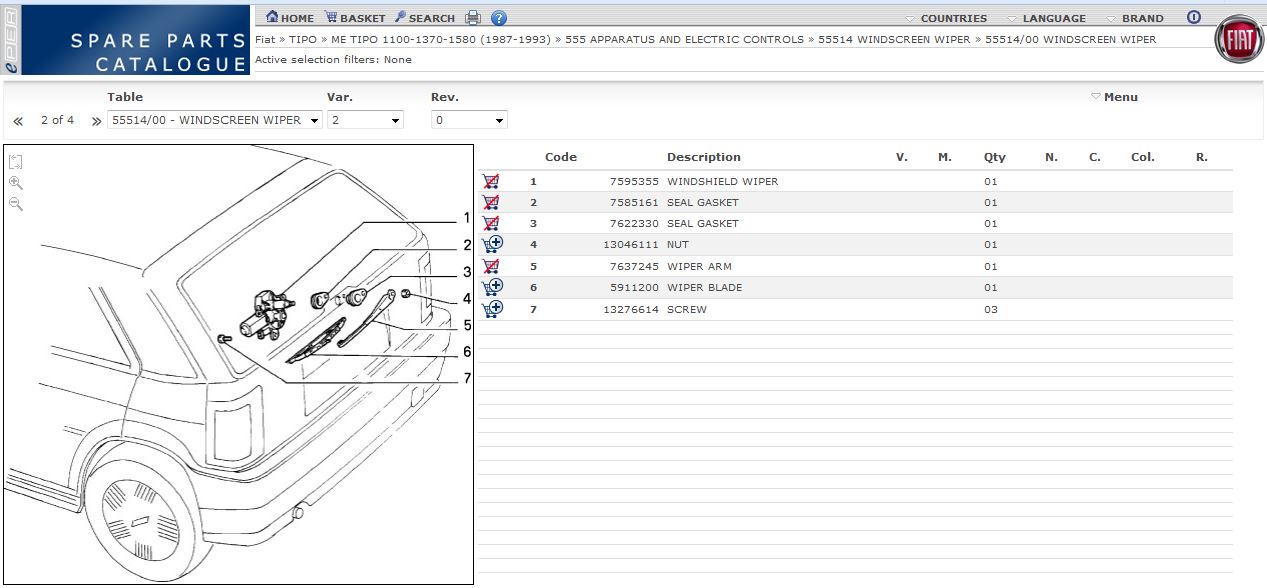

Meanwhile, I'm looking for a rear tailgate wiper motor spindle seal for a Fiat Tipo. It's somewhat egg shaped with two holes, one for the motor spindle, the other for the washer pipe. It doesn't feature in my local Fiat dealer's parts list.
Any help appreciated. (y)
Both the inner and outer seals are shown in the spare parts catalogue, but are no longer available from Fiat. The part number(s) may help your search.
Hi, Davren, and many thanks for the drawing, it must be from an old parts book, the new one doesn't show it.
I'm not sure why I didn't see your post earlier, but the problem was solved with some black screen sealer given to me as a present by my local windscreen guy.
It worked perfectly.
