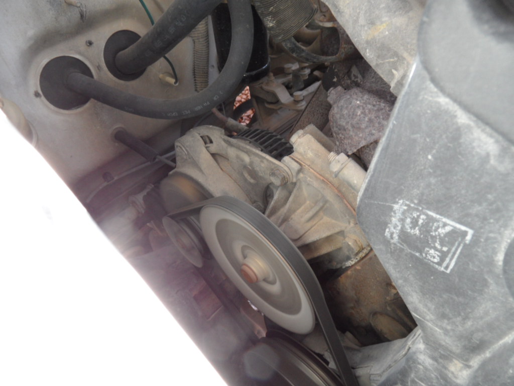

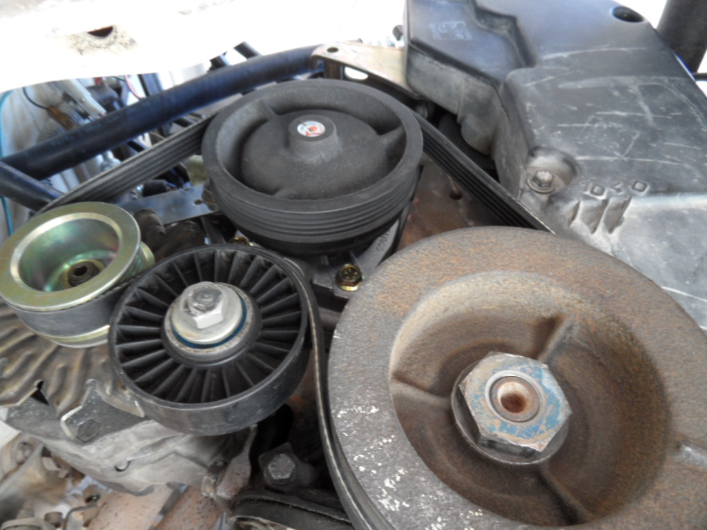

Stage 1 is complete, the changeover from single V belt, to multi ribbed belt.
Sourcing pulleys was the most complicated part, especially the crankshaft and alternator.
Alternator adjuster bracket had to be made, but that was a simple job.
The water pump was impossible to find due to the housing rarity, so bought a pump with an alloy housing and made it fit with the help of an angle grinder and power file.
End result meant a shorter ribbed belt was required.
Before and after pics attached.
