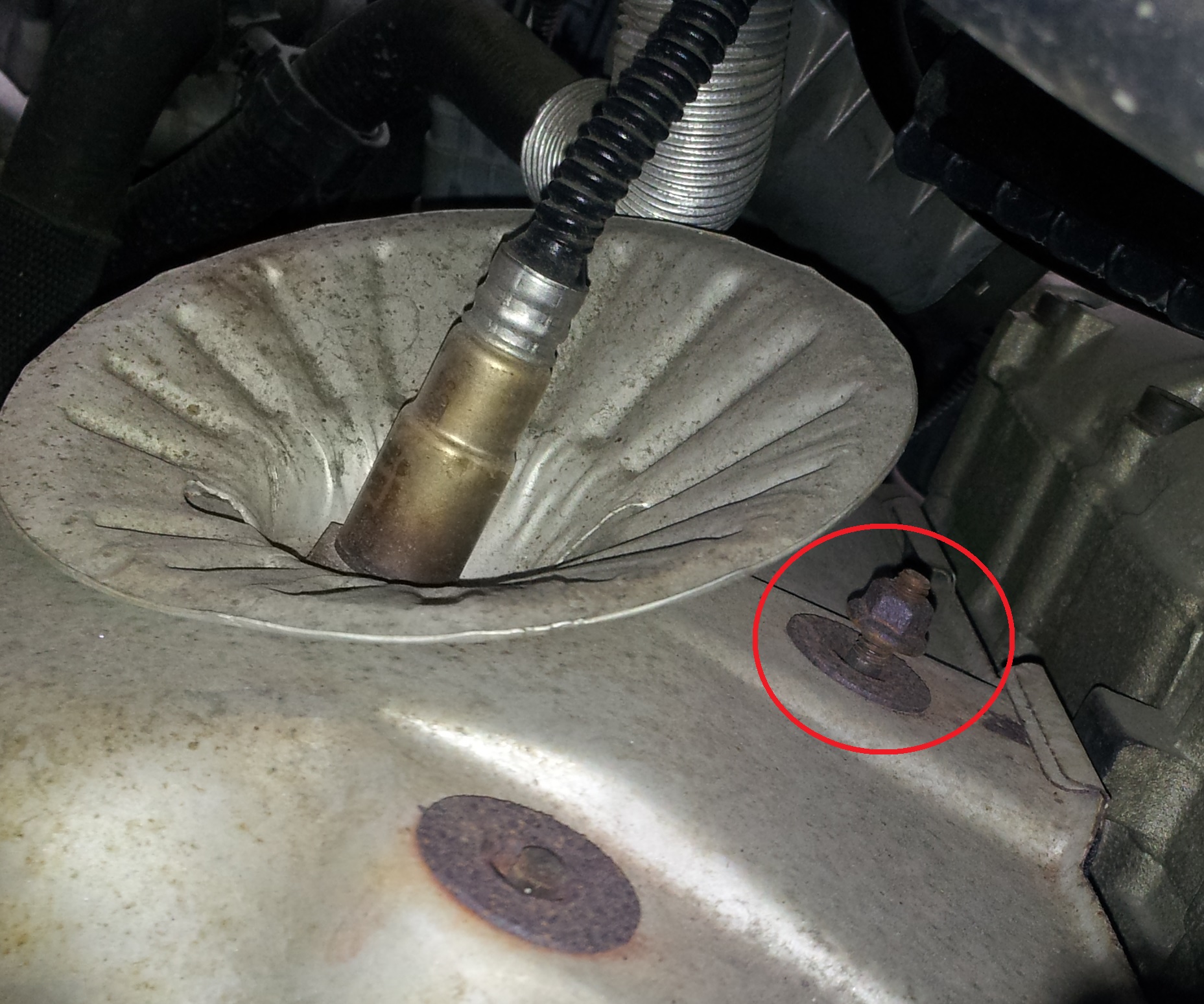

Thanks for the tip. I had a look at what I think is the heat shield, and I found a nut that doesn't seem to be tightened. See the attached picture. Could this be the culprit?
Looks like the other side is snapped off too.
Does the heat shield move if you pull on it? It should be rock solid attached to the manifold!
If it moves even a fraction tighten up the bolts (carefully you don't want to shear any off) then take it for a test drive and report back! :)
I tightened the bolt, but it didn't seem to make a difference. And the shield doesn't seem to move at all when I pull on it. So perhaps the cause of the resonance problem lies elsewhere :(
There are three bolts on the top of the heat shield, does anyone know if there are any bolts further down at the catalyst? Should the heatshield somehow be "mounted" to the catalyst?
The heatshield is in two parts. The bit you see has bolts into the manifold . But there is three that join both of them together further down then two that bolt on to the downpipe on the exhaust. That is a jtd version don't know if your one is similar?
