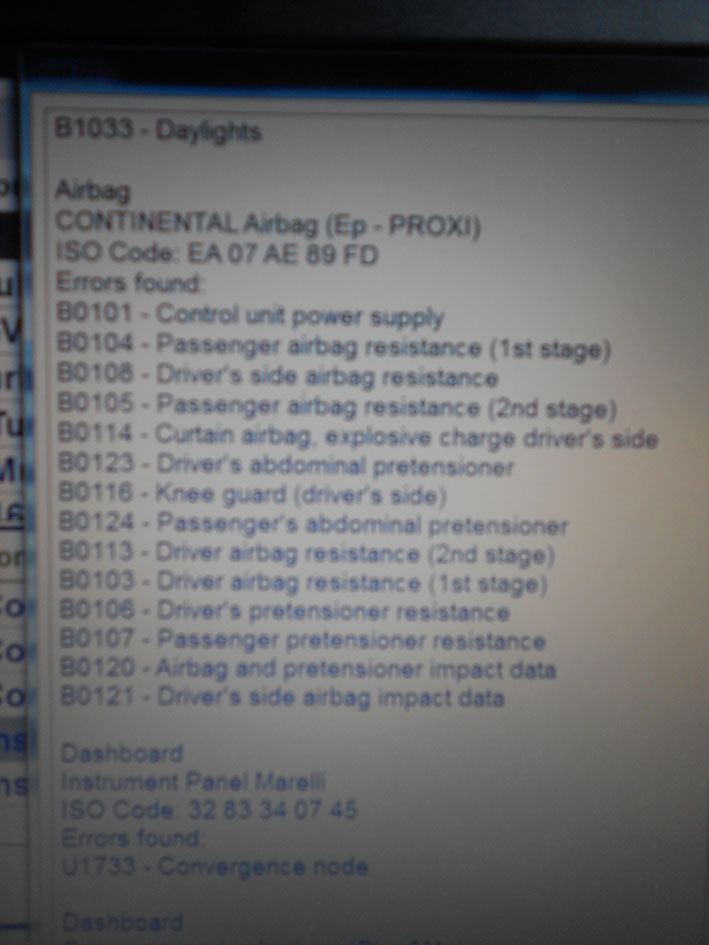

I am having trouble resetting the codes in my Airbag ECU. Initially, it said it couldn't connect to the ECU, but then when I press DTS Scan, it shows all the error codes (picture below) but there's nowhere to be able to reset them. I am using the yellow cable connected as normal to the OBD port. I've looked through every part of the software and there doesn't seem to be anywhere to reset the codes.
I do have a replacement Airbag ECU, but people on here were telling me that MECU would reset it. Has anyone actually done this successfully before?

in Multiecuscan revision 2.7 you connect to the airbag ECU, press F3 or click on the "Errors" button, Then press F10 or click on "Clear Errors" button (bottom left).
I think you may just be clicking the DTC Scan button. Connect instead using F10 or the "Connect" button.

When you select your vehicle in MES there are "system" and "control module" lists. Select "Airbag" in system, "Continential...." in module and then click connect.
Robert G8RPI.
OMG I'm such a pillock. I've just realised after booting up the laptop that under System there was a scroll bar with ABS, Airbag etc. I feel really stupid now. I'm actually running V2.4. I imagine I can update, but will have to pay again?
