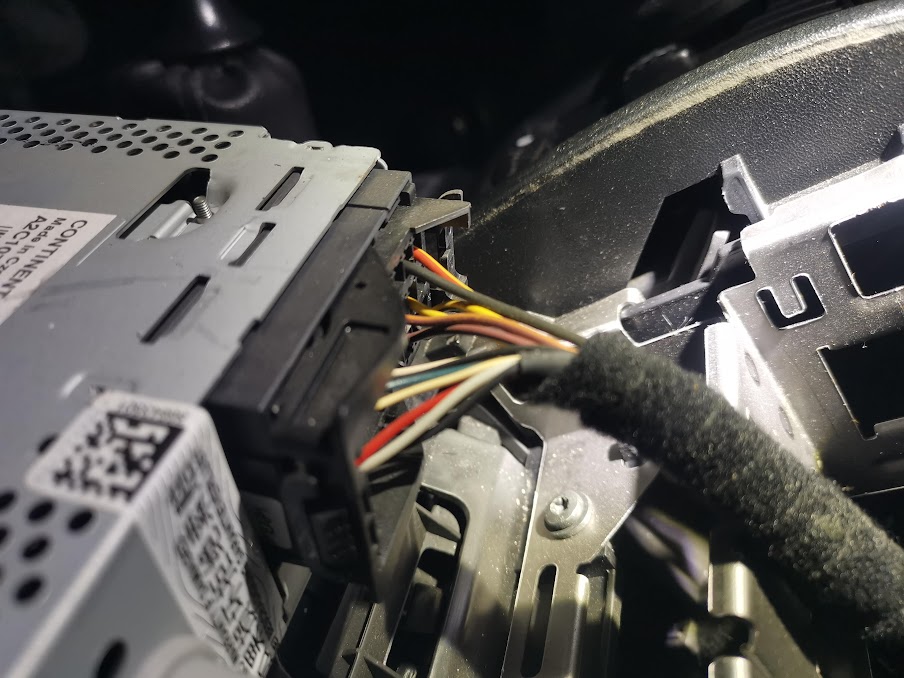

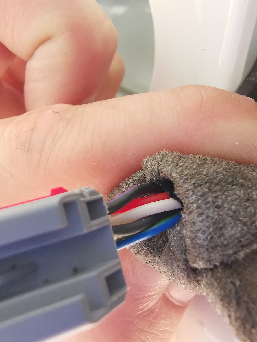

Bought a new reversing camera online, which comes with a VGA/AV cable, how do I connect the new camera to the existing connection shown?
Does anyone know what each of these wires does please? It is 5 cables: blue & green white red black black & purple.

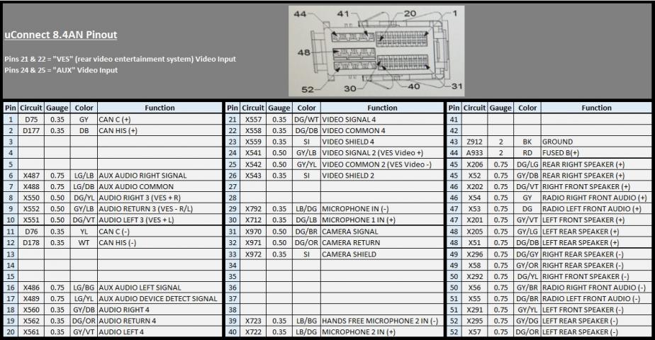

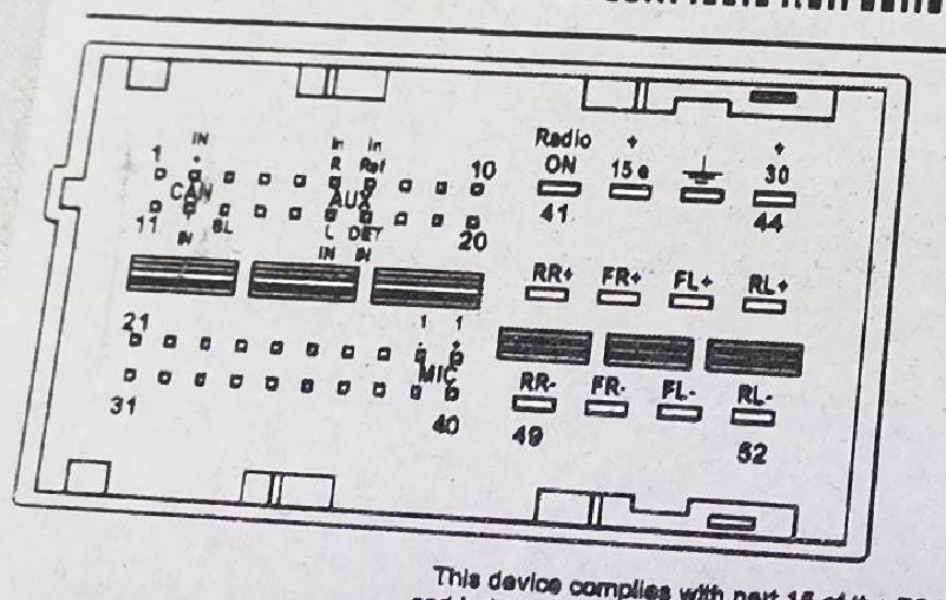

The head unit is a Fiat 250 FL VP2 ECE. There is no slot for the VGA cable there, although I have an image of the labels of the wiring block attached. The old camera was P/N: 53236189 (which seems to be crazy money to replace).
