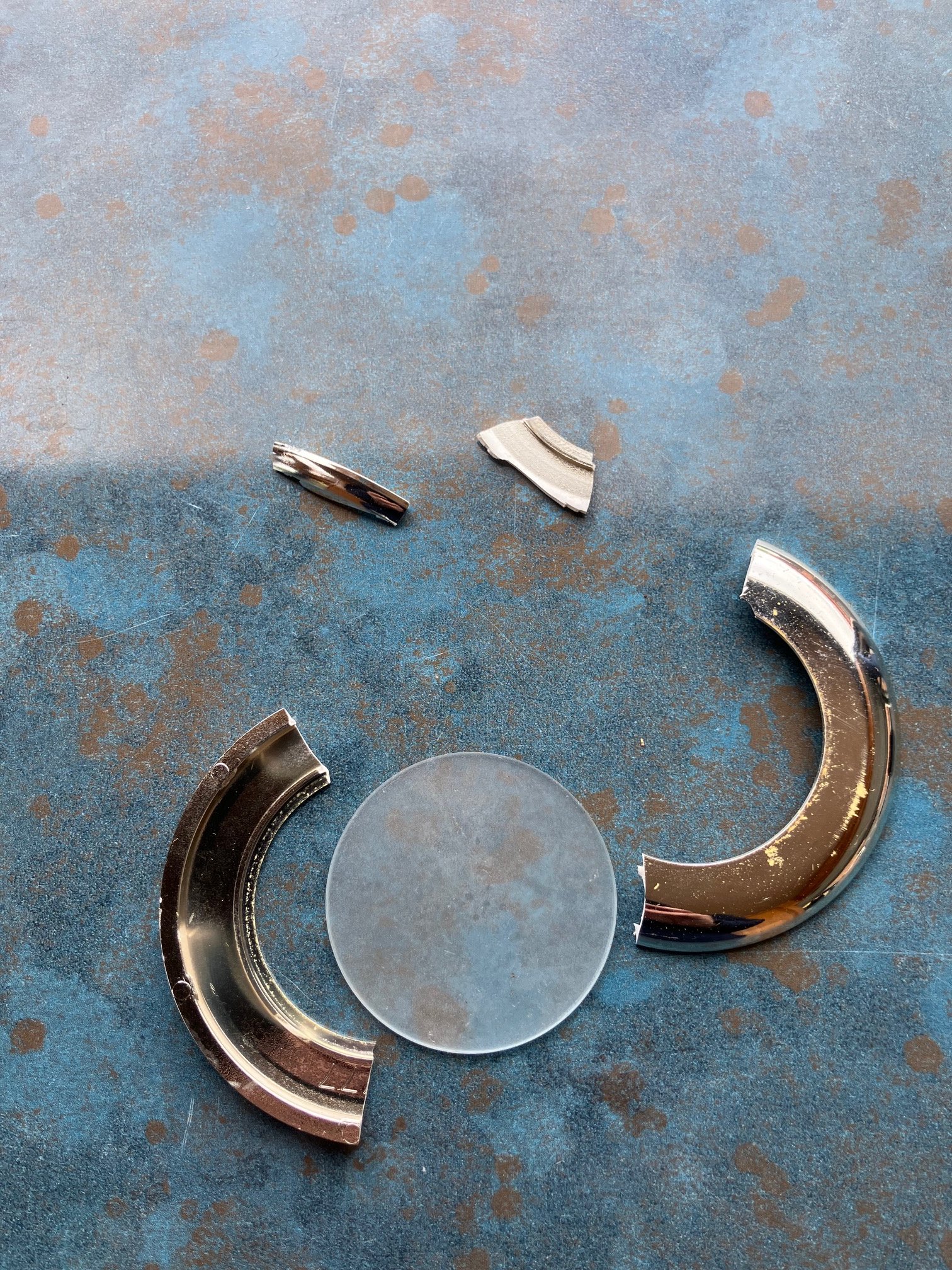

Despite me being very careful, my first attempt to remove the ceiling light surround ended as showing in the photo. They might have become more brittle with age or I could have been unlucky. Have you any idea where I might find replacement surrounds? Otherwise I'm facing with replacing the whole fitting.

If they're that brittle you will probably be better off using new units. The viability of this depends on the current cut-out size and available depth, but it shouldn't be considerably more expensive than sourcing good-quality led bulbs.

I doubt that you will be able to purchase the ring on its own. As Hugh suggeats you may have to replace the complete fitting. The actual brand is "NOVA", and there are some switched examples on Ebay, see here. Another possibility is "O'Learys" near Beverley. They are an acclaimed source of hard to get parts for MHs and similar vehicles.
