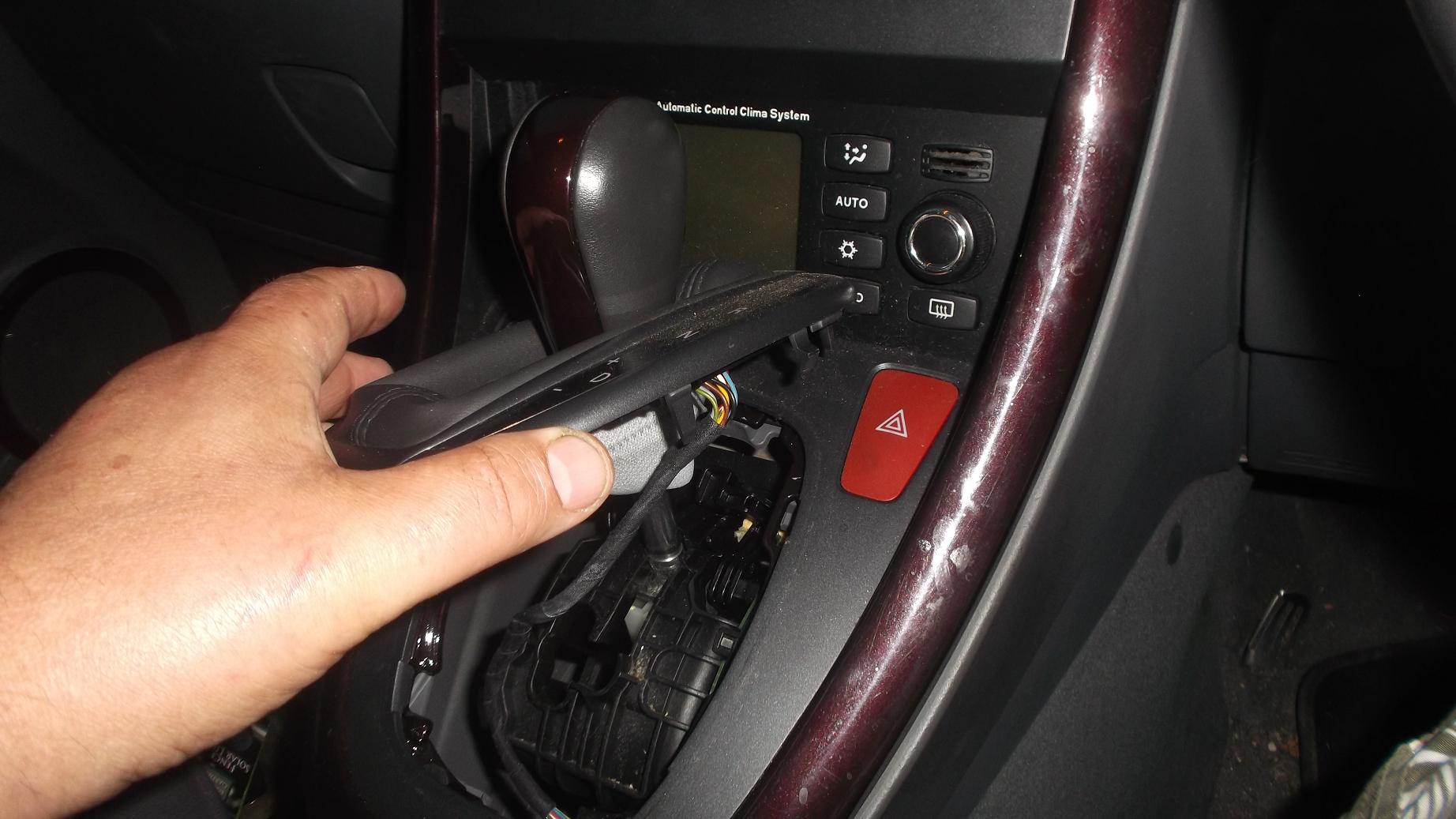

Hello. Please can someone tell me how to replace my hazard switch? I recently got a Croma 1.9 automatic (diesel). The hazaed switch was missing, and I just got one off ebay. How do I fix it in the space? Thanks
Hi,
As far as I remember it pops in upwards - from inside the abyss. You'll need to remove the plastic gators - small and large - from the console and get inside then attach to wiring. Be careful not to drop it though - it can be really difficult to find it again.

this bit pops off

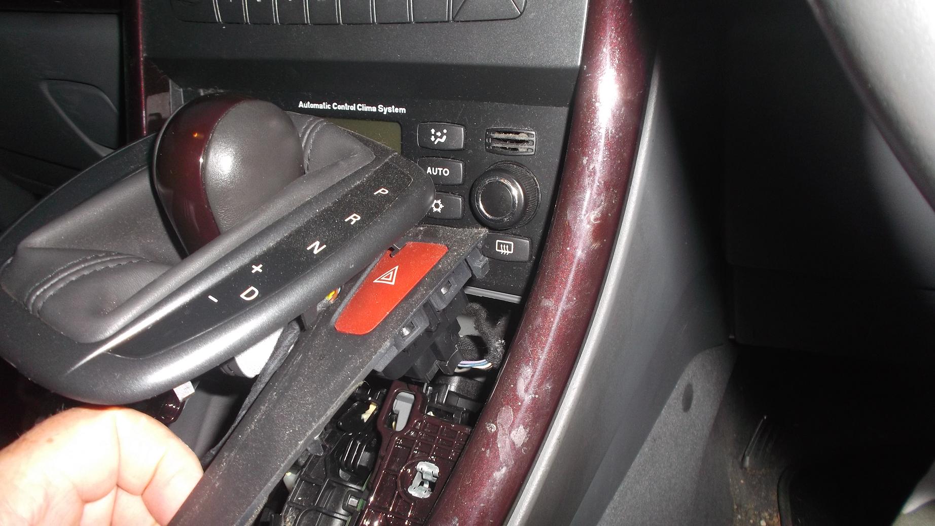

then this bit pops off switch just pops in the bottom, no tools needed just fingers, it takes seconds,
