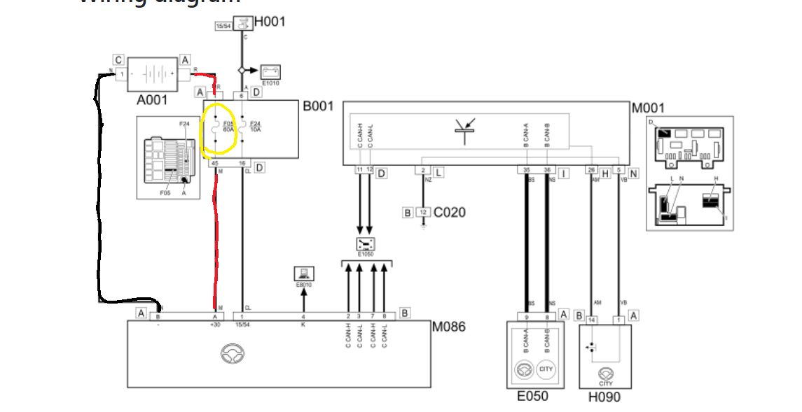

I have yet to come across a poor earth, although its one of the First things I try as its free and quick.
the motor earth is directly on top of the battery negative terminal its not on the chassis leg or gearbox
the logic board earth is a Black box bolted in the footwell Never needed to checked this one yet
