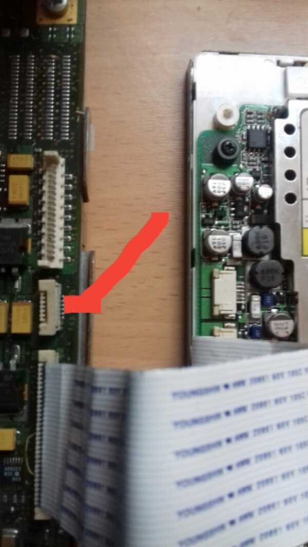

So I had a CD stuck in the navigation CD slot and I have now removed it, problem is now the screen is not working (ribbon cable broke, thin one) is there anywhere I can get a replacement ribbon cable? If not here is my next issue.

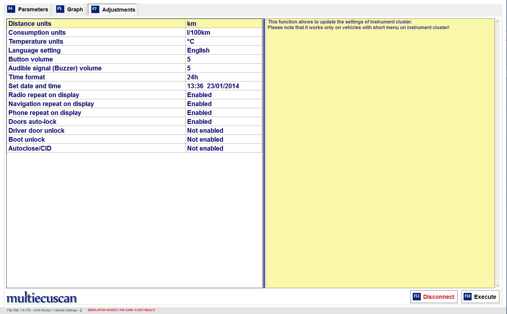

If I decide to replace how would I go about it, its only a small thing but how would I set the clock on my dash? Also I'm not 100% on what all the connections are for into the back of the unit, I know its got phone,sat nav, and also I have already removed the CD changer any help on this issue would be amazing as if I decide to replace I'm thinking of building a tablet into the dash.
You should be able to set the clock on the dash using the dash command (MODE etc) buttons to the right of the steering wheel - this is where the instrument lighting buttons etc are. Check it out and see what happens but I'm sure its there.
Post a picture of the broken ribbon cable and where it fits on the PCBs, I may have a spare one.
For vehicles fitted with the Connect Nav units, the settings can only be done via the CN and are not available in the MODE panel because it will only have the short menu. Yani added a function in MES just for this scenario, that enables you to change the settings.
Alternatively, if you carry out the Proxy Alignment procedure after the CN has been removed, the settings should return to the MODE panel menu.

And thank you for the screen shot I may have to plug in and have a browse with MES it was a life saver when my accumulator went would have cost me a pretty penny without it

Hi sorry for the delay i can't seem to find the cable but here is where it plugs into the pcb highlighted by the red line

So I've managed to sort the screen but now when I press enter for example it keeps reading it as I've pressed map
