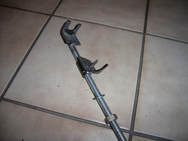

yes, that's correct - the original knob is press-fitted on a splined rod end and can be pushed upward with a special tool - i made one from some metal pieces and a 12mm threaded rod end.
:worship: Very nice Job!

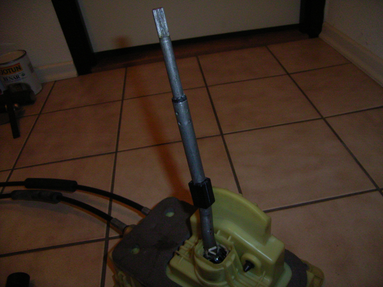

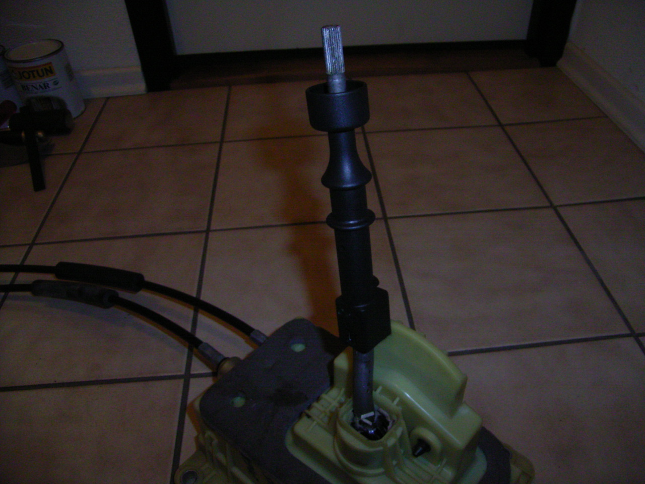

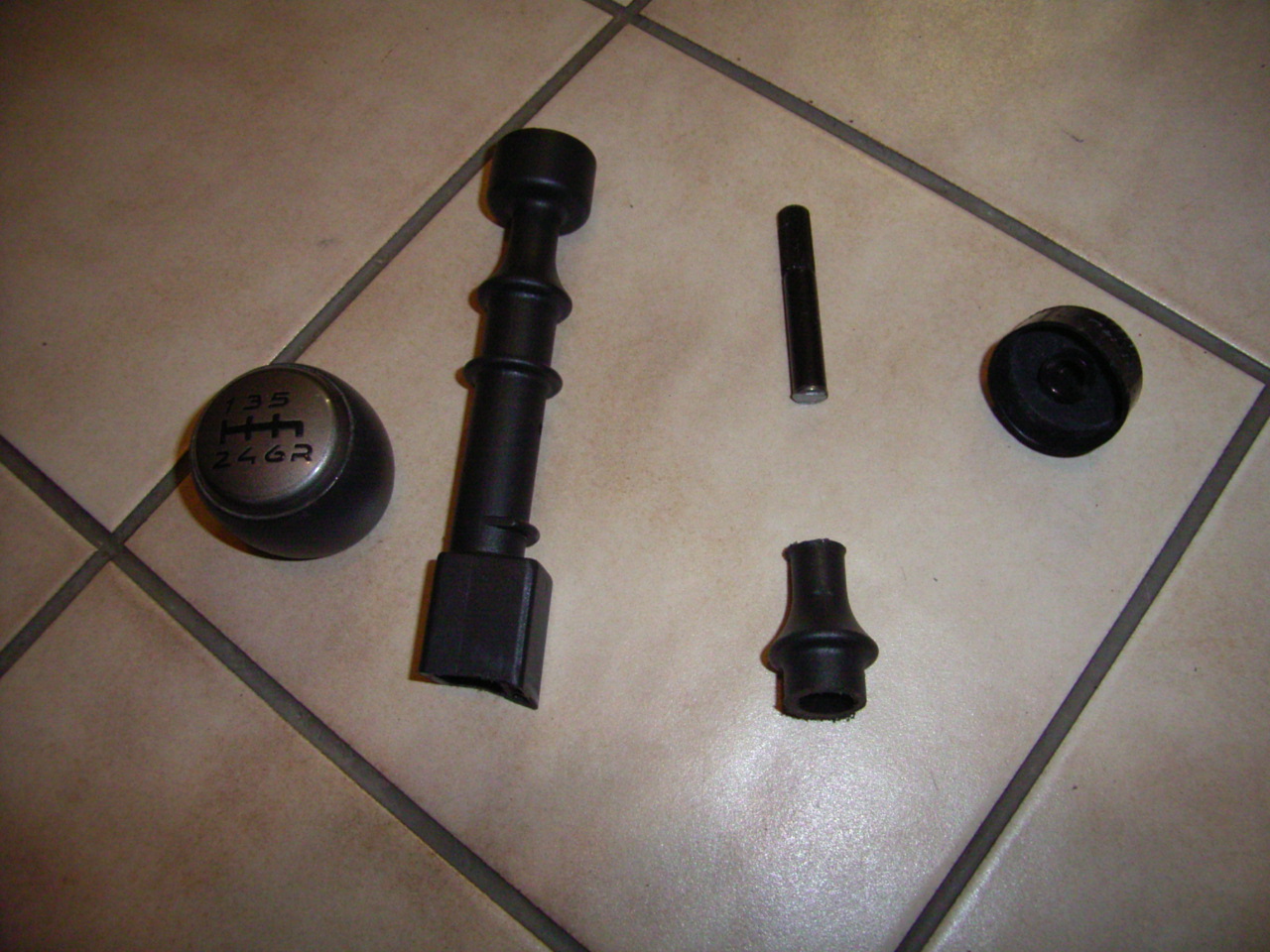

if you don't want to reuse the old knob you could use a hacksaw to remove it, i wanted to reuse it after shortening the lift up mechanism and the shifter rod.
Keep in mind that the knob you bought as a replacement will not allow you to use the lift-up mechanism - you can leave it out but have to take care when shifting gears....

keep in mind the bigger part on top of the plastic lift up mechanism has to disappear in the bottom of the gear knob just like the original - i don't know if that would work with your replacement knob.
