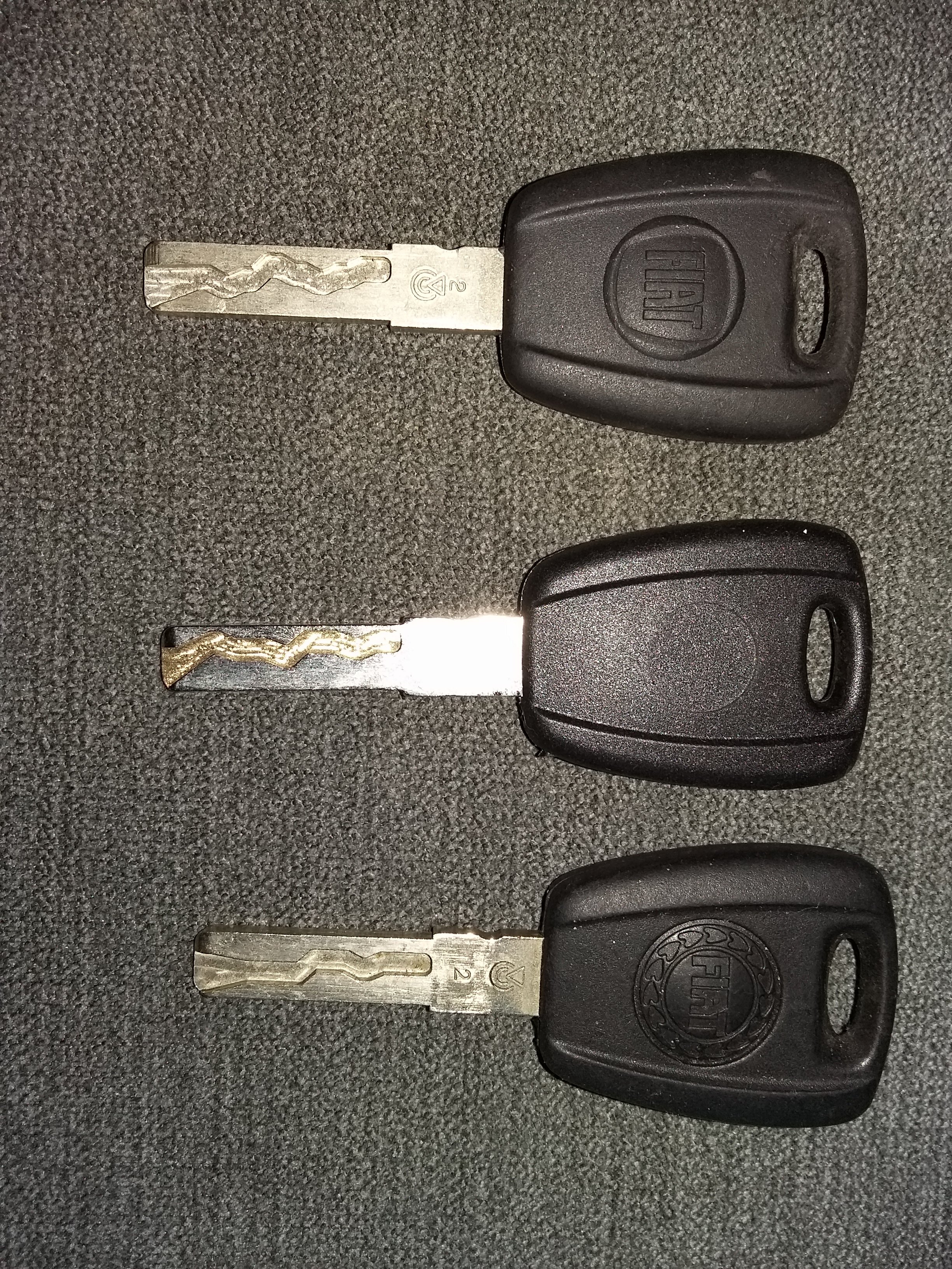

My sons Grande only had a remote key, so my local locksmith built a clone basic key for £40
Factory issue of 2008 and 2012 for reference 🙂
Mmm, very interesting. At £40 per key I will be a buyer. So you're saying the non-remote key doesn't need any electronics? Or many local locksmiths can make a clone with the electronics?
It still has a chip 😉
Code is stored in the ECU, So they access via OBD
ASK Your local Keys and Shoes places 👍
