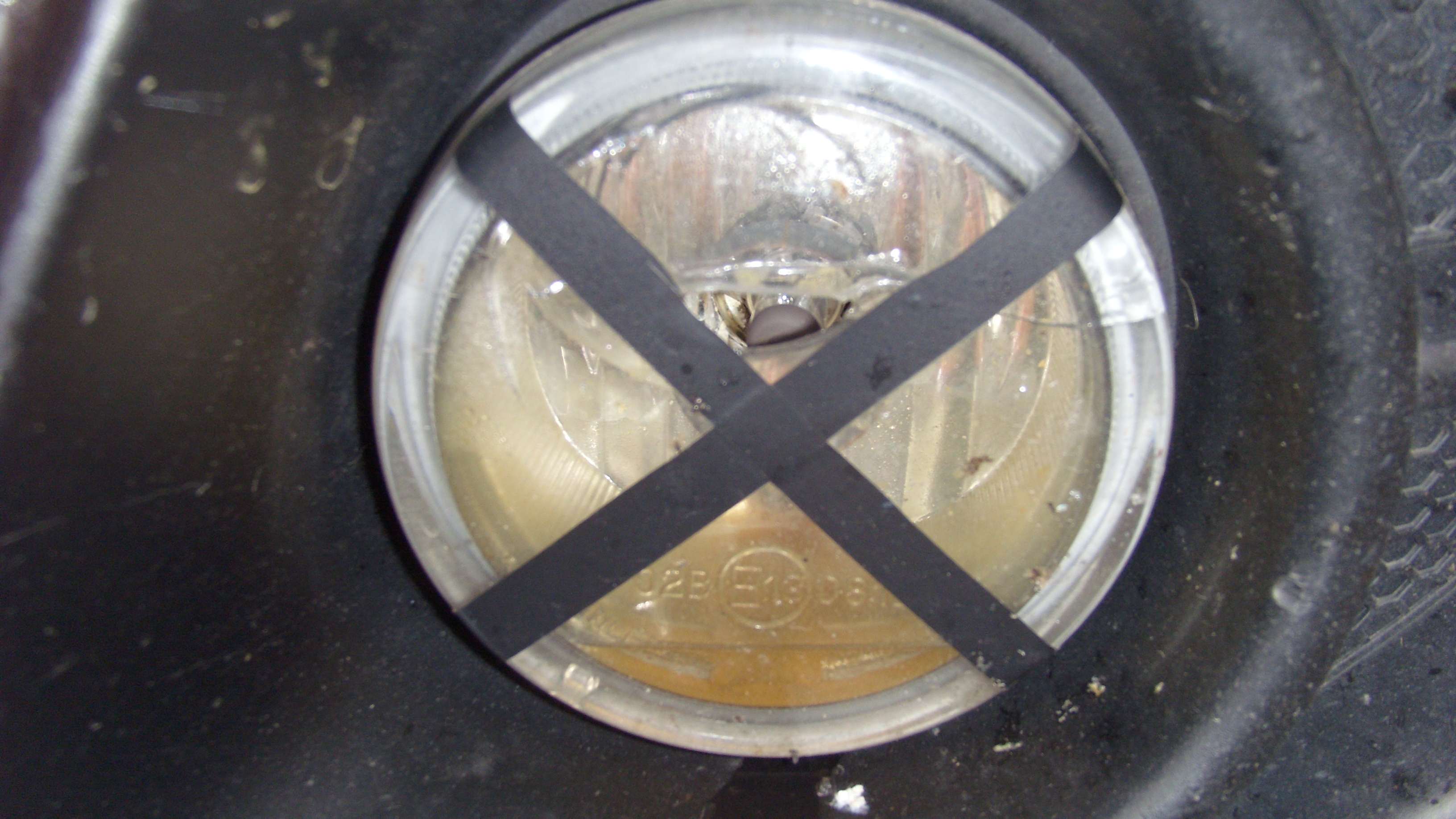

I've managed to crack both fog lights on my Sedici.
One of them must have got smashed during the snow as I did drive through quite a lot of big snow. The other must have been on the motorway.
Anyway, does anyone know where I can get replacement glass for them, and is there an easy way to fit them? I'm not even sure how to get the old ones off yet!
I've taped them up for now but I assume this would be an MOT fail.

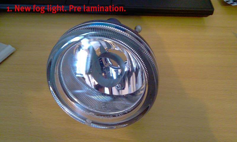

1. To save the new foglight meeting the same fate as the previous I covered it in some clear light protection film (basically laminate) from here http://goo.gl/M8IWe. I went for the thick stuff and it cost £11.98 delivered. Was easy to stick on and will chill me out when i'm following a quarry lorry or gritter!

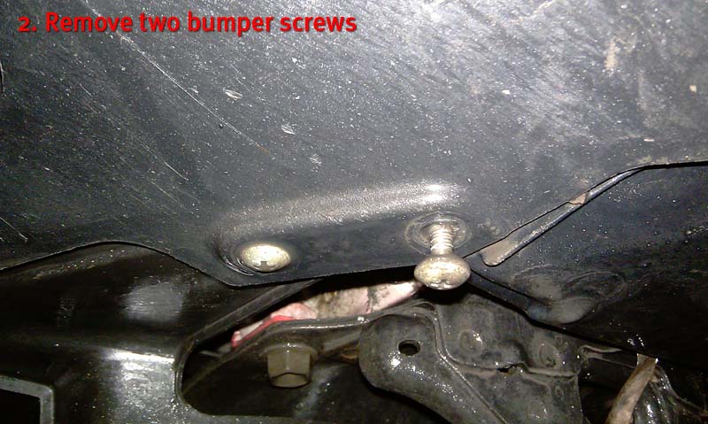

2. With that ready I unscrewed two screws near the nearside wheel arch. They don't quite correlate with the Suzuki bumper but they're in that general area.

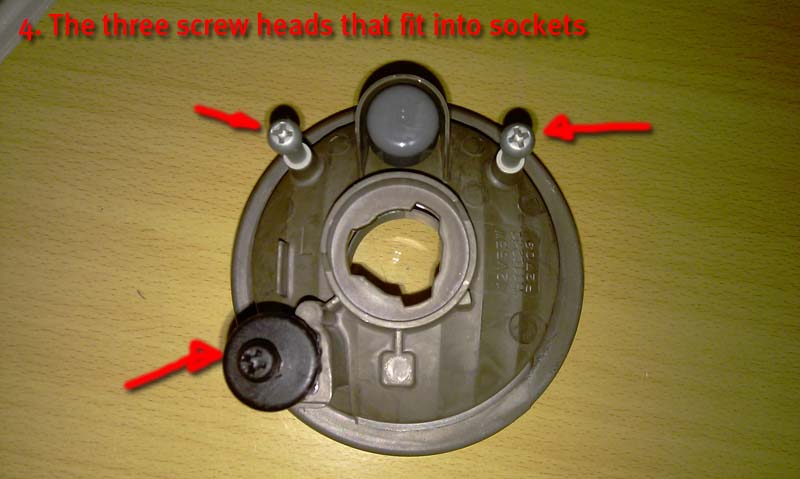

4. Now at this stage I spent half an hour messing around with the light trying to work out how to get it out. There are three screw heads that need to be squeezed out of their socket but they're very tight so this is how I did it... squeeze the top two horizontally with your right hand and try and pull it out with your left hand. The top two are quite easy to dislodge but the bottom one is a sod so I got my hand out and with the back of a hammer and some protection for the plastic, levered the light from the bottom to get the bottom screw to pop out. This should work but go careful! (hammers, glass, face etc)

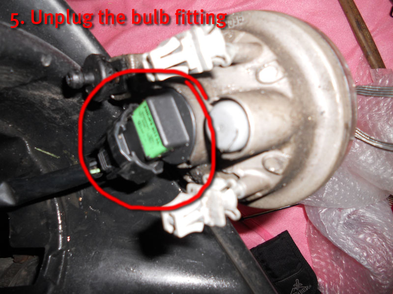

5. Twist the bulb fitting anticlockwise to take the bulb out.

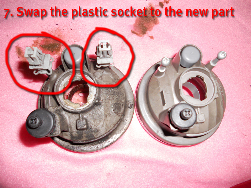

7. Swap the sockets from the old foglight to the new one. Make sure they're lined up the same.

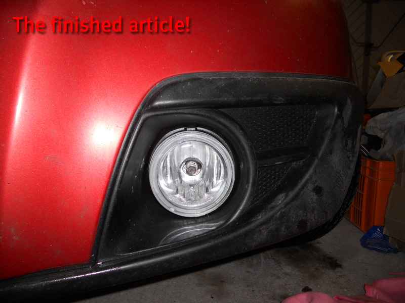

Done!
Total cost: £90.11
Expensive but if you times that by 2, I'm still around £150 better off!
