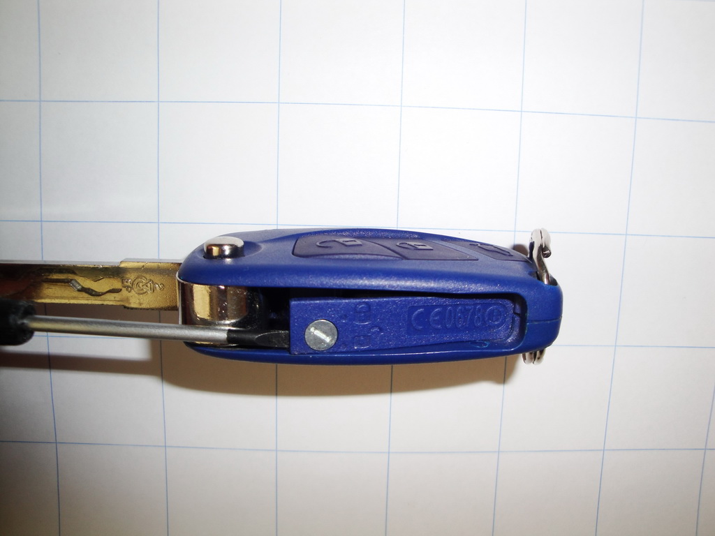

Step 1: Battery removal:
Use a flathead screwdriver to remove the battery and turn the locking bolt to the "unlocked" position. The gently pull out the casing like suggested in the picture below.
