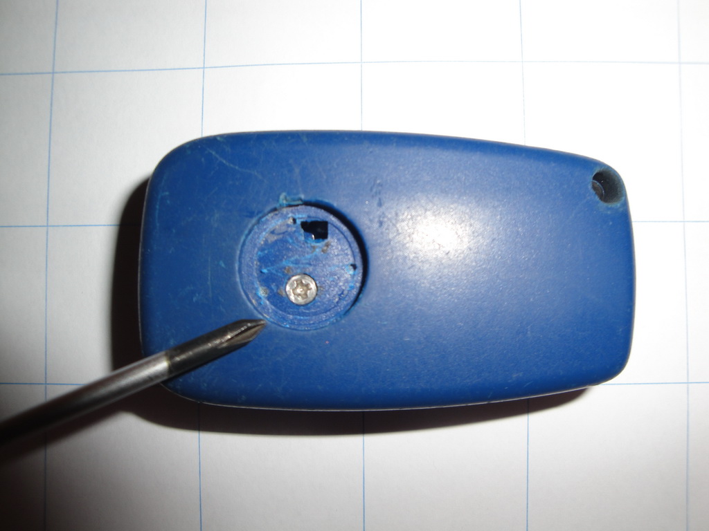

Step 7: Casing repair:
There may be several things wrong with the key. In my case, the knob wouldn't stand upright, but to the right. This is because of wear and tear. The zone you need to fix is located in the picture below:
What I did was to cut the worn part to an even block and then inserted a screw in so everything would stand right. I initially used a solid plastic bar but the job was meticulous and it broke 1 week later.
You may need to take some of the edges off the screw to make it fit. This is the hardest part by far. The length of the screw is about 3 mm. I made the hole in the casing using a heated needle, then gently inserted it while looking at the back end to make sure it doesn't pop out. If you see it trying to but stop in time, no damage is done. Remove the screw, cut it, put it back. After all is complete, put some superglue on the edges of the screw.
The final result:

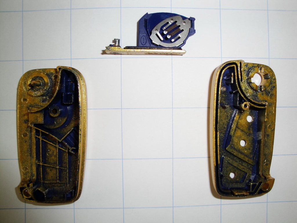

Step 8: Preparing for the paint job:
Put some duck tape where the buttons were. Make sure it is put right, because a lot of layers will cause the part to shrink and cause problems on the assembly.
Apply paint thinner on the plastic covers. This is a very important process, because it acts like a primer. We cannot use primer because we would make the paint too thick and ruin everything. Let the paint thinner dry. Afterward, gently spray the plastic bits.
If you are using metallic paint, you will notice that the job is uneven. No panic. Use more layers. I used 5. In any case to not smudge the paint all over the place. You need several good layers to get it to look good.
The battery cover should be done in the same way, but with less layers of paint. Remember to mask the important parts of it to keep them away from the paint.
Paint spray dries partially in about half an hour. After all the layers, remove the duck tape from where the buttons were. If you see that the paint is uneven, apply another layer with it removed. Afterwards, use cotton buds to wipe out the excess paint. Final results are the following:
