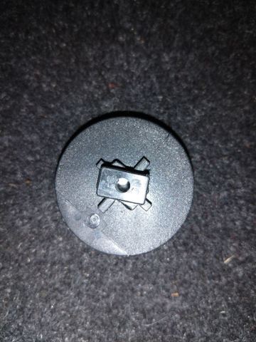

Next carefully position a trim tool (or something else clean and suitably shaped) around the coat hooks in the rear, and gently turn them 1/4 turn so the rectangular mount disengages, and then just pull them out. Not much force involved here, so if you're needing to apply a lot of pressure you're turning them the wrong way, or have turned them too far. The clip design looks like this so you get some idea of how far to turn them:
