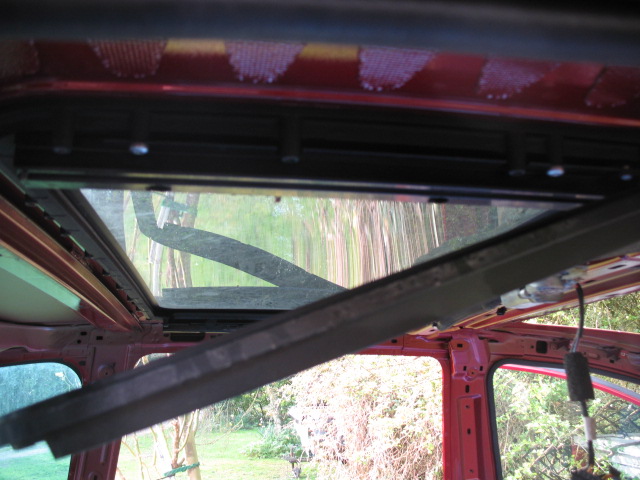

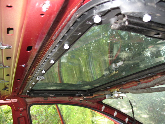

Not having any pics on eLearn I removed all the visible torx bolts to remove the lower cover and can now see all the torx bolts holding the sunroof on. See attached pic

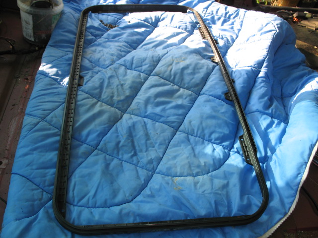

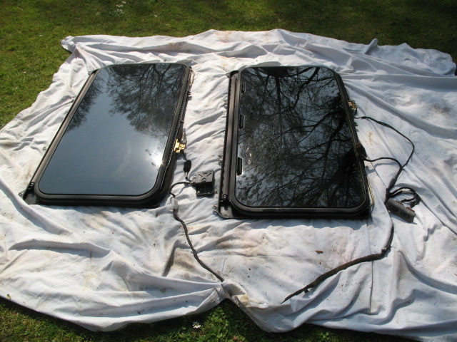

Both out: prior to putting ebay including motors, controls an harness! Here are some pics.
Just 9 screws at rear, 2 on each side and 3 at front: no mastic used or needed. Screws are numbered for order of tightening ala cylinder head bolts!

No sealant anywhere. They don't come out easily but after a few taps with the palm of the hand it starts to come away at the rear and is then it is easy.
