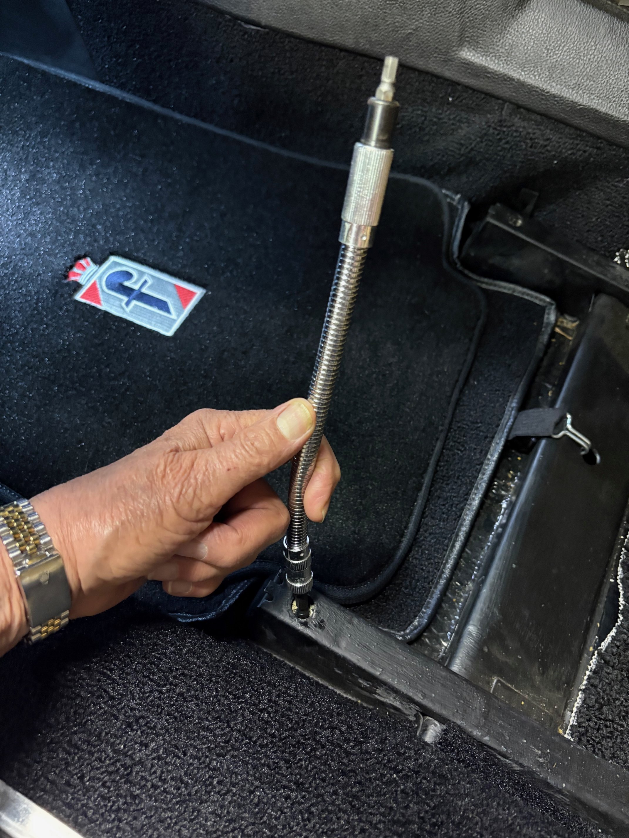

When you put your seats back, I figured out an easier way to get bolts back in. I put an Allen wrench bit (octagonal?) into a flexible drill shaft and it worked like a charm. See attached picture. Good luck if you haven't put the seats back yet.
