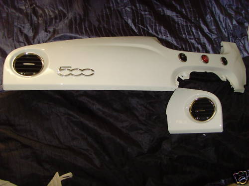

Mark, saw this one on ebay to give some idea as to the screw fittings behind heater.
