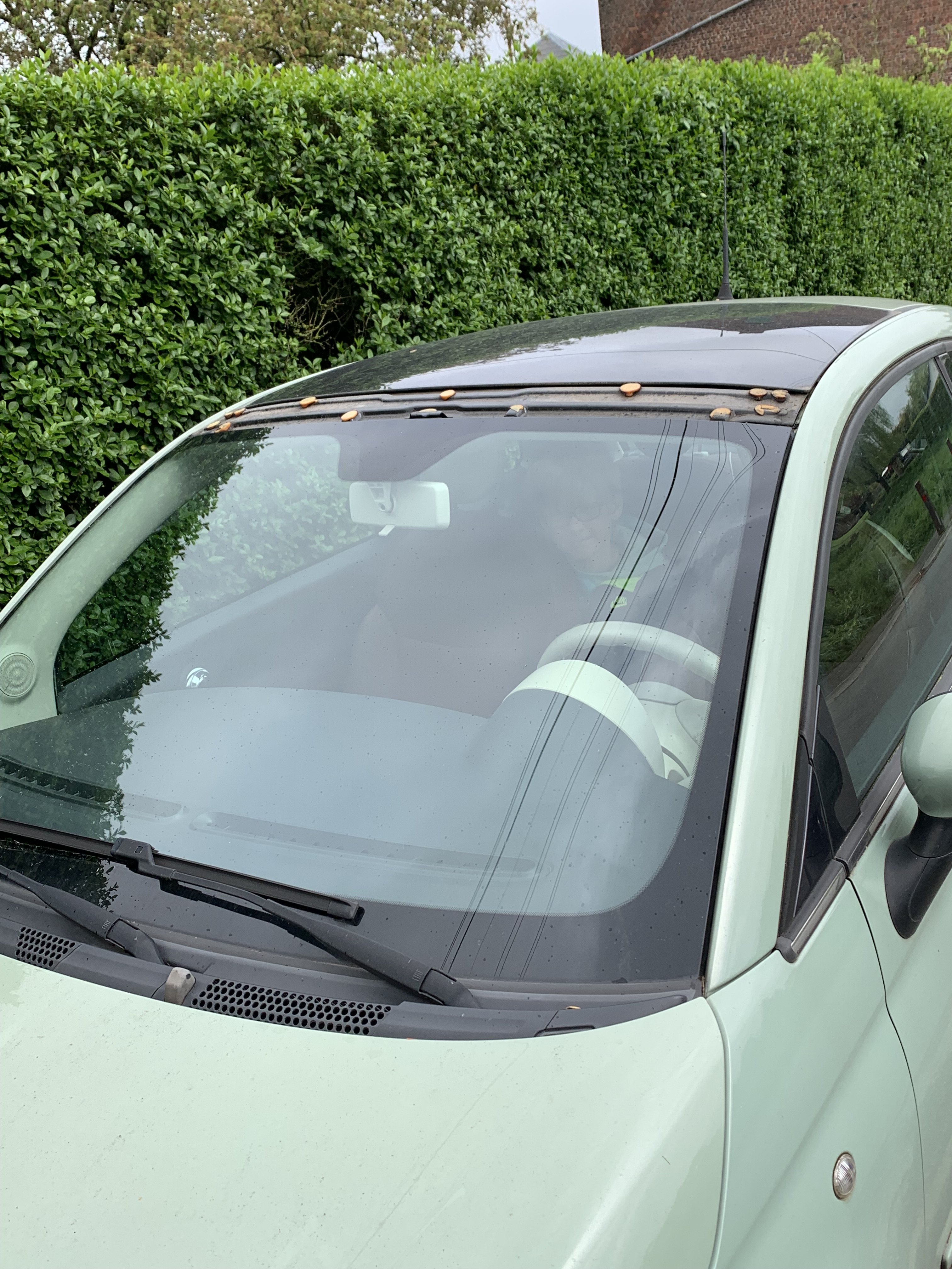

Hello all,
I'm trying to find a panel for a friend's UK 2008 1.4 Lounge and not having much success so far.... The car has a panoramic roof and the small panel that sits between it and the windscreen has blown off (not unheard of I think).
Does anyone know where I might find one please? New or s/h and colour doesn't matter. Failing that, a part number would be handy.
Much appreciate any input.
Hello,
Looks like it's not produced as a separate part by FIAT (or its supplier):
It is one piece with the roof itself :(
However it looks like it is a common issue:
'Strange', FIAT has not launched a service campain on that... Unless from what I could find in eLearn.
So, I'd suggest to check at the dealership, perhaps due to the amount of cases they are somehow able to provide the part. Or, eventually, check the breakers. But I assume it will be a rare and expensive part.
There's a stamp on the windscreen or the panoramic roof glass. Check the producer and try contacting them - perhaps they are able to supply the part.
