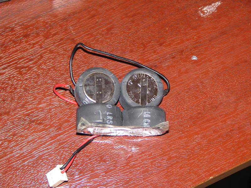

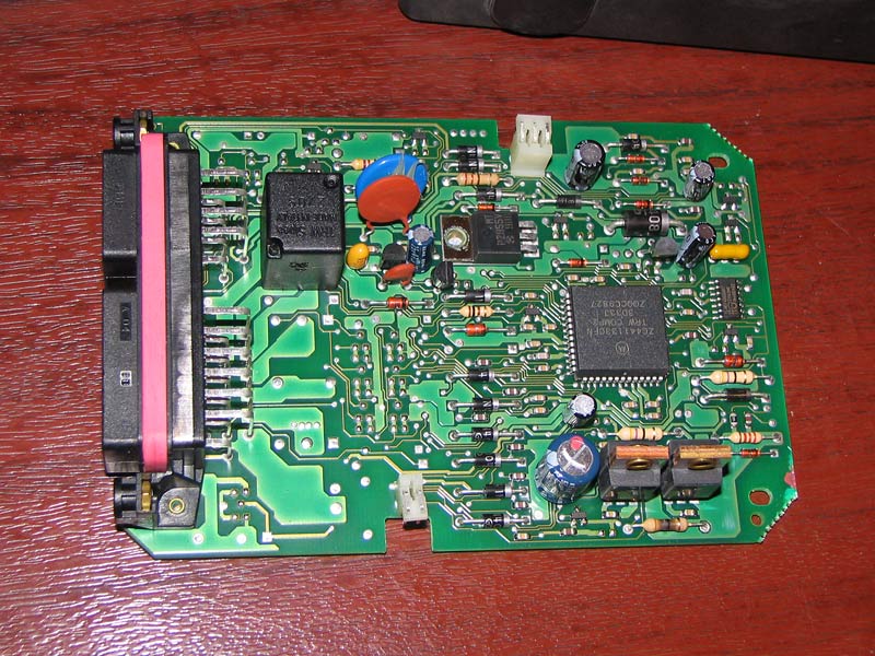

I'll try to repair the alarm by myself. There is rechargeable battery inside the alarm and I am going to change it. I hope this could solve my issue.
Thanks again!(y)
Here is what is inside the alarm TRW Sipea which my car is equiped with.
I noticed a faulty resistor that may need to be changed along with a new set of batteries because they must be 12V but these in my cars are only 8.5V which means they are not working at all.
If you are curious what is happening here, let me know and I'll keep you guys posted.
