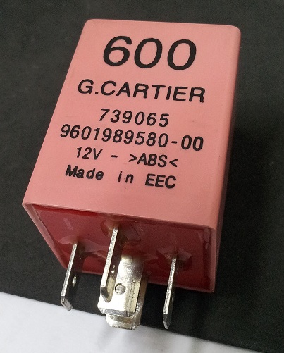

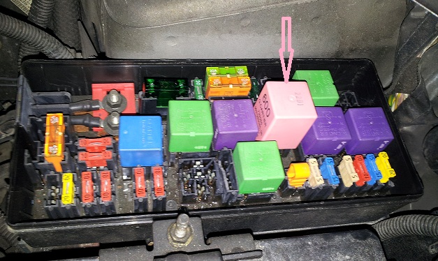

Hi All,
I'm new to this forum. I'm trying to replace a relay in the fuse box but can't find the exact spec for it. It says 12V ->ABS<. What Amps shall I use? Please advice.. Tq
I think this relay controls the heated rear windscreen so is probably rated around 25A-30A. The Valeo 02446 relay is an equivalent to the G. Cartier 739065 relay.
