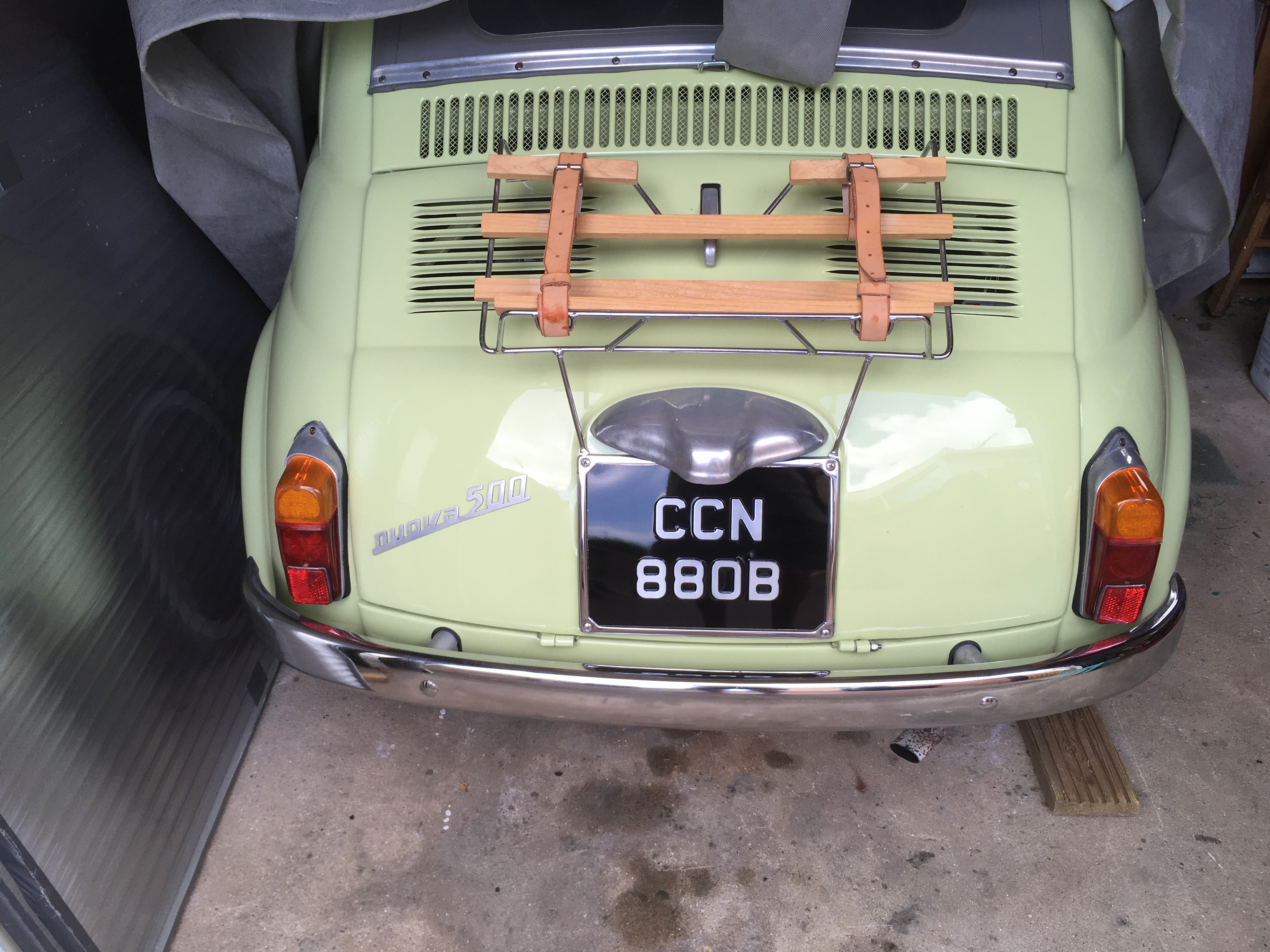

All done now! I got my plates from Polar Automotive in Tonbridge, Kent. Very happy with their service - 10 days from order to delivery. Recommend them (y)
Unfortunately, due to a seven digit registration, I am not able to use the stainless steel surround on the front plate but never the less I am super pleased with the look and that I got through the process at last :D
