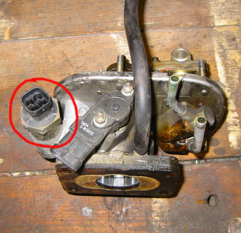

The idle speed was fixed by adjusting the throttle cable (more slack) and mounting a different idle control valve. The idle is now fairly allright, just below 1000 rpm. If you have problems finding a replacement idle control valve, try to clean the one you have. Don't try to remove the small "rod" (you will see when you have removed it), as you will probably only ruin it. That's what I did with mine. Instead just clean it and possibly spray some WD40 on the moving part.
