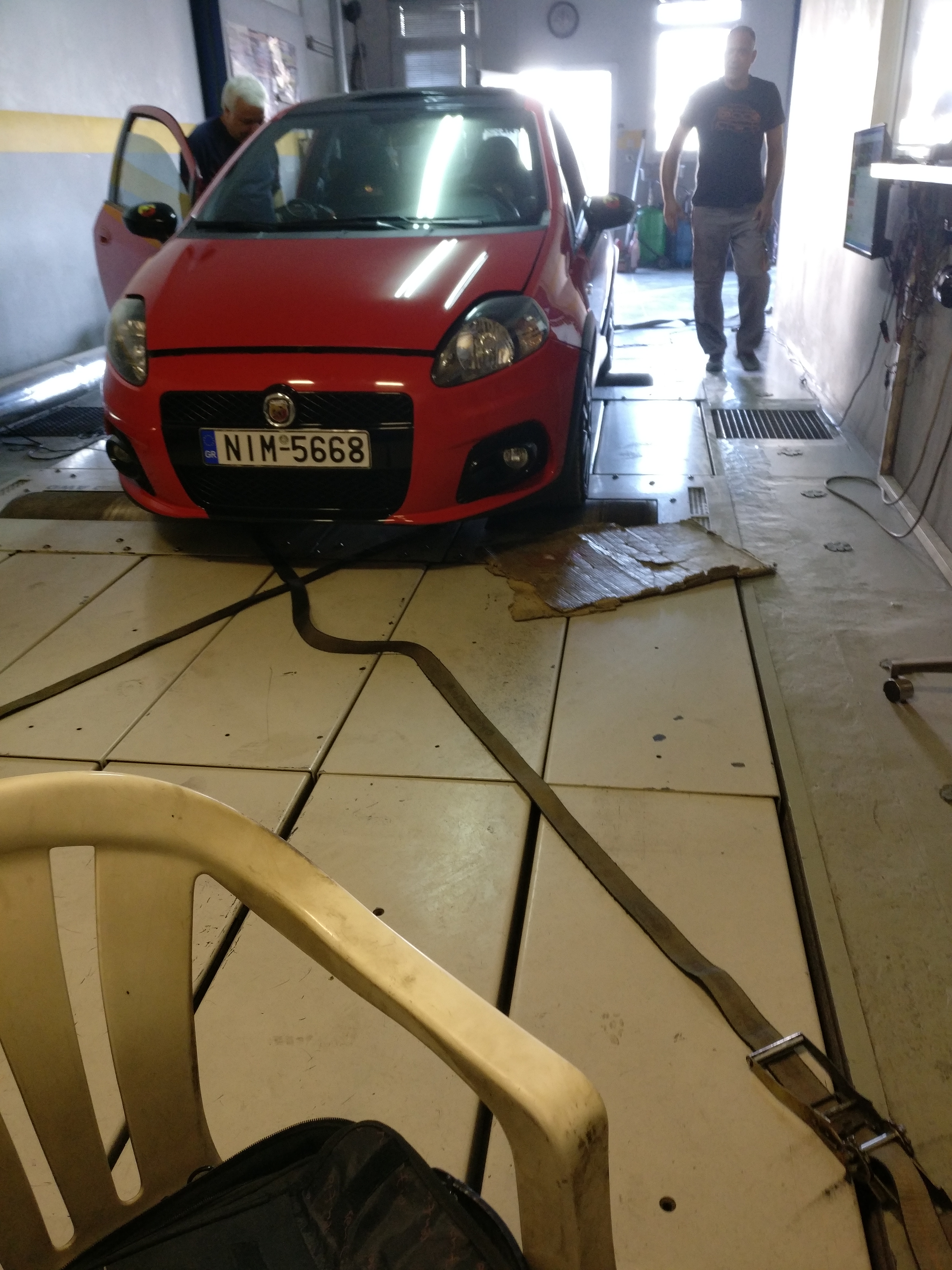

This is my car. My first setup was in 2009

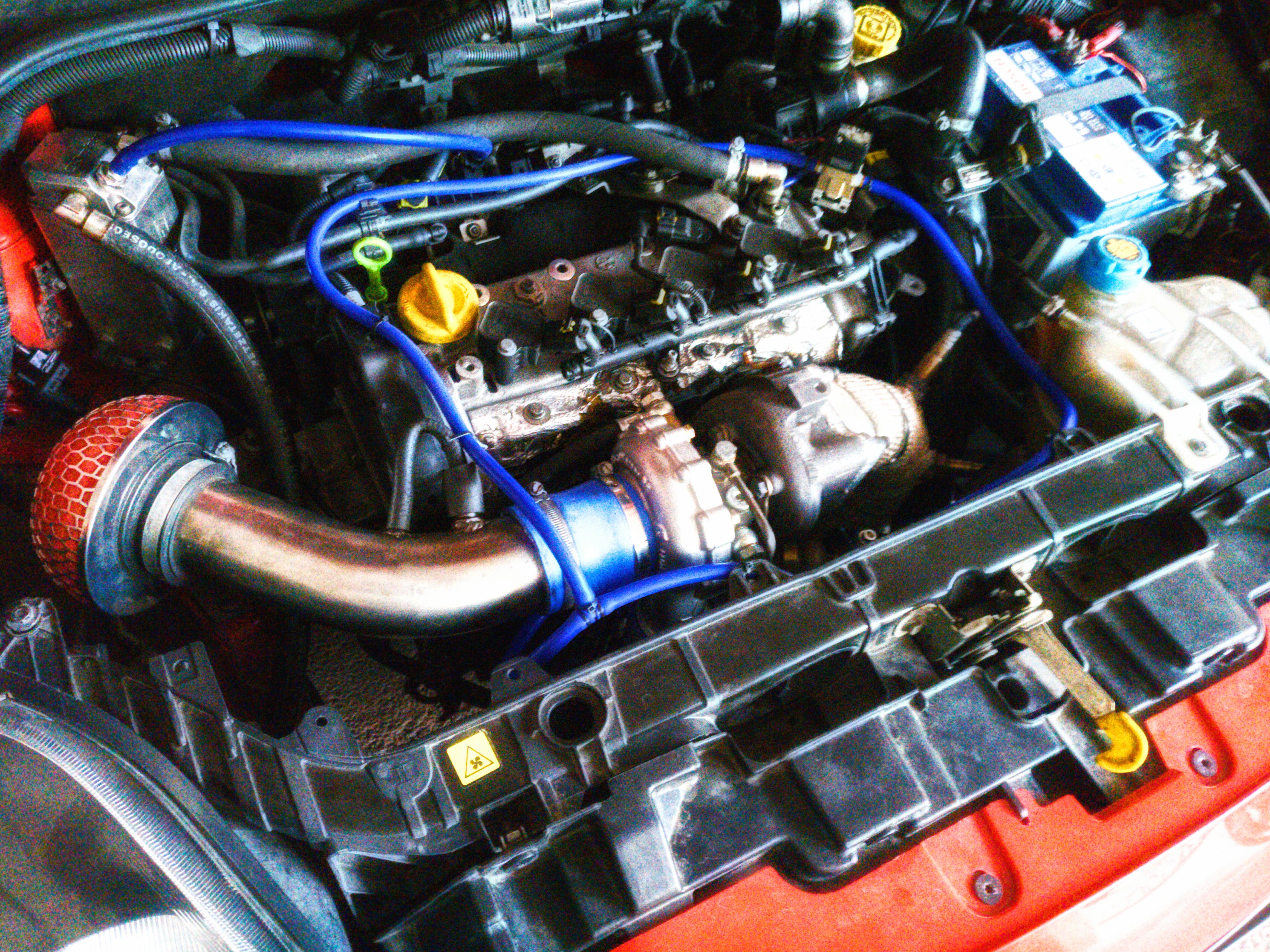

Exhaust 63.5mm downpipe, 60mm catback
Air KN air filter
Fuel injectors 380cc
9.2:1 compression
Garrett gt2056
Custom intercooler
Ecu remap
Stock internals
245hp full boost 3300rpm

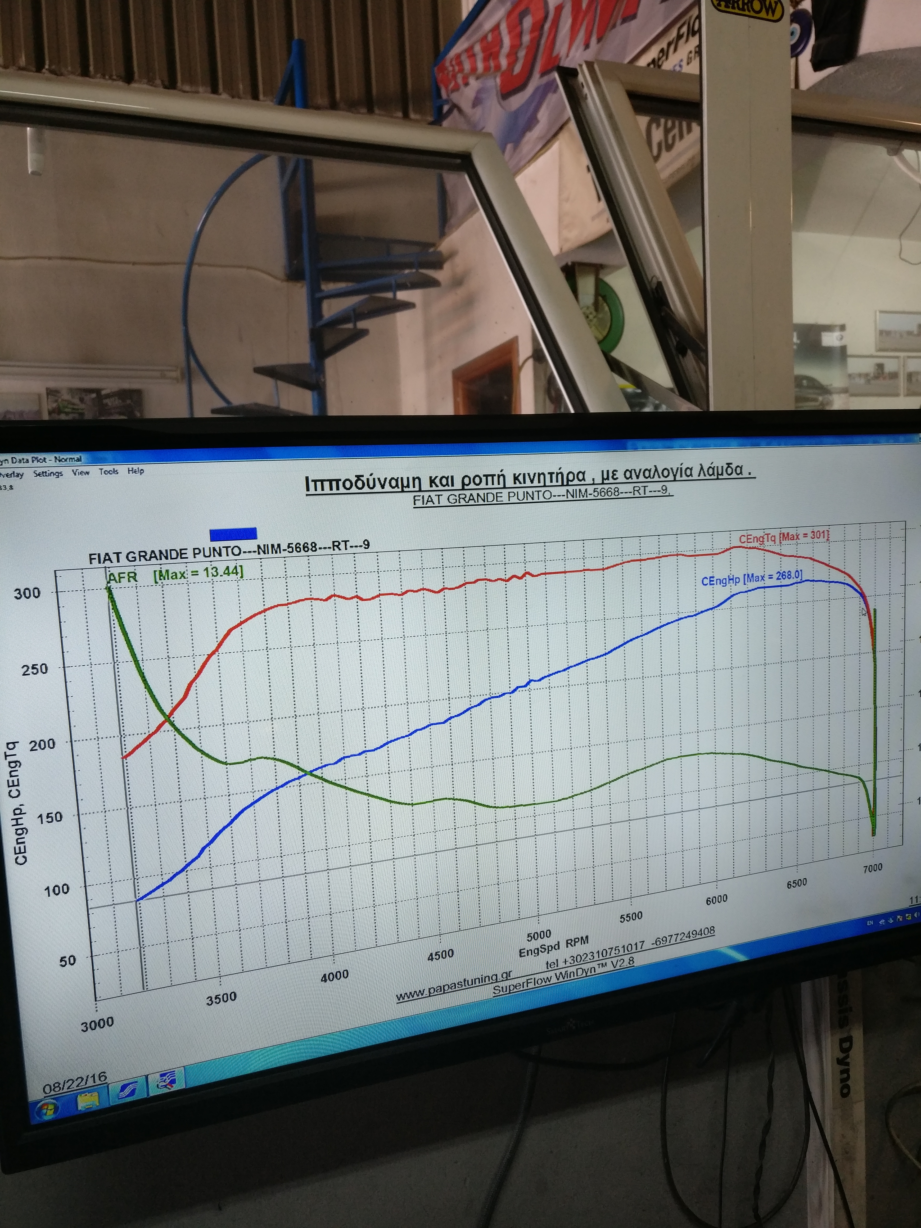

Now the car got 270 whp at 1.3bar full boost 3800rpm

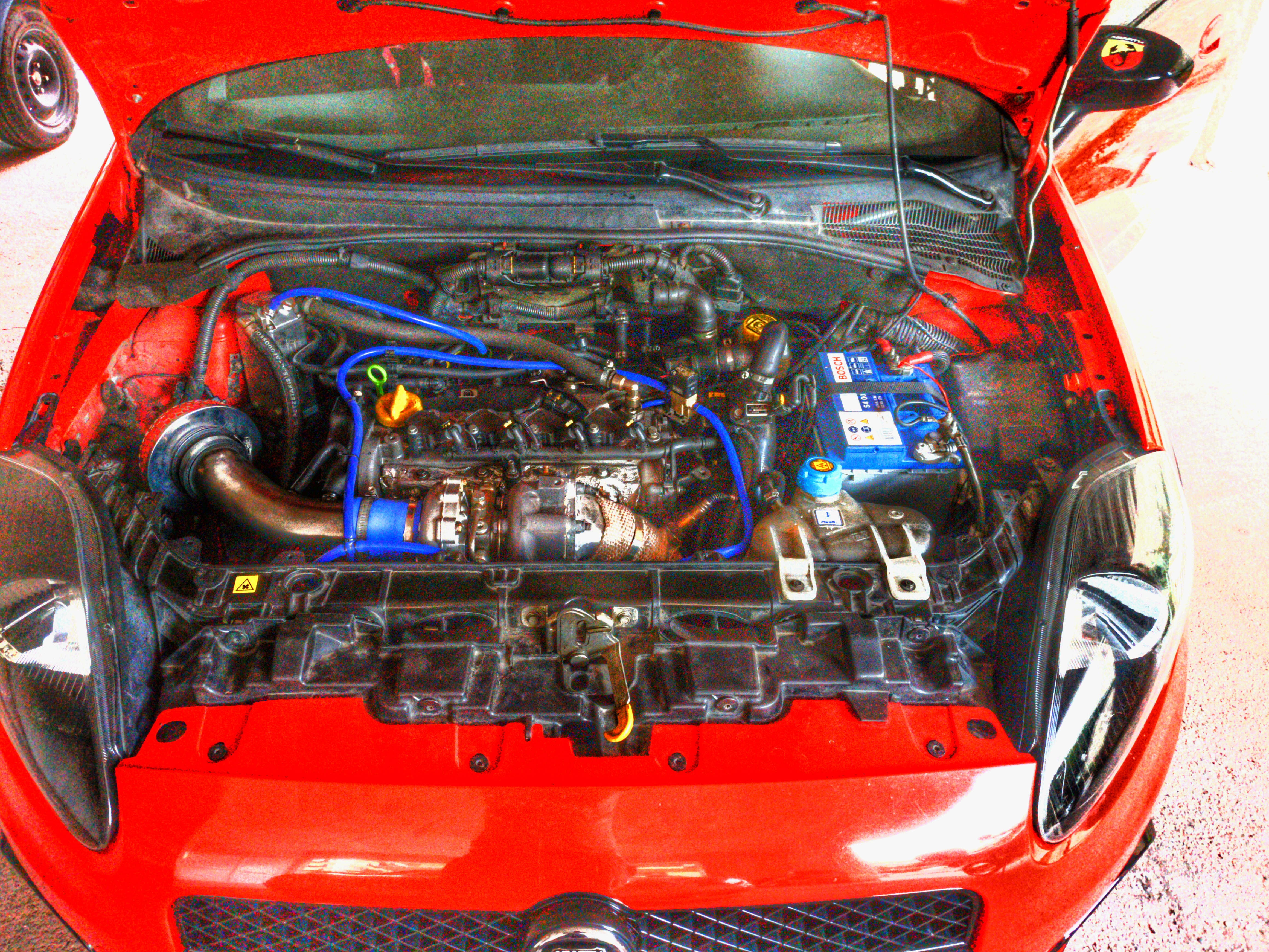

Borgwarner custom turbo
Fully 70mm exhaust
Fuel injectors 440cc
Fuel pumb walbro 255L/H
Custom intercooler
Cp pistons
Veltiosis forged rods
Bigger camshafts
Compression 9.5:1
Arp head bolts 10mm
Bigger valve springs
Ecu remap
Custom exhaust manifold with external wastegate tial 38mm.
