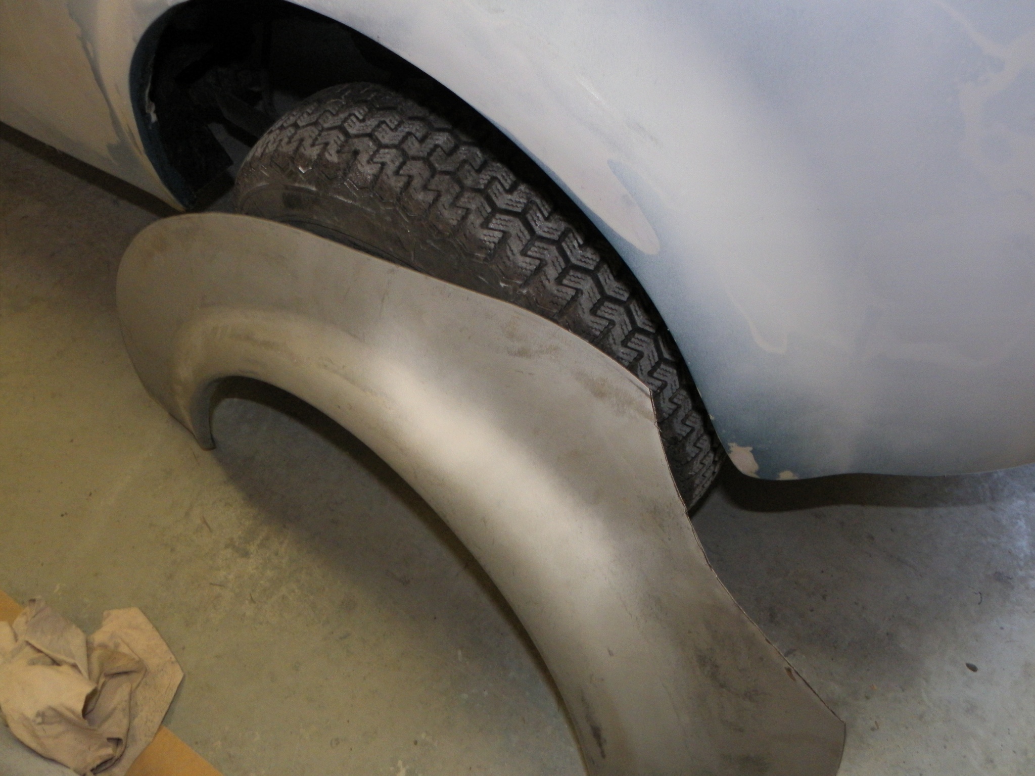

It's a lots easier just to use a repair panel rather than replace the whole rear wing. Mine had a similar problem and I got a repair panel and let the body shop do the business. Any decent body shop should know what to do.
A few pictures below of before and after.

It's always been my preferred way too, and you needn't even use the entire repair panel as it can be trimmed down to let you keep the maximum amount of the original.
The problem you encounter is that it takes greater skill and possibly the same amount of time to renovate like that. That approach can cause distortion and introduce the potential for corrosion where porous welds and places inaccessible at the rear are unable to be accessed for rust preventative painting. You will usually need to do more pre-paint preparation afterwards too.
I have noticed a trend for whole-panel replacement on restorations on this Forum and elsewhere and I understand why, but I still feel it's good to keep the integrity of the shell wherever possible.
I'm a firm believer of fit a new one if its available.
gets rid of all that hidden rust that tends to pop up about a year after carrying out local repairs.

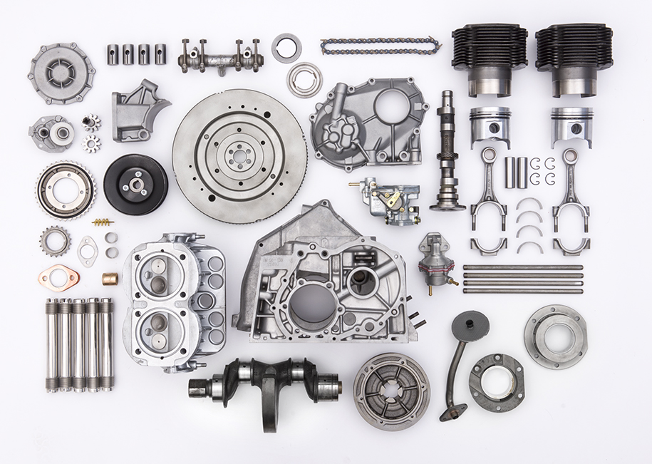

I have taken your advice and a given the welder a pair of wings so fingers crossed, meanwhile here are some before and after pics of my engine refurb (if Ive uploaded them ok)
