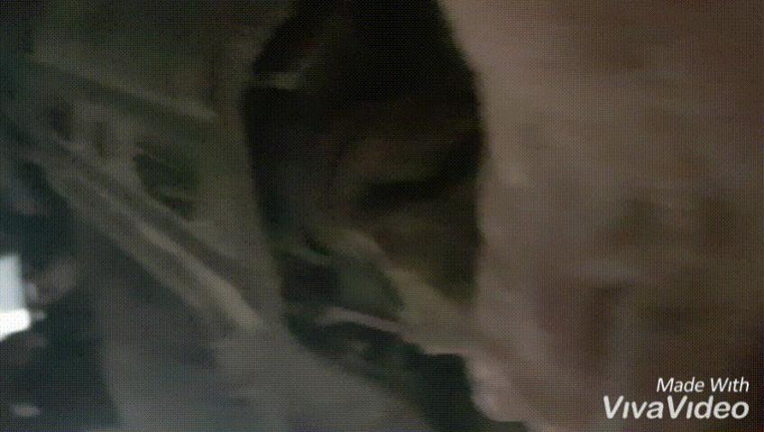

Would this be the issue? Also can I still get parts to fix this?

i am not sure, it looks like the centre mount for the prop? if it moves in any way other than turning.. it may be the cause of the noise.
if the rubber has come away i recommend Tiger seal.. its all thats holding my one together for the past 2 years. never came away yet and ive had it under some stress!
